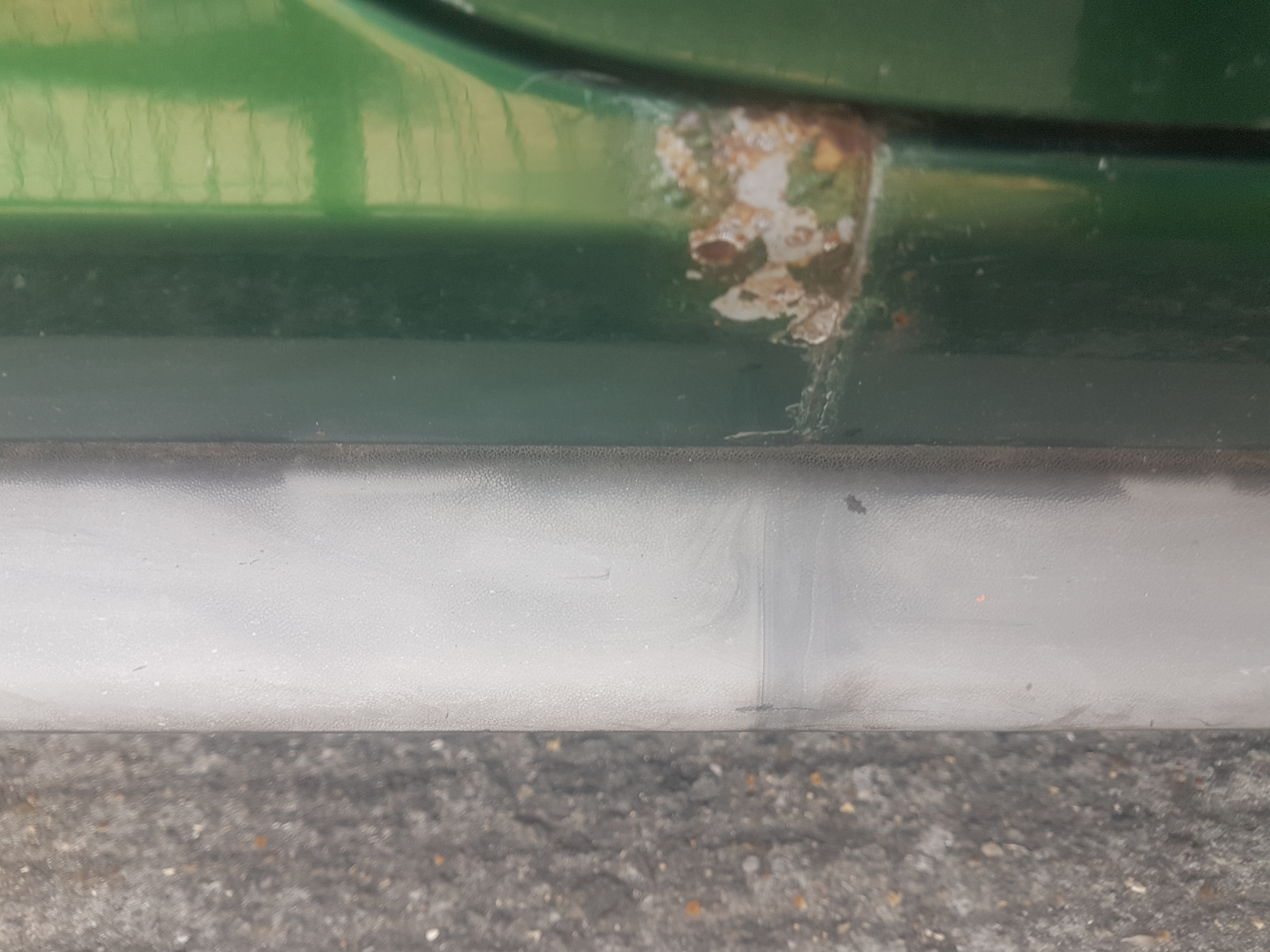

happy days.the hole car was solid to fare the major issues were lacquer peal down the passenger side surface rust on the sills front wing and rear archers but nothing too bad to save

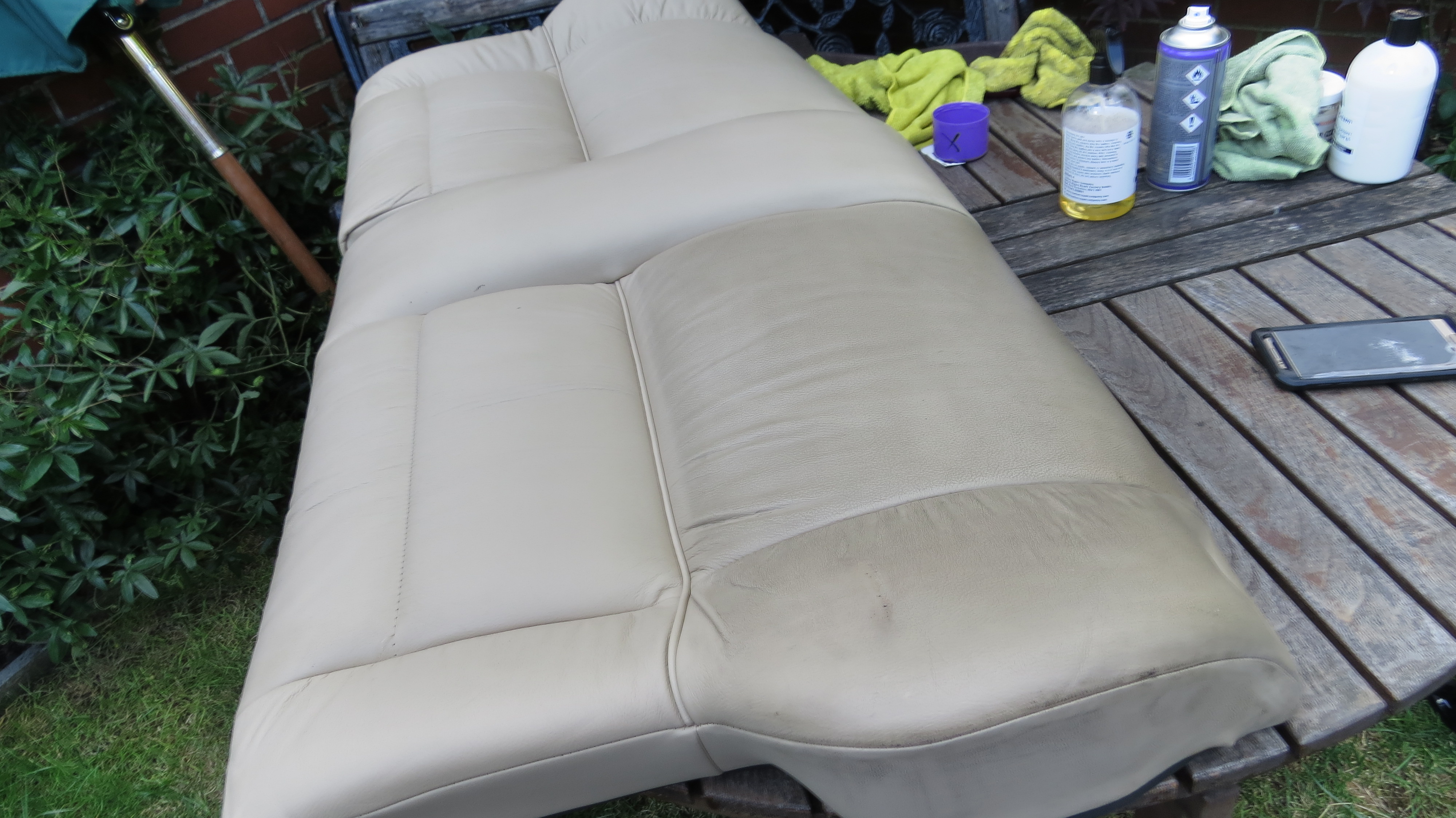

Re: The welly
the drivers seat was too far gone so replaced it with a passenger from John and maria
- Attachments

Looking good Rich, that seat was shot... not sure I’ve seen one that rough before

Cliff wrote:Looking good Rich, that seat was shot... not sure I’ve seen one that rough before
it wasnt the best the whole car was minging on the inside bud took some cleaning but got there in the end

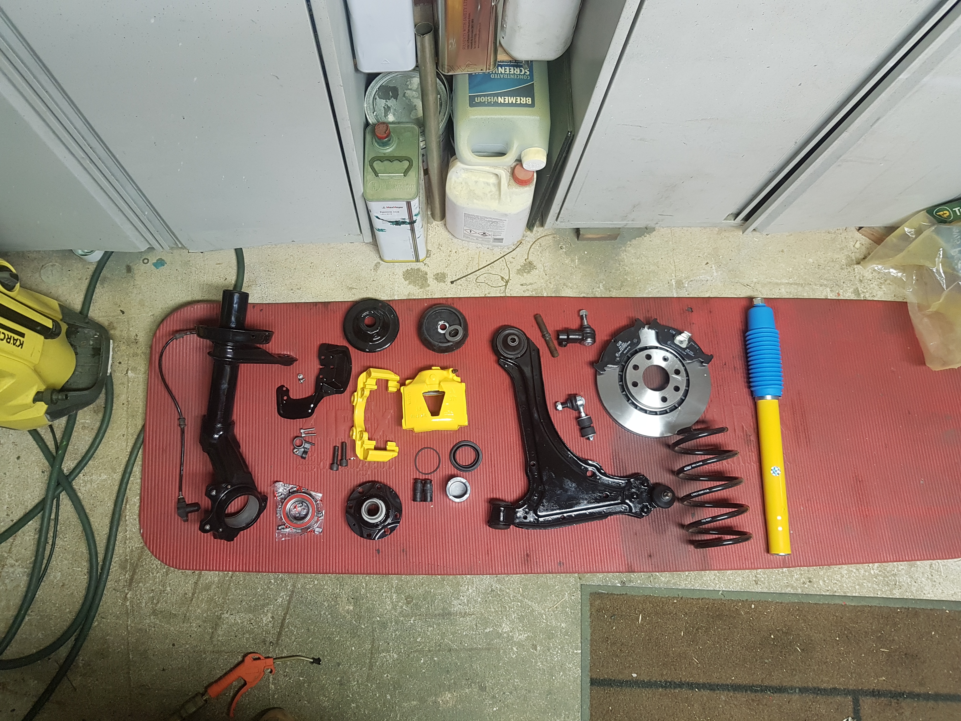

Next up was new pads and pad sensors which then led to the following
New pads
New pad sensors
New discs
New bearings
New dust shields
Nes ABS sensor brackets
New eibach pro spots springs 40mm lower x4
New bilstein b6 shocks x4
New top mounts and bearings
New drop links
New ball joints
New track rod end ball joints
New bolts all round stainless steel where possible
New caliper repair kit
Calipers and brackets stripped blastered back painted in yellow
All the black metal bits steering knuckle strut top housing inside of hubs all acid duped blasted and powdercoated in black
New pads
New pad sensors
New discs
New bearings
New dust shields
New drop links
New ball joints
