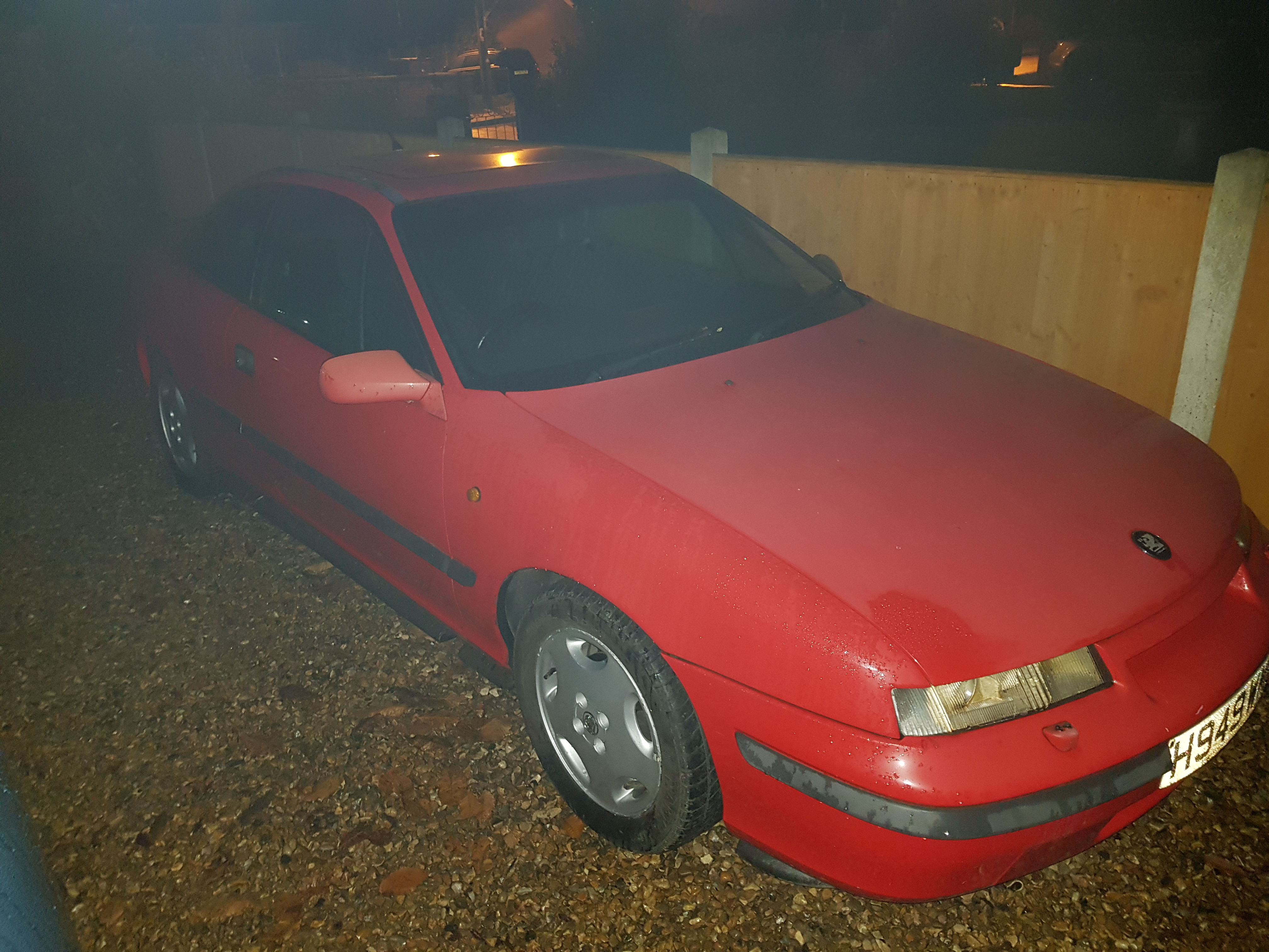

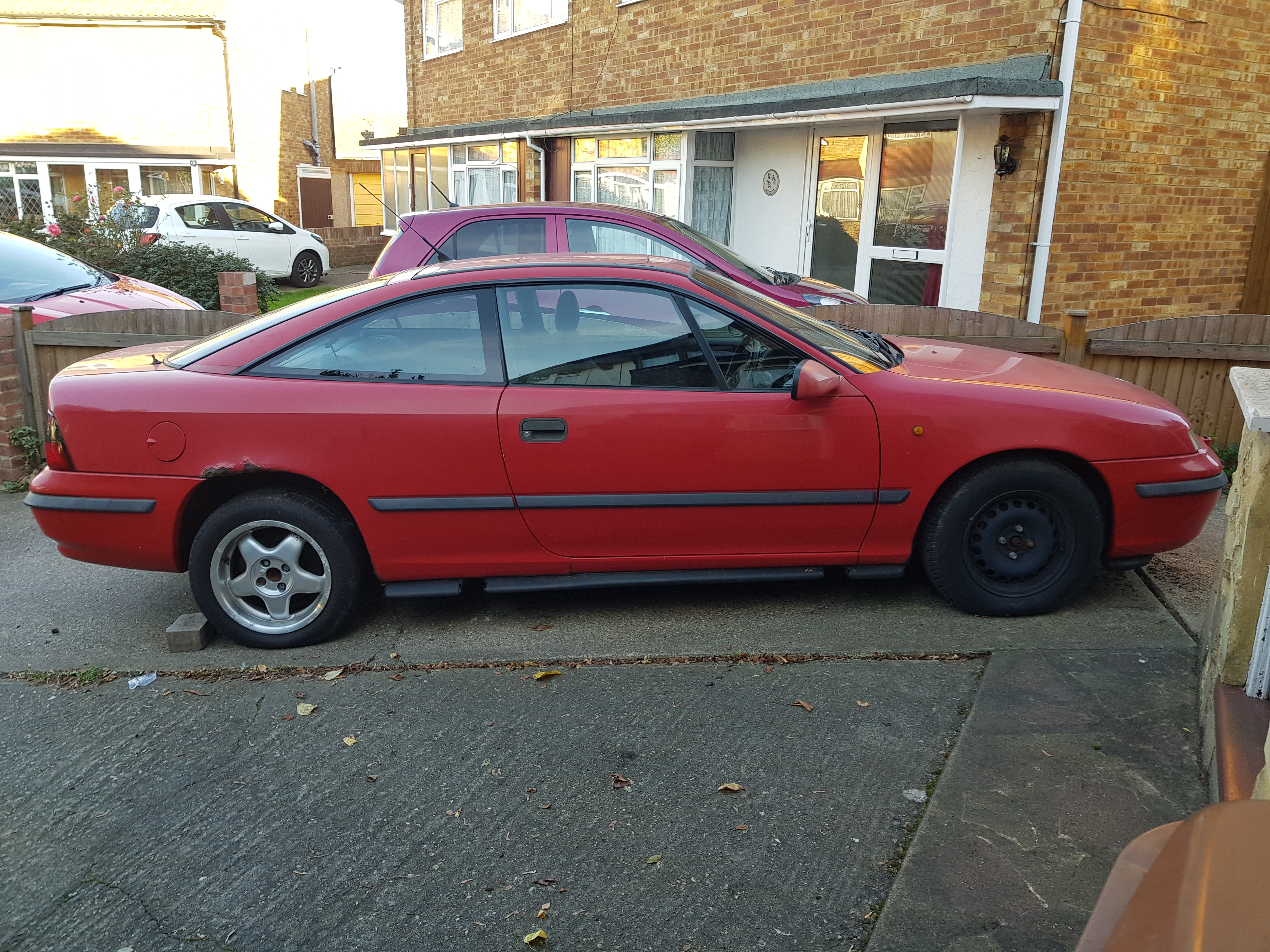

Hi All . Thought it was time I joined this site after some reccomendations on a Facebook page .
Back in 1994 my neighbour purchased this H reg calibra for some £5000 in 2hich time it was used occasionally covering very small mileage . For the past 5 years or so it sat on his driveway going more and more pink and gathering mould and not a week went past where I didn't ask if he wanted to sell it . Finally ! Just before Christmas he did ! For the sum of £250 a set of alloys and my ford puma lol

It would turn over and not run and hadn't done for a long time . The original slabs had been removed and the tyres taken off and just left in the garage
. First thoughts to me was just store it and sell it as it sits then I had a 4 day break between jobs . Looking over it it has some rot on the body but underneath was solid and she had only covered 61k . Non running was diagnosed down to the fuel pump . Stuck a new one on and changed the filter and boom she started however would not idle for love more money . After some fannying around and changing a few bits a new fuel regulator and idle control valve made it run like a dream
. First thoughts to me was just store it and sell it as it sits then I had a 4 day break between jobs . Looking over it it has some rot on the body but underneath was solid and she had only covered 61k . Non running was diagnosed down to the fuel pump . Stuck a new one on and changed the filter and boom she started however would not idle for love more money . After some fannying around and changing a few bits a new fuel regulator and idle control valve made it run like a dream- ClubCalibra.net

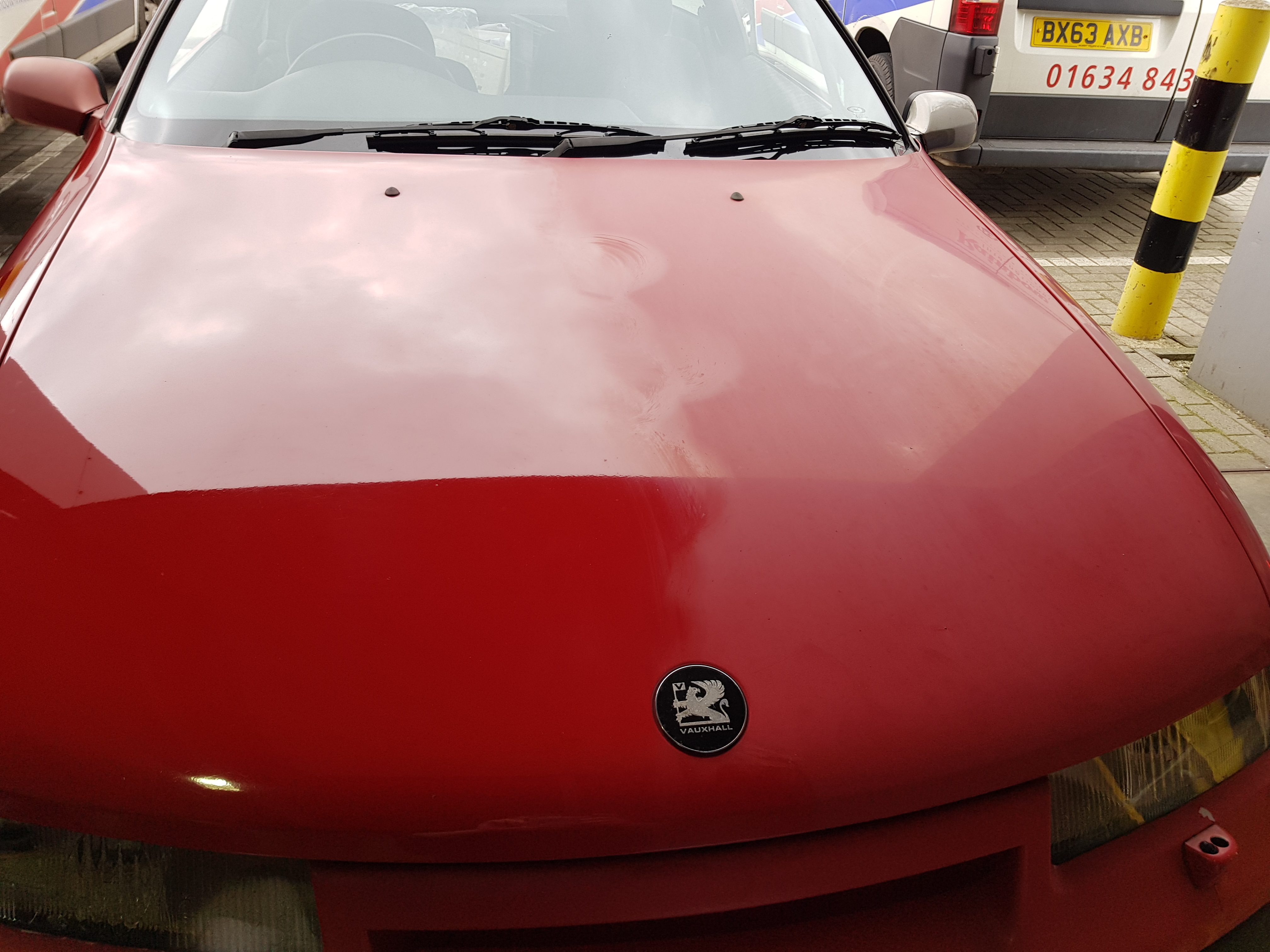

I decided to tax it and temp insure it and drove it for the first time in months and she drove like a dream . A very pink and dirty one lol . I got it to my work and then hit it with TFR and the jet wash then came the mopping and polish
