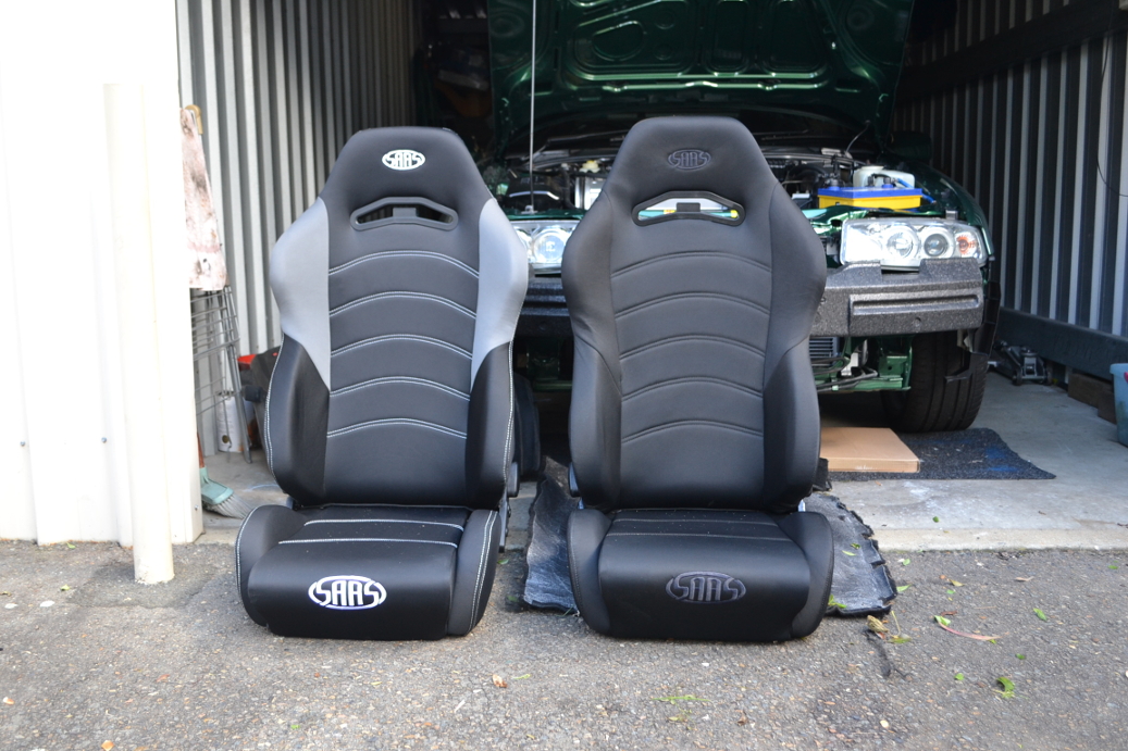

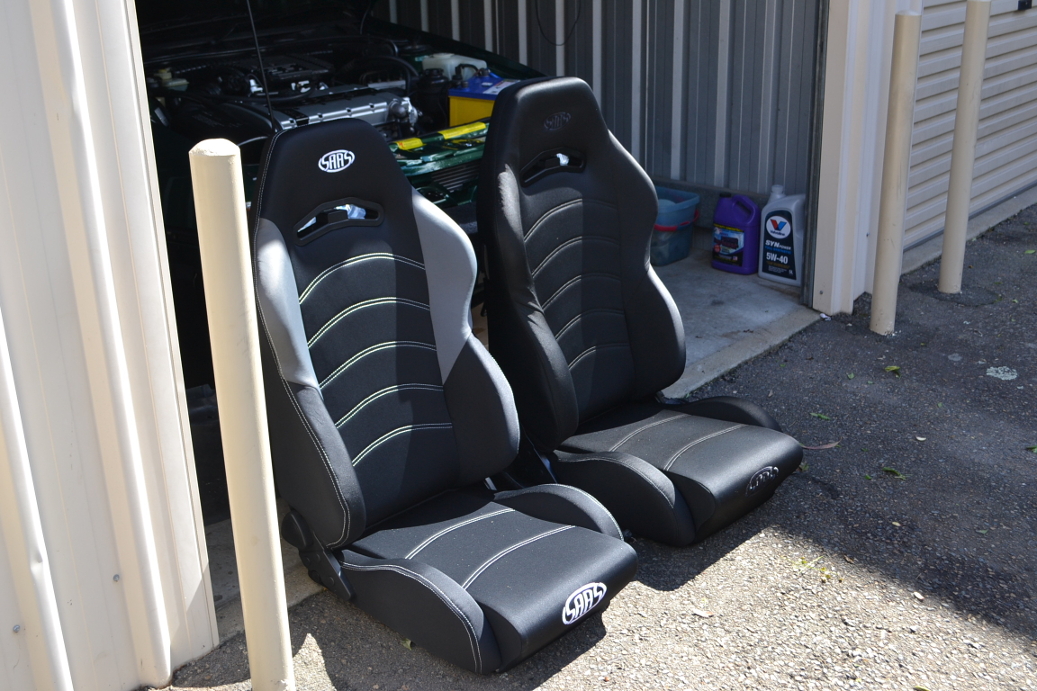

by cal16v » Sat Sep 03, 2016 2:38 am
After blackening out the offending areas...

by Cliff » Sat Sep 03, 2016 8:39 am
Nice job! Tbh, I like them both ways but I think the all black edition will suit the rest of the Cally interior a bit better - unless you want to "grey-up" the back seats!!!

by cal16v » Sun Sep 04, 2016 12:42 am
Cliff wrote:Nice job! Tbh, I like them both ways but I think the all black edition will suit the rest of the Cally interior a bit better - unless you want to "grey-up" the back seats!!!
A tip for anyone using fabric paints/dyes for fabric upholstery recolouring...
To avoid 'hardening' the fabric after the colour has dried, first mix a solution of 25% fabric softener, 25% white vinegar and 50% water and mist the fabric until it wets. Apply a light coat of colour and re-mist in between coats until you have sufficient coverage.
There is no need to wet down vinyl or leather.

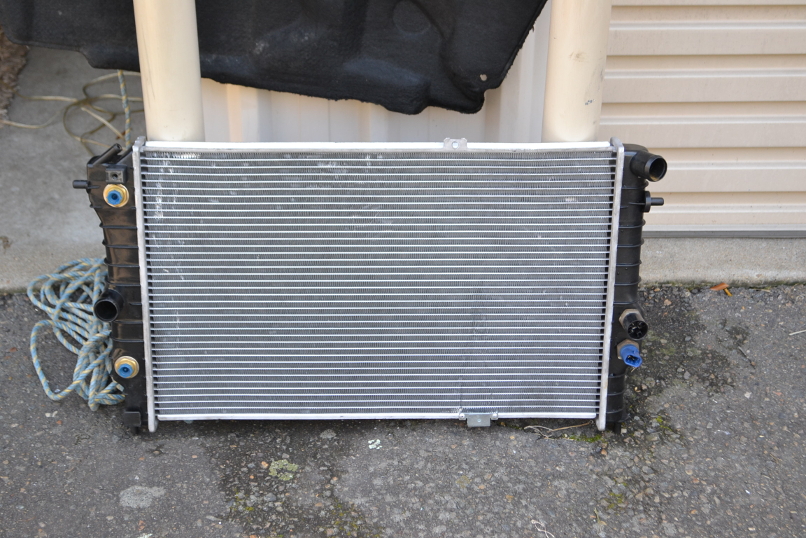

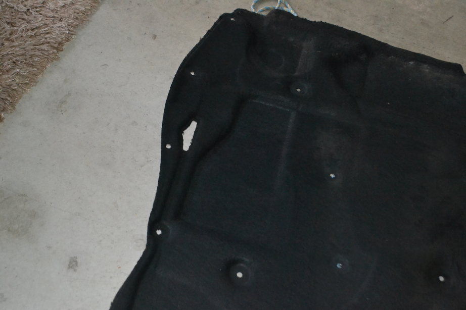

by cal16v » Tue Sep 06, 2016 11:37 am

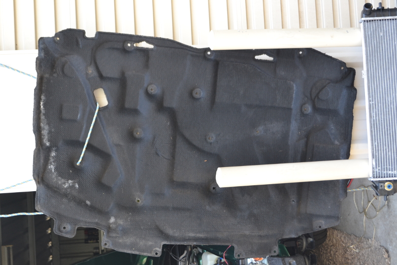

Picked up a near new battery and radiator from a lad parting out a Cali he unfortunately had a front ender in.
Also the original twin horn unit as I have no clue what happened to mine tbh and the bonnet lining which needs cleaning and a refurb.

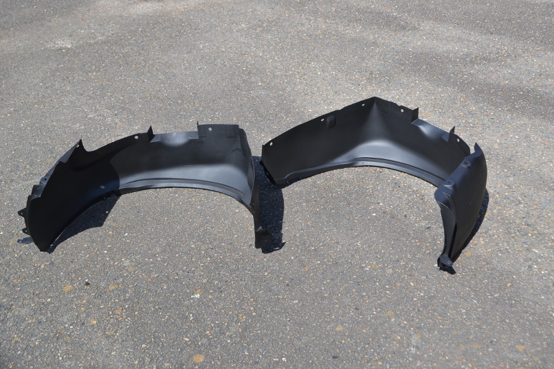

Cleaned up front inner guards
and this filthy piece of s!@t
Nice find...

by cal16v » Thu Sep 08, 2016 8:05 am

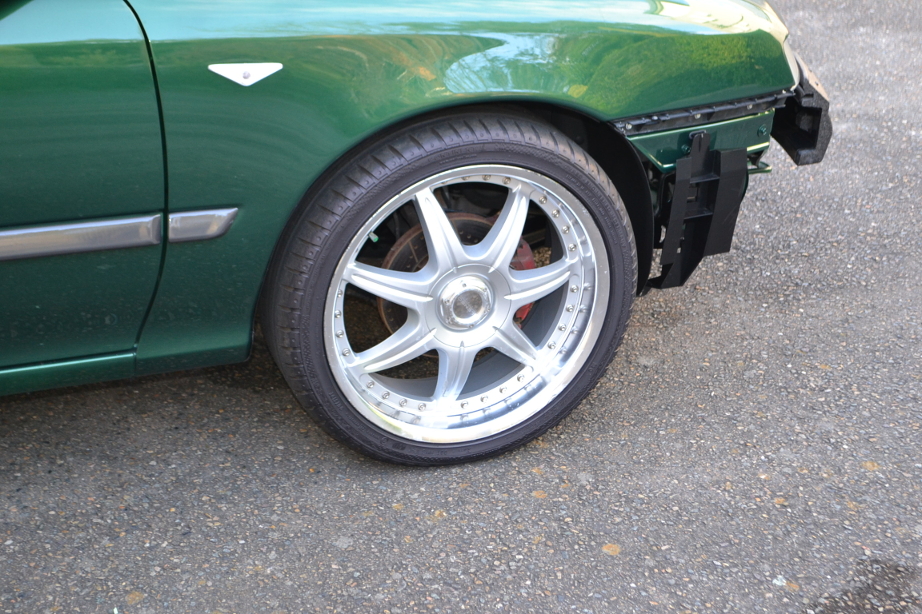

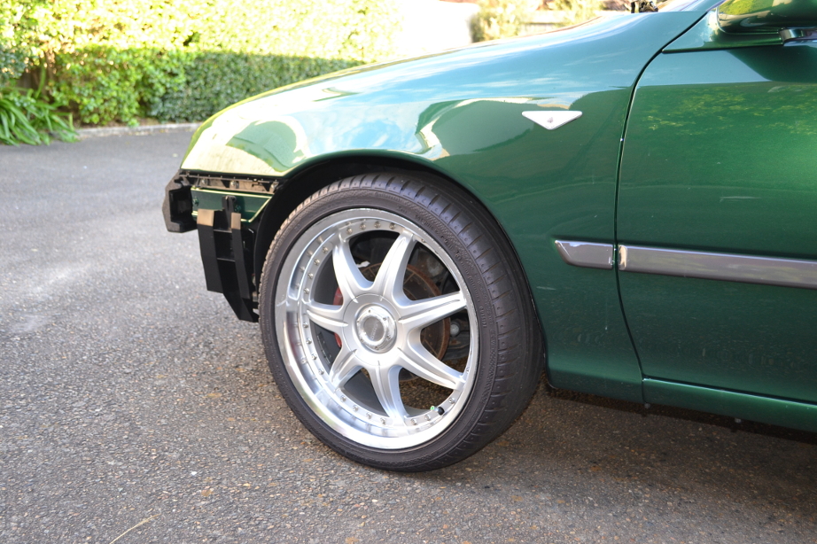

Inner guards are back on and cleaned up the front wheels a little. Wouldn't mind some other opinions on these wheels... never envisaged hanging on to them tbh but perhaps they're growing on me.

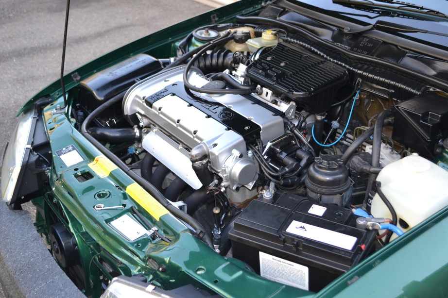

A few more pics of under the bonnet but still so much left to do... looking better without the bright yellow/blue battery :shock:
Started cleaning up the bonnet liner... hope you can see the difference in the small rectangular section I cleaned :lol:

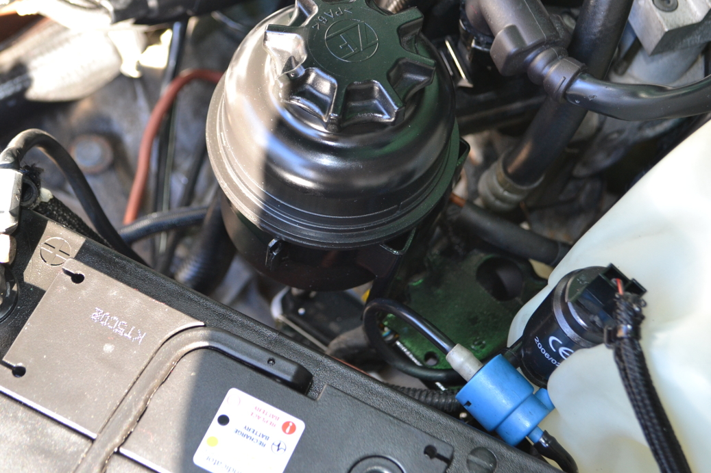

by cal16v » Fri Sep 09, 2016 11:21 pm
More tidy up...
Replaced the P/S reservoir bracket and cleaned up the mess of wires and hoses underneath. Cleaned up the ignition module heatsink and refited with new thermal paste.
