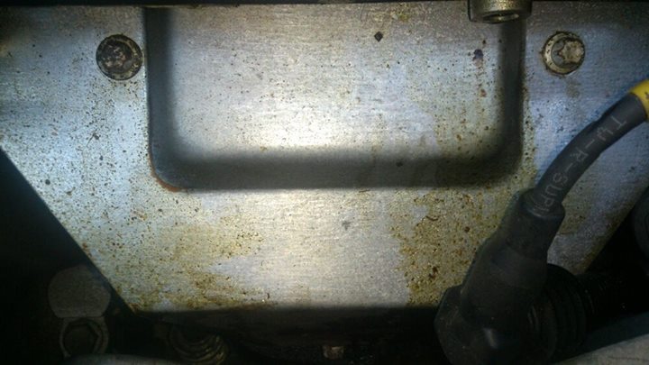

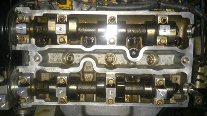

I initially drained the front 3 Spark Plug wells of oil, when I first bought the car...
It didn't take long to fill again, as I noticed more drops of oil, in the obvious locations...
Being that it's not a very difficult nor time consuming job, I decided to replace the Front Rocker Cover...
Hope to get the time soon, to do the rest of the Engine stuff...

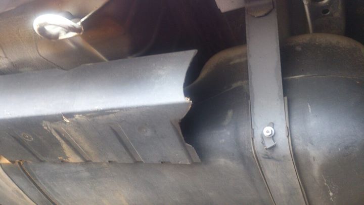

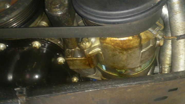

ACTIVITY UPDATE: 29 OCT 14 @ 81,630Km
Well the A/C Gas didn't last very long, so took it in to do some checking...
An Undercar Inspection was conducted, and it revealed that the A/C Compressor needs replacing...
Seeing as the car was up on the hoist, I decided to do an Oil Change as well...
I also used this as an opportunity to take some photos, for My Records...

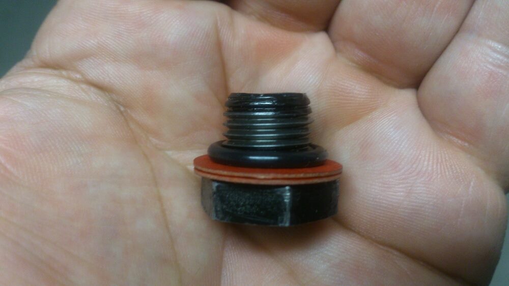

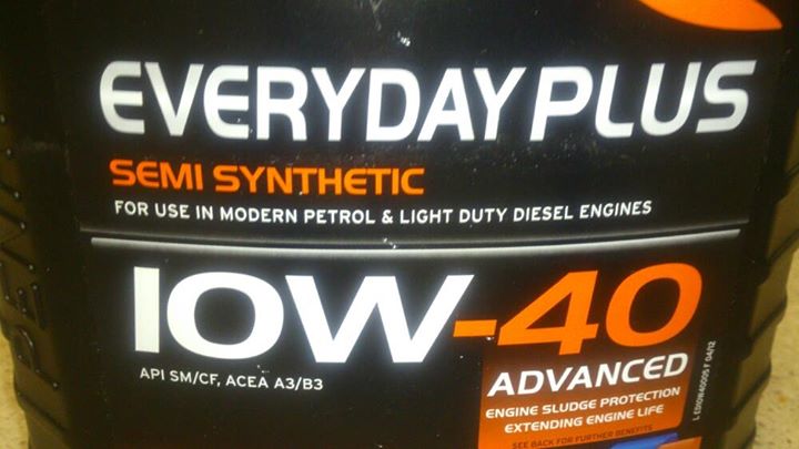

I had the oil changed recently, and prior to that, there was only a small amount of oil leaking...
Anyway, after the oil change, the amount of leaking had become rather large...
I thought this might have been due, to me using Semi Synthetic Penrite 10W/40 oil...
So I drained that oil out, and used 25W/60 oil, but it still leaked out oil from the sump plug...
I drained the oil out again, and replaced the old alloy oil sump gasket, with a new copper one...
No such luck... :doh:
I bought a new sump plug, specially designed to stop the leaking from the plug...
No such luck again... :think:
So I fitted 2 x Fibre Washers and 1 x Rubber O Ring, to the original sump plug, instead of the metal washer...
So far, not a drop has leaked from the sump plug... :dance:
I shall keep an eye on this over the next few weeks...

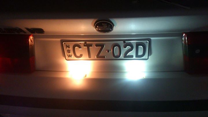

As we all do, or should do at some stage, I fitted LED's in the Rear Number Plate Lamps...
I didn't fit the NEW Lamp Covers just yet, but I will for sure...
Photo 1: Standard Bulb with Cool White LED
Photo 2: Warm White LED with Cool White LED
Photo 3: Both Cool White LED's fitted :dance:
Looking much fresher, and will look even better when the NEW Lamp Covers go on!!! :dance:

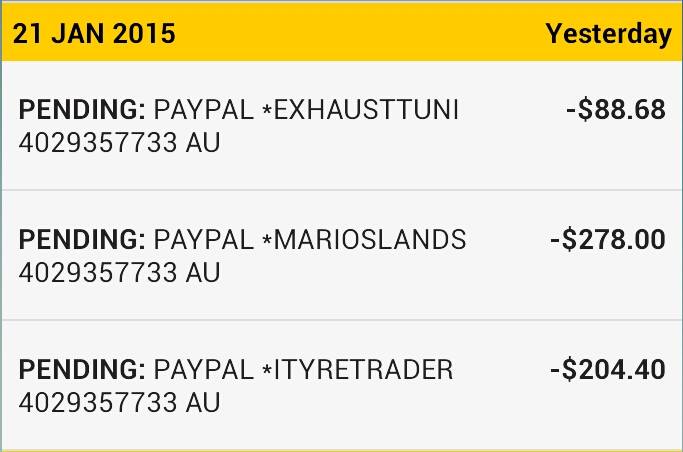

ACTIVITY UPDATE: 21 JAN 15 @ 83,860Km
I recently acquired a set of 16 inch 5 Spoke Factory Alloys, as a slight Upgrade to the Original 15 inch ones!
I then bought some New Tyres to be fitted, once I've given the rims a good clean up...
Also bought a SIMOTA Performance Air Filter, to fit back into The Ghost...
Progress is slow, but I'll get there, soon enough...

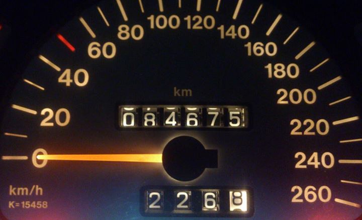

ACTIVITY UPDATE: 04 JUN 15 @ 84,675Km
After 6 months with the fibre washes fitted, I finally decided to replace the Plug Oil Sump...
I replaced the Fuel Pump Relay, as I suspected it was playing up... I'll know soon, if I was right...

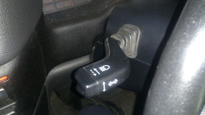

Also replaced the Indicator Stalk, as it was constantly tripping the high beams, on and off...

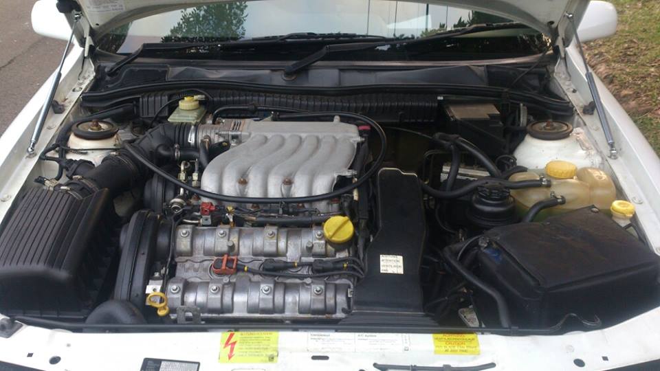

ACTIVITY UPDATE: 22 JUN 15 @ 84,905Km
After replacing the Fuel Pump Relay, the car no longer has the 'Idle Fainting' issue...

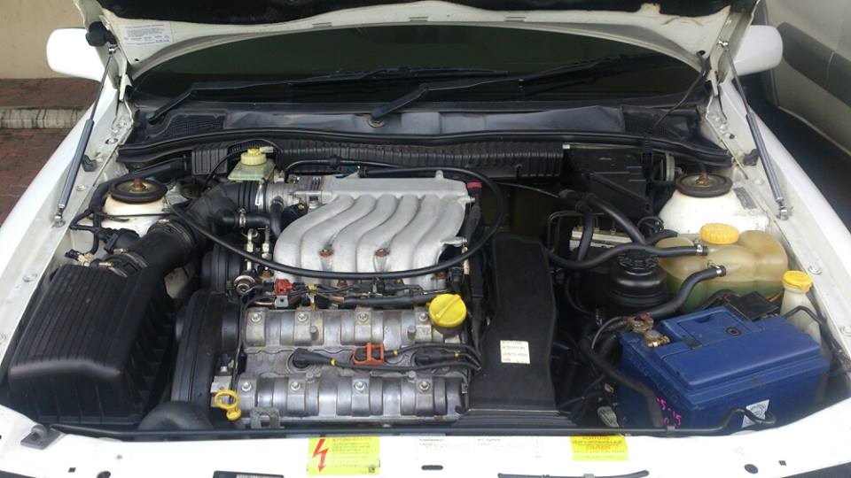

Anyway, after so many months of procrastination 'The Stocky' finally got some much needed TLC...
I stripped it down to the Oil Cooler, fitted an Upgraded Lower Manifold, cleaned the Middle Manifold
and fitted a set of Serviced Fuel Injectors... Fitted Metal Rocker Covers and New Spark Plugs...
Changed a few Coolant Hoses, and replaced the 'Sludge Stained' Header Tank Coolant Reservoir...
Now all that's left to do, is the Upper Manifold to be stripped, cleaned, assembled and re-fitted...
Will be all complete, in the next day or two...
Can't wait to hear it roar!!! :dance:

ACTIVITY UPDATE: 23 JUN 15 @ 84,905Km
EddeyDancer wrote: Now all that's left to do, is the Upper Manifold to be stripped, cleaned, assembled and re-fitted...
Will be all complete, in the next day or two... Can't wait to hear it roar!!! :dance:
Check List:
Lower Manifold - Upgraded
Fuel Injectors Serviced - Fitted
Metal Cam Covers - Upgraded
Spark Plugs Denso Twin Electrode - Fitted
Upper Manifold - All Components Fully Serviced
Replaced Old Gaskets and various Coolant Hoses
Header Tank Coolant Reservoir Cleaned Up
I was so relieved, when it started up first go!!!
The Engine Work for this car is now complete...
