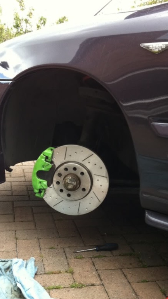

Refurbed the callipers

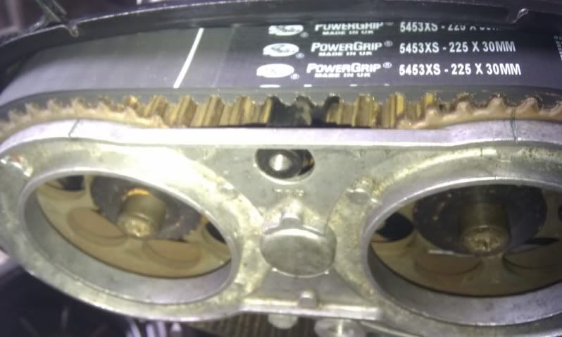

re-fitting the cam belt as its not set correctly at the moment -plus some butcher has had a go with a chisel. but replacing the front crank seal and poss the rear so the belt will have to come off and will be fitted correctly (without the use of a chisel)

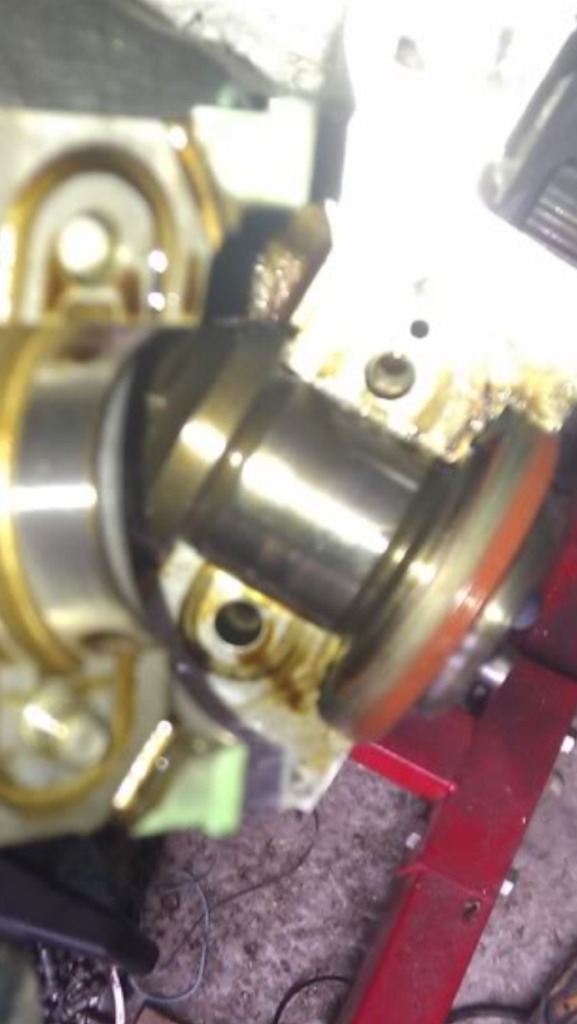

All looked good until the sump came off
After fitting the New front crank seal i dropped the oil which looked quite new then removed the sump pan and found white metal shell debris on the bottom and also in the oil pick up pipe strainer.
I then checked the con-rods for movement and found i was able to rock No 6 from side to side due to clearance. on removing the con- rod cap on No 6 pin - i found the shells where overlapped and the con- rod cap was damaged due to contact with the crankshaft web.
this damage has been caused by oil starvation, and would have caused excessive big end knock which would have been very noticeable whilst running.
So totally fubar'd

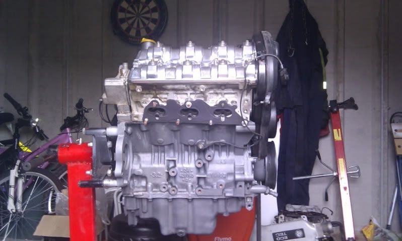

Ok, so I finally secured a replacement lump, another Z32SE with 60k on the clock
Few things to sort out
It has a none eccentric bottom roller so needs new kit as the Cally kit from mine won't fit.
Also has the wrong inlet divider in it so there will be a lip which will interfere with the induction flow but luckily I kept hold of the 3.0 Omega one I got hold of

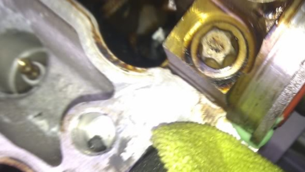

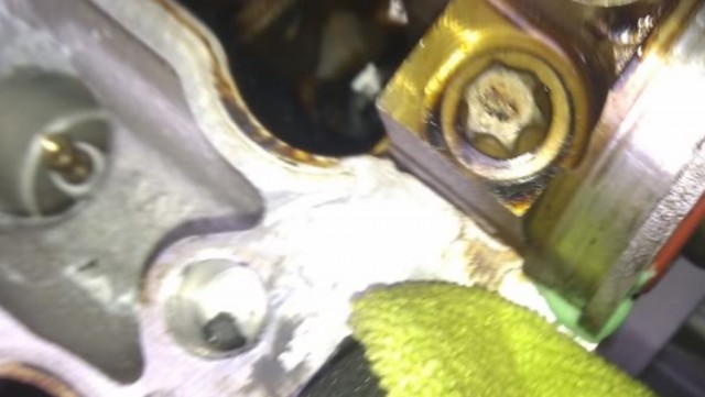

First job remove the sump and check for issues - thankfully all looks good in there, no metal shards etc like the last one.
He has found a couple of issues though. Firstly the heat exchanger plate has a hole in it and has been leaking coolant for some time.
This isn't a major problem as I have a new exchanger to go on anyway but we removed the heads just to check for any signs of overheating. It means a new head gasket set but better safe than sorry
No obvious signs there although found a piece of plastic under the cam cover for cylinder head 2-4-6!!!
no apparent damage except for the cam cover gasket but will be putting new ones anyway when the polished Veccy covers go on.
Due to the coolant leak also checked for any signs of damage to the plugs but they're clean as a whistle
Next job was to remove the induction assembly and replace the heat exchanger which has seen better days. A hole in the heat exchanger plate had caused some coolant leaks.
No anti-freeze either so the water jacket looks a little ropey.

Then there's not much else left until transplant day

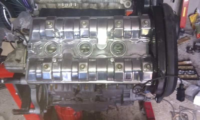

Heads now back on and my nice shiny cam covers now installed too

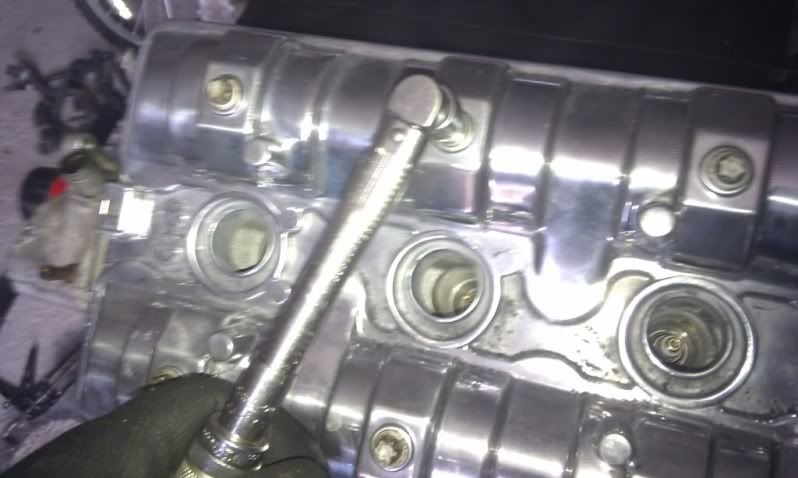

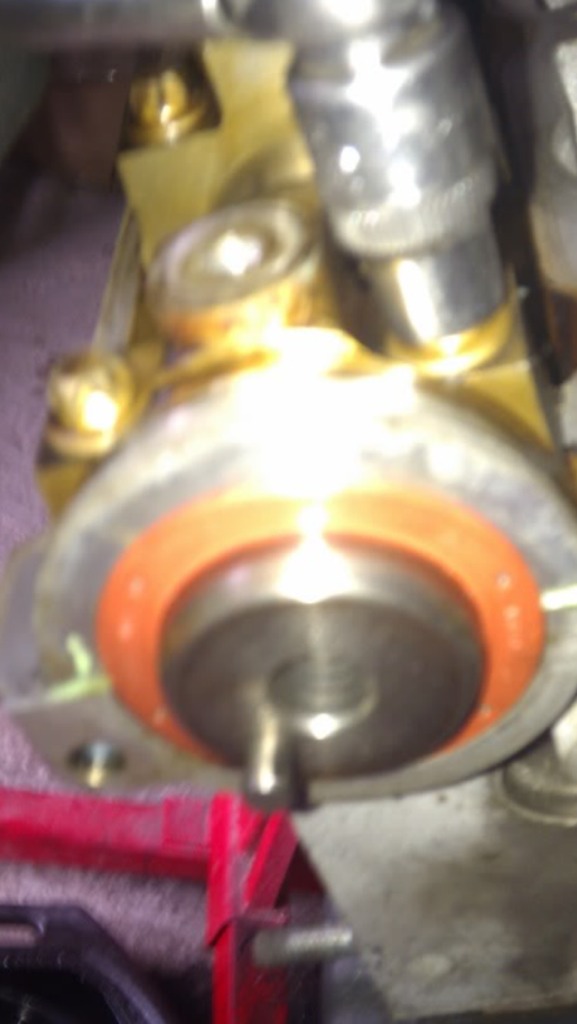

cam cover seals & O rings fitted

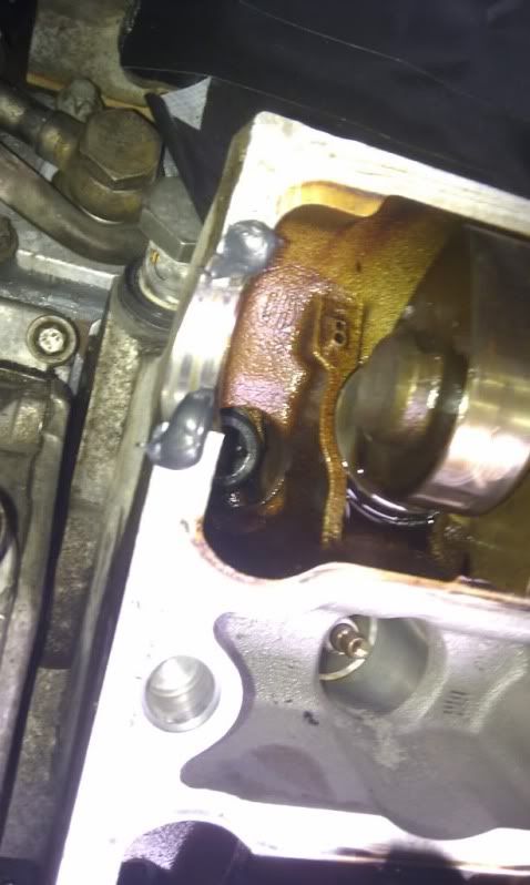

cam seals fitted - front cam caps sealed with Omnifit - be aware keep it well away from oil channel!
cam caps torqued to 8 NM
excess Omnifit must be removed for cam covers to seal
Last few bits of engine work before transplant day

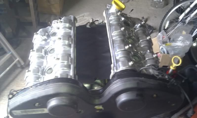

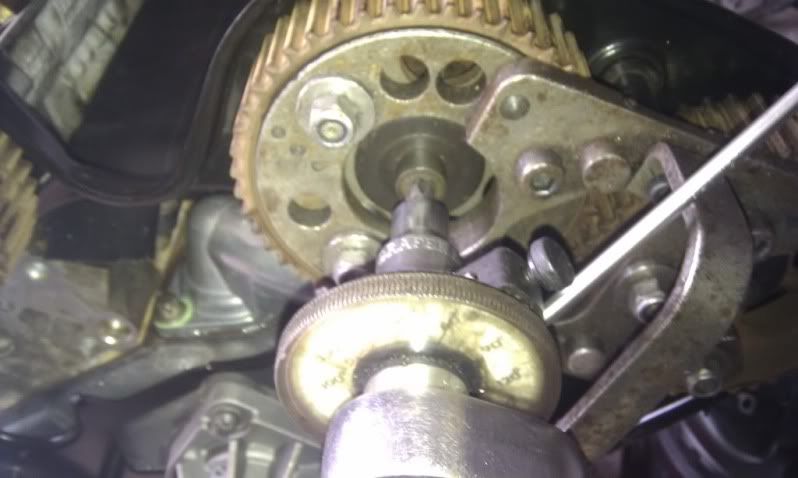

backplate fitted and torqued to 8NM

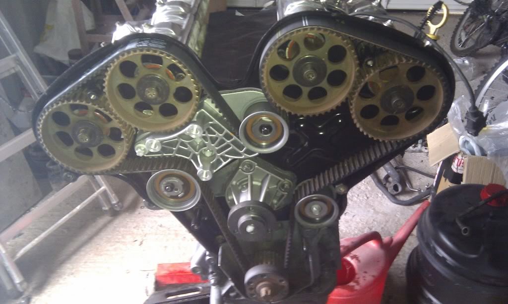

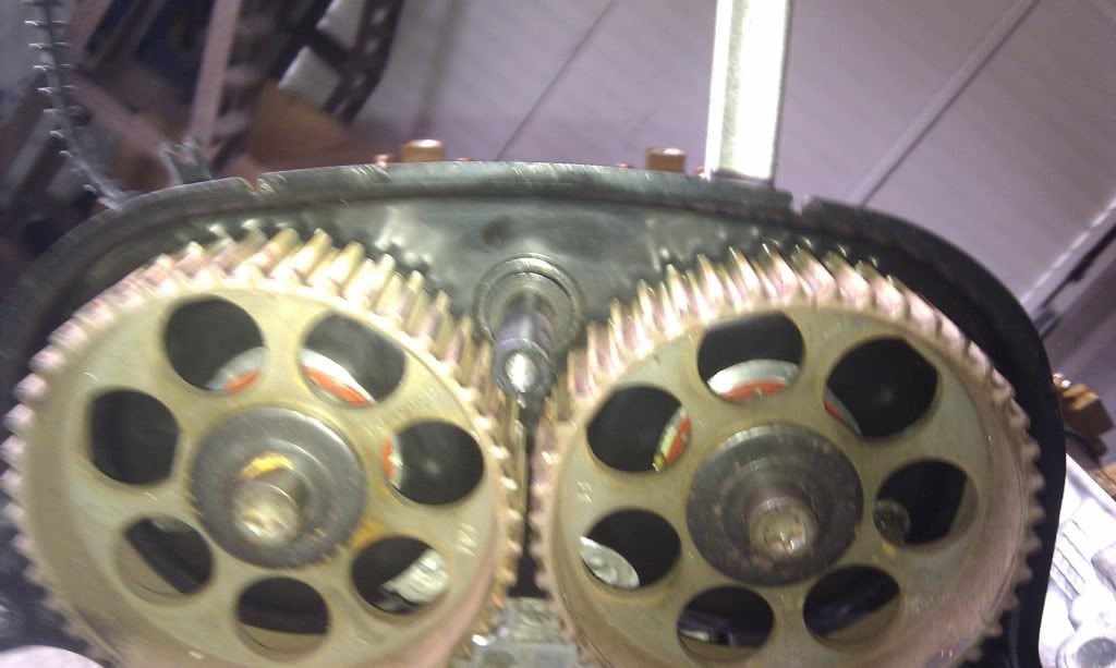

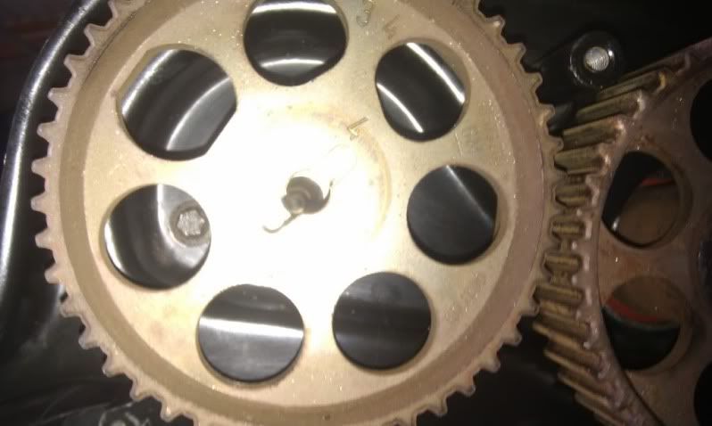

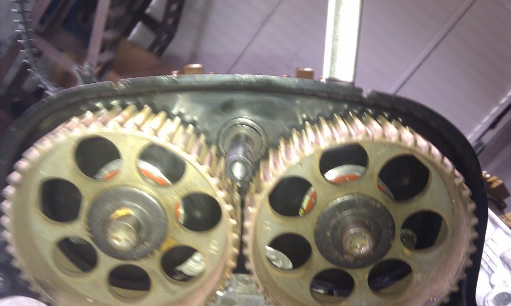

Cam gears fitted note from left hand side (1-3-5 exhaust cam aligns with No 1 1-3-5 inlet No 2 and so on
cams turned to align cam gears with backplate cutouts (this is what they are for)
cam gear locks fitted (factory tools) and bolts torqued & angled

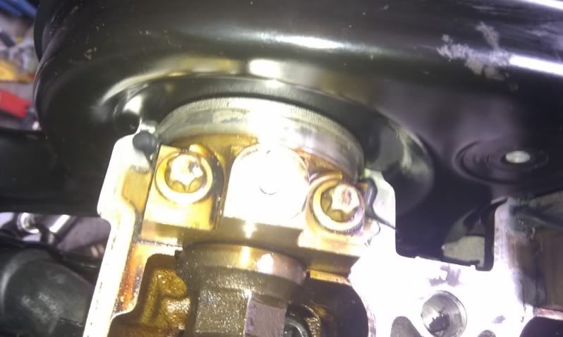

half moons and front A Bearings cam caps sealed with loctite 5900
cam covers fitted and torqued to 8NM

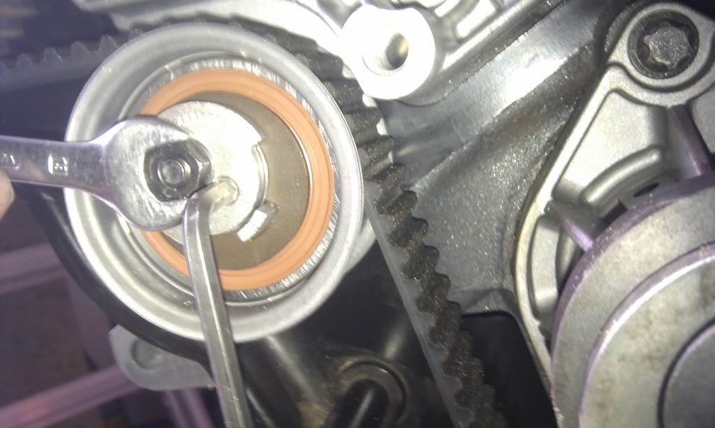

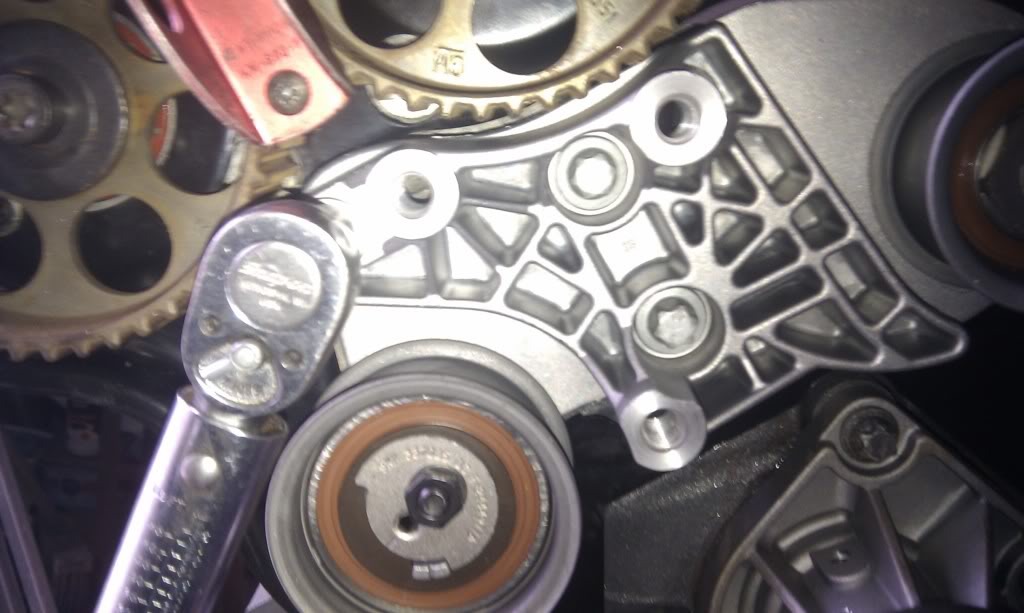

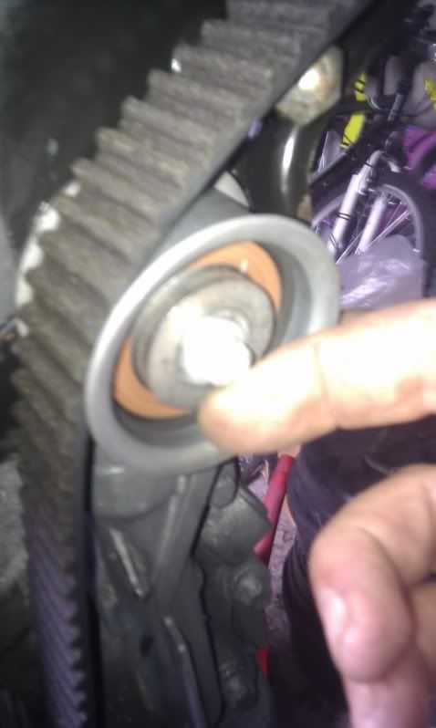

tensioner housing (motorbike as known in the factory) fitted and torqued 40 NM
belt fitted note all slack pulled over to 2-4-6 bank in order to fit bottom none eccentric roller
all slack pulled back so that crank marker lines up with oil pump notch

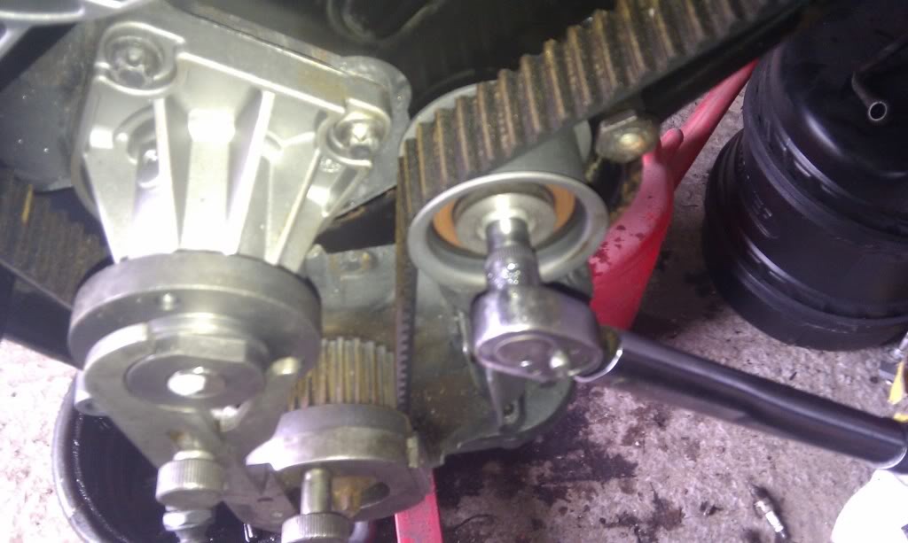

top roller set

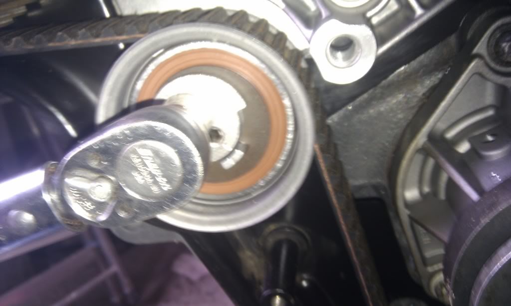

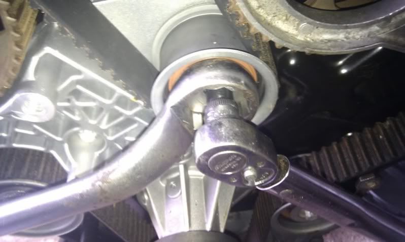

tensioner set to full tension

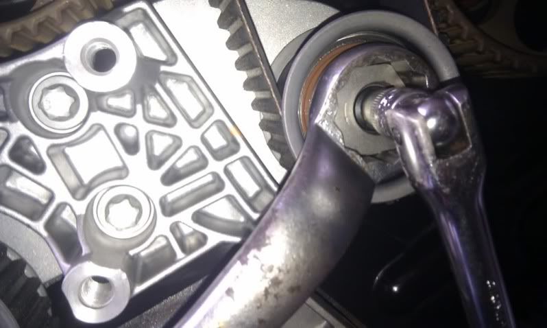

engine barred over and timing marks checked - (note no adjustment on 2-4-6 bank on this model due to none eccentric bottom roller)
rollers torqued up 40 NM
Tensioner set and torqued to 20 NM
Timing complete

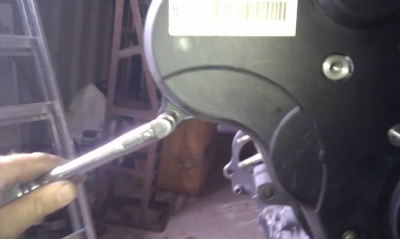

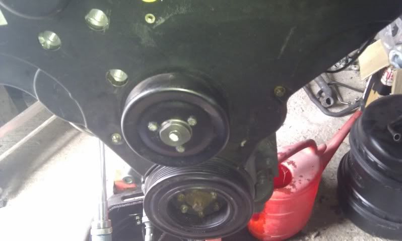

timing cover fitted and bolts torqued to 8 NM note - extra bolt fitted to later models

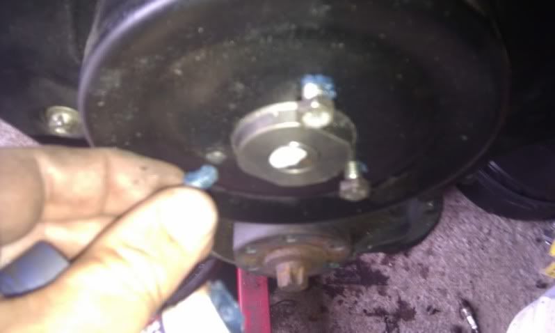

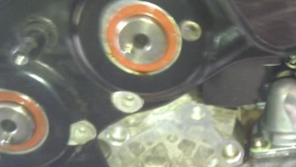

water pump pulley fitted - bolts must be loctited
torsion damper fitted bolts torqued to 20 NM

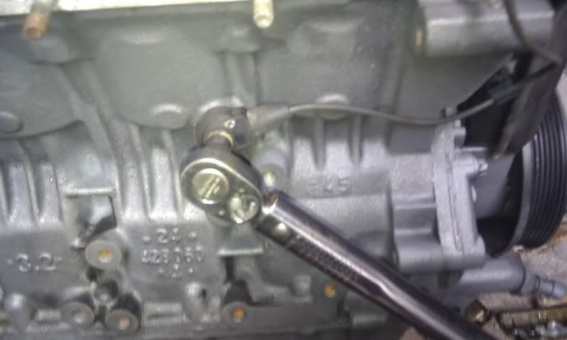

Anti knock sensors fitted & torqued to 20 Nm (critical)
finished now just waiting for the fitting date to fit all the calibra bits to it
top roller set
Timing complete

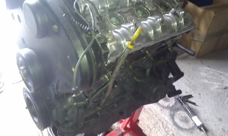

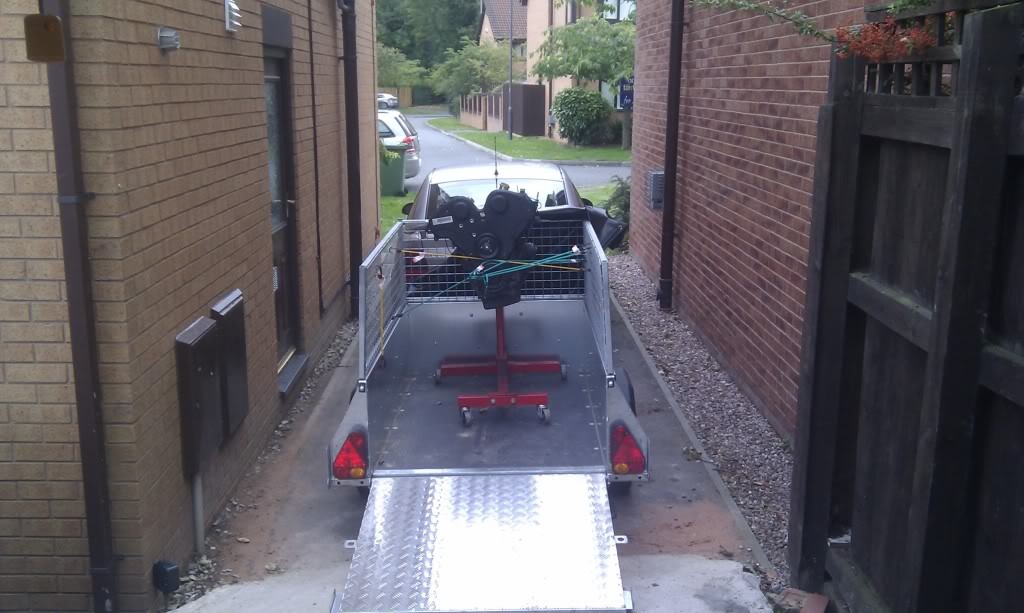

Engine on it 's way to the garage with a four poster
Transplant day!!!
Old lump unplumbed and ready for removal
Lifted the car on the 4 poster to get underneath
Ran a forklift with a pallet on it underneath and lowered the engine onto it
She's out!!!

All finished with polished inlet
