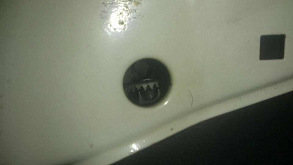

craigyboy wrote: Does anyone know how to alter the beam, to face to the left on the sonar after market headlight units?
I just want to know, before I go and strip the front of the car...
No need to remove anything...
Get a screw driver, stick it in that hole, and turn that jagged wheel accordingly...

I doubt they will adjust enough using that adjuster, thats the same as the original headlights and will only give a slight adjustment
have you perhaps purchased left hand drive ones ?? there is usually some form of direction on them to show left or right hand drive ...an arrow pointing left or right

Gave it a try and it doesn't seem to be working
I think that's for altering the main beam and not the
dipped headlight. I'll have to take off the bumper
and get the lights out.

The only bit on them Fraz is the part that Eddy told me to
try and it only appears to alter the reflector for the main
beam.Tomorrow i'll try and take off the lenses and see if
I can get behind the main reflector and see if there's a
bit that can be adjusted.
