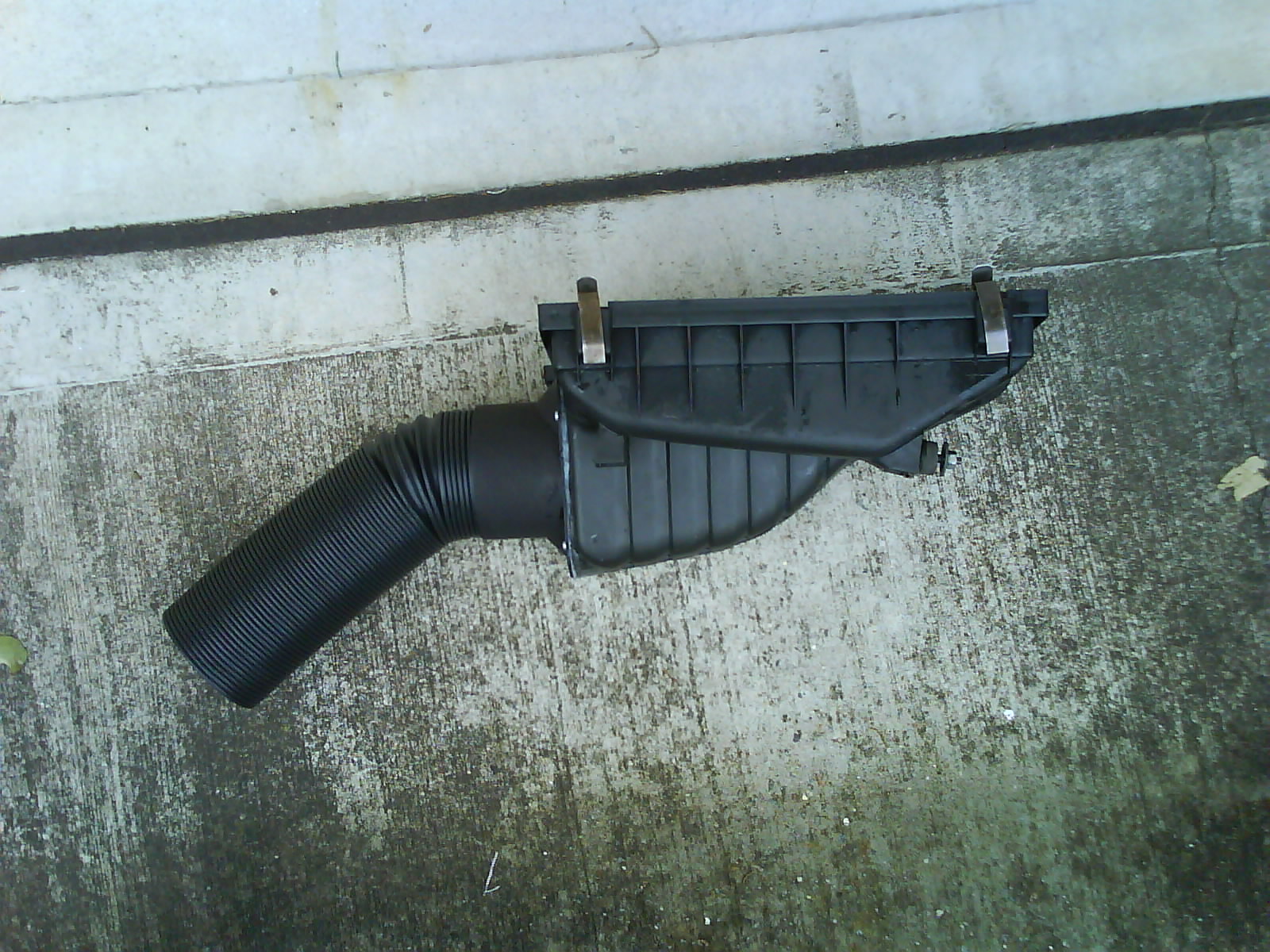

Hi Guys,
Some pictures below of the airbox mod and fitted lower intake manifold from X25XE.
The hose I used is called Memorex, 76mm internal diameter, and it retains it shape when formed and stretched.
I used 90mm PVC piping which I modified to fit the airbox.
Enjoy
Enjoy

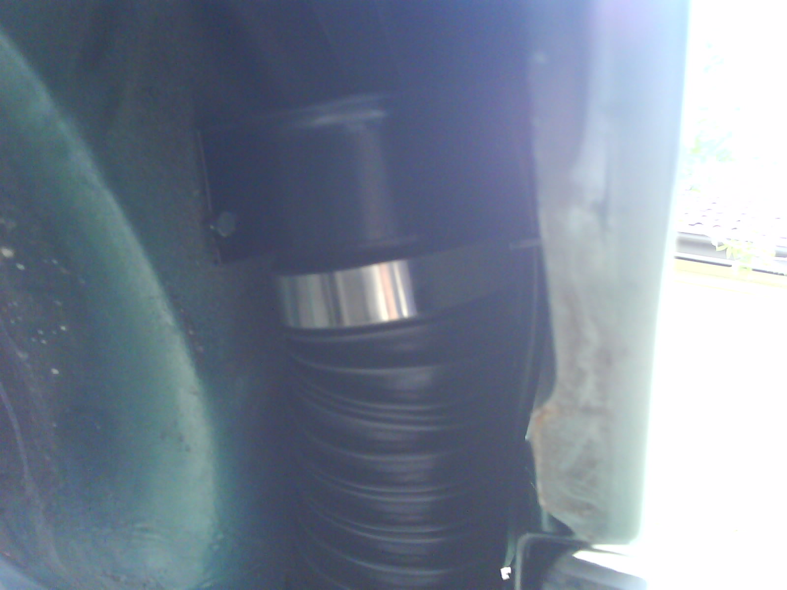

Hi Guys,
It fits fine with the modifications I did.
Instead of trying to have the intake come out of the toe eye cover I just decided to stick to the orginal route, and keeping the intake high and hopefully dry.

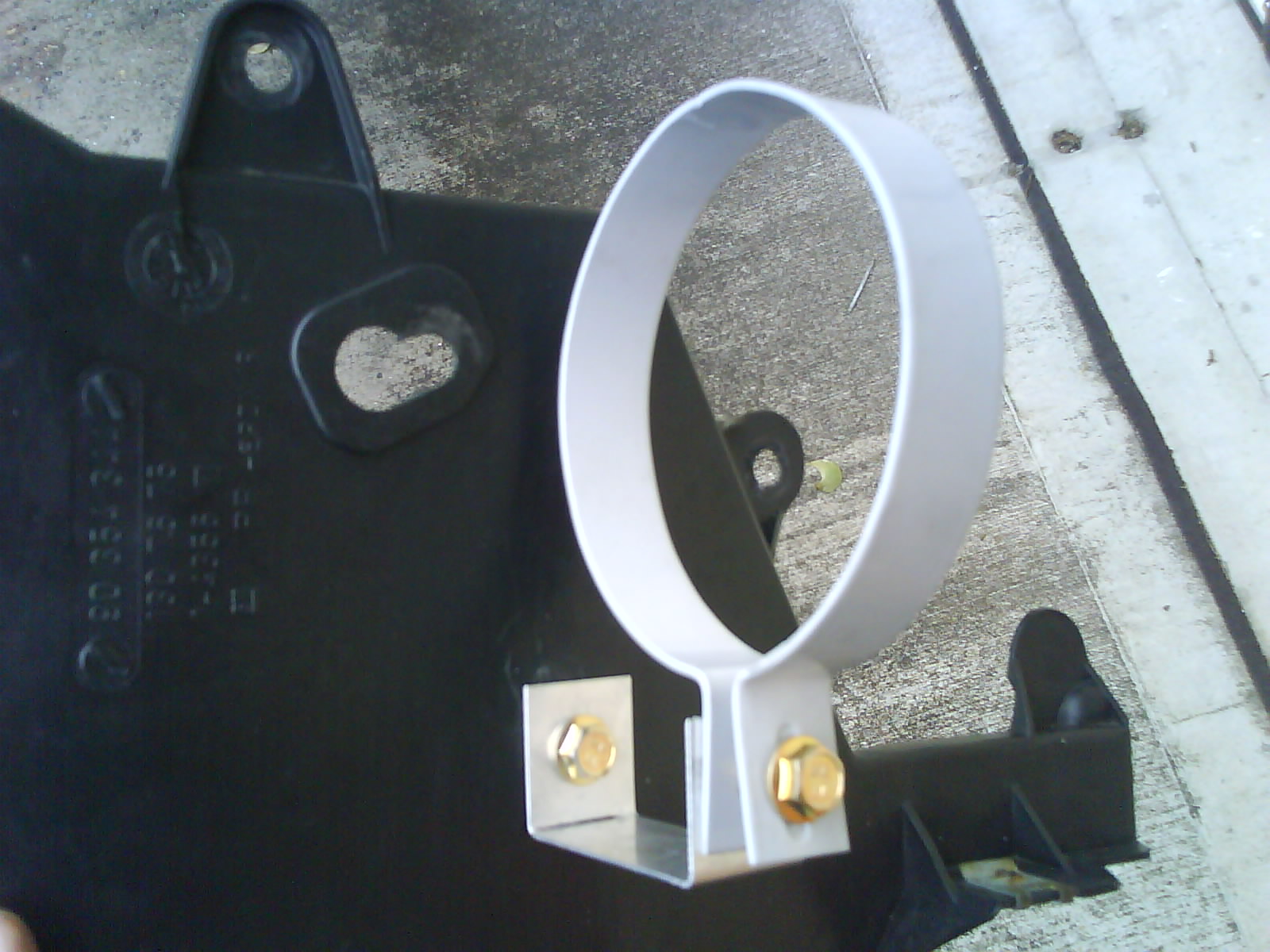

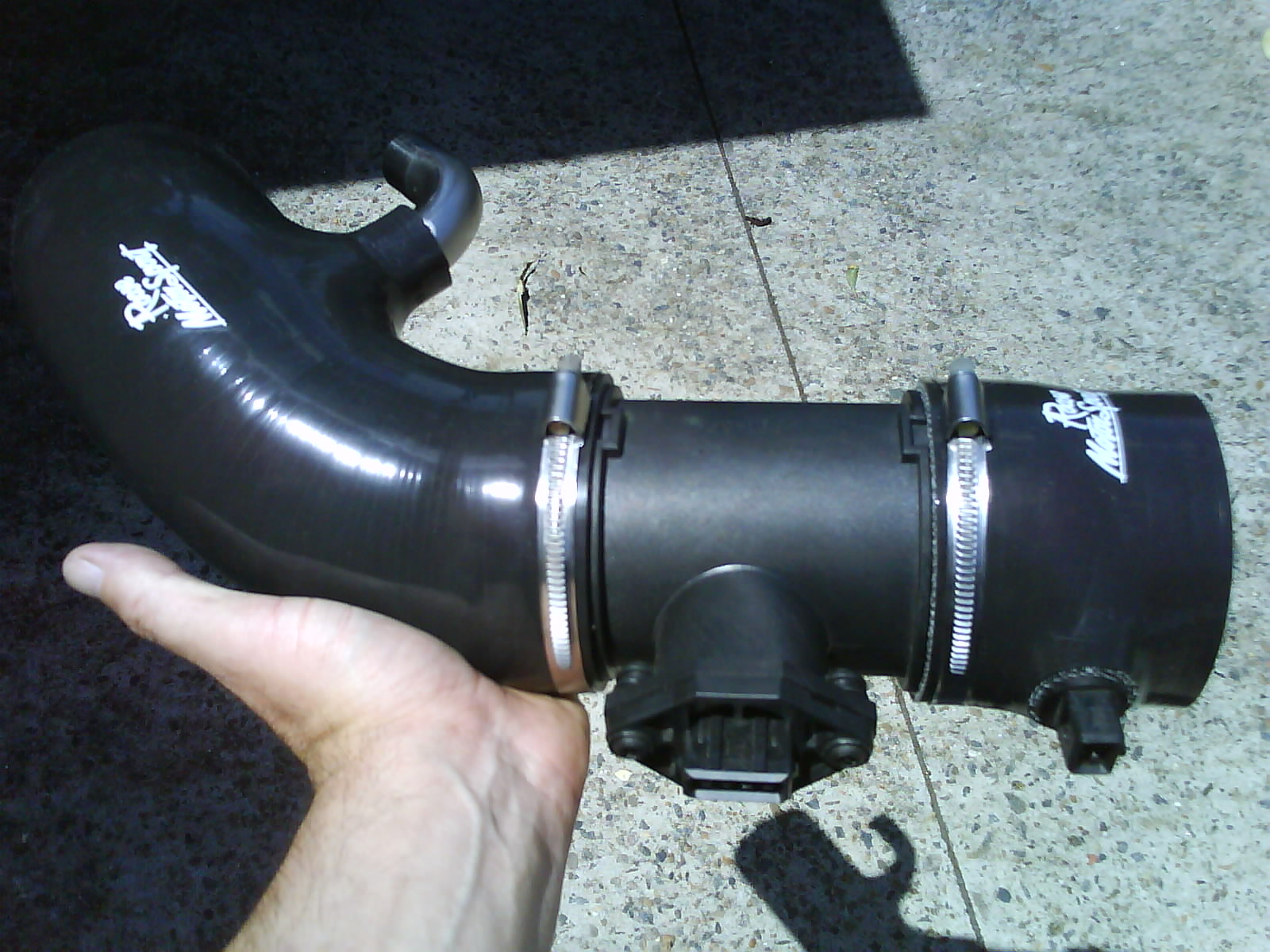

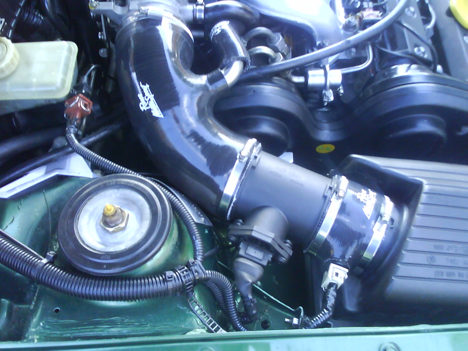

Hi Guys,
Some pictures below of the roose motorsport intake piping.
Enjoy
Enjoy

Re: Rio Verde Green V6
Odd you had to cut some off, mine fitted with no problems.
I wonder if the 'Roose Hoses' have any benefits, as the 'Original Induction Hoses' certainly do look better...
Mark1 wrote:Odd you had to cut some off, mine fitted with no problems.
Hi Mark,
I tried fitting them initally without modification, but the hoses & airflow meter just would not fit between the throttle body and upper part of the airbox, so I had no choice but to modify it. Well now it fits properly, so all is good in my world.

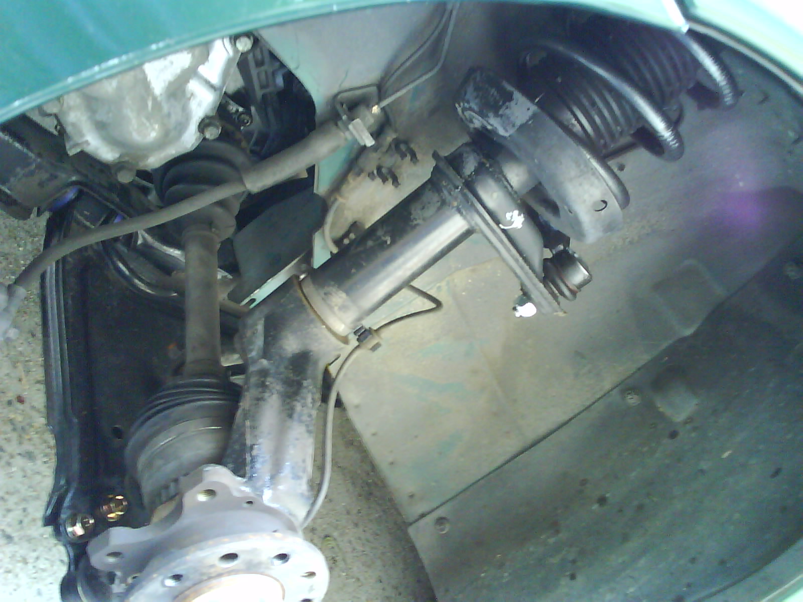

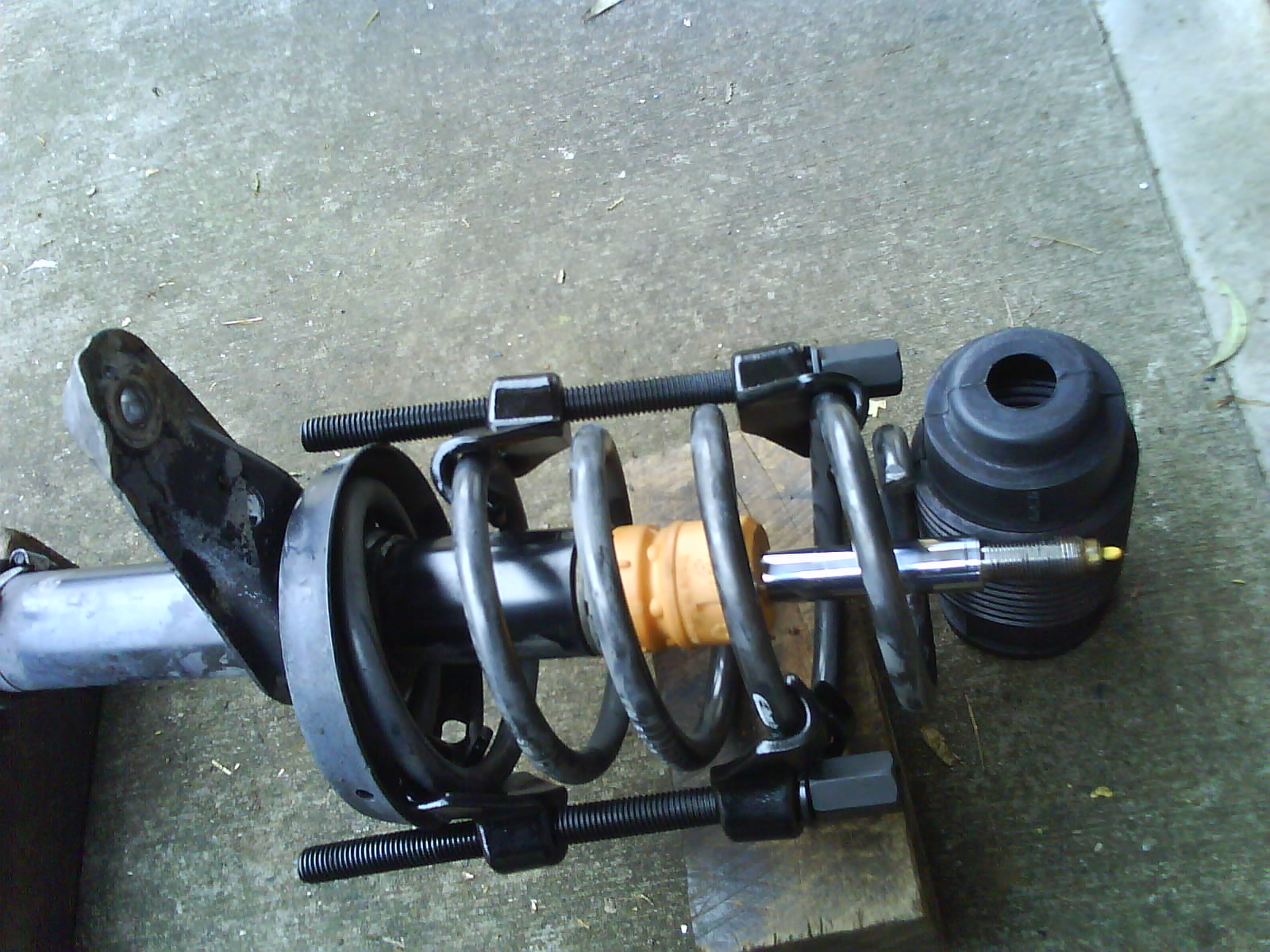

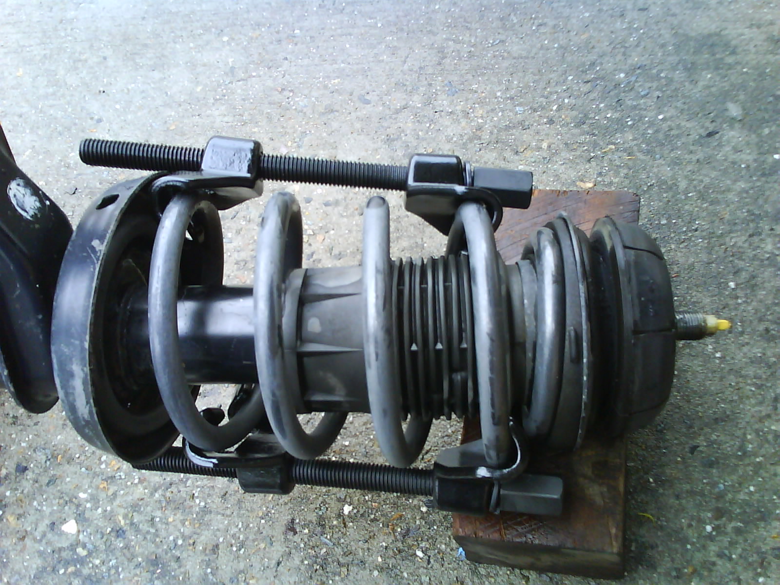

I thought I'd provide an update, I finally finished the front suspension replacing the shock absorber support, support bearing, bellows, stop buffer, tie rod end and ball joint for each side.
Just a note, the castellated nut is an absolute pain in the *** to get off and refit as you need a ton of leverage and force to undo and redo the nut, that why I showed the picture so you could actually see how I set up to undo the nut in case you wish to try it. I'd follow the haynes manual it is a straight forward job to do otherwise.
Pictures follow.
Enjoy.
Pictures follow.
Enjoy.

BMJ wrote:Just a note, the castellated nut is an absolute pain in the *** to get off and refit as you need a ton of leverage and force to undo and redo the nut, .
Thast becasue you did it wrong ...you undo the nut first while the brakes are still on, that way you can
A. get someone to press the brake while you undo the nut
B. Jam an old screw driver or bar into the cooling vents of the disc so it will then jam aginst the caliper (if the disc has broke the securing screw then simply put 2 wheel bolts in)
done it that way many times and never had any problems
