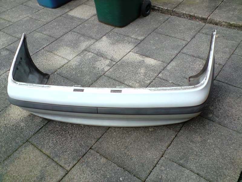

i now got the rear bumper off to remove the old bump strips and found that it had never been removed before (certain bolts hadn't been left off like usual.. so it was nice to find that the car is unmolested underneath
broken bump strip..
and once id got them off..
nice and clean
broken bump strip..
nice and clean
