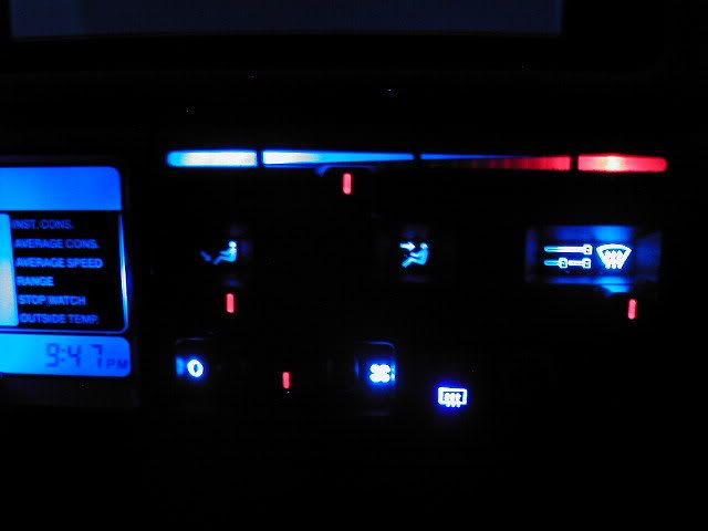

<!--QuoteBegin-Rusty_CallyT+--><div class='quotetop'>(Rusty_CallyT)</div><div class='quotemain'><!--QuoteEBegin-->wanted to do this on mine, not very easy at all, im just going to live with it<!--QuoteEnd--></div><!--QuoteEEnd-->
Easy to do, just need patience :wink:
mines done with red and blue led's looks great 8)

Posts: 2357
by RobbieV » Tue Oct 12, 2004 2:45 pm
Just to add
Heater panel lights always come on when you turn the ignition on, hence why they burn out so quick [img]/sad.gif[/img]
My led's are wired up to the glovebox light so that they only come on when the lights are on :wink: [img]/smile.gif[/img]
