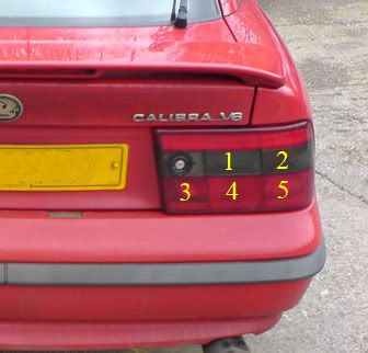

so its number 4 on attached picture that isn't working
if it is then i'm not sure mate, i have just solved all my bulb problems recently as i kept having probs on the right hand stop/tail light but thats all sorted, maybe a bad connection to that side light, have you checked to make sure the wires are connected to it and none have worked their way loose or snapped off
