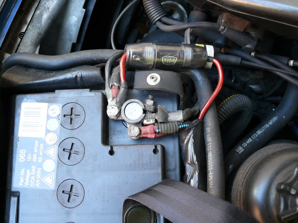

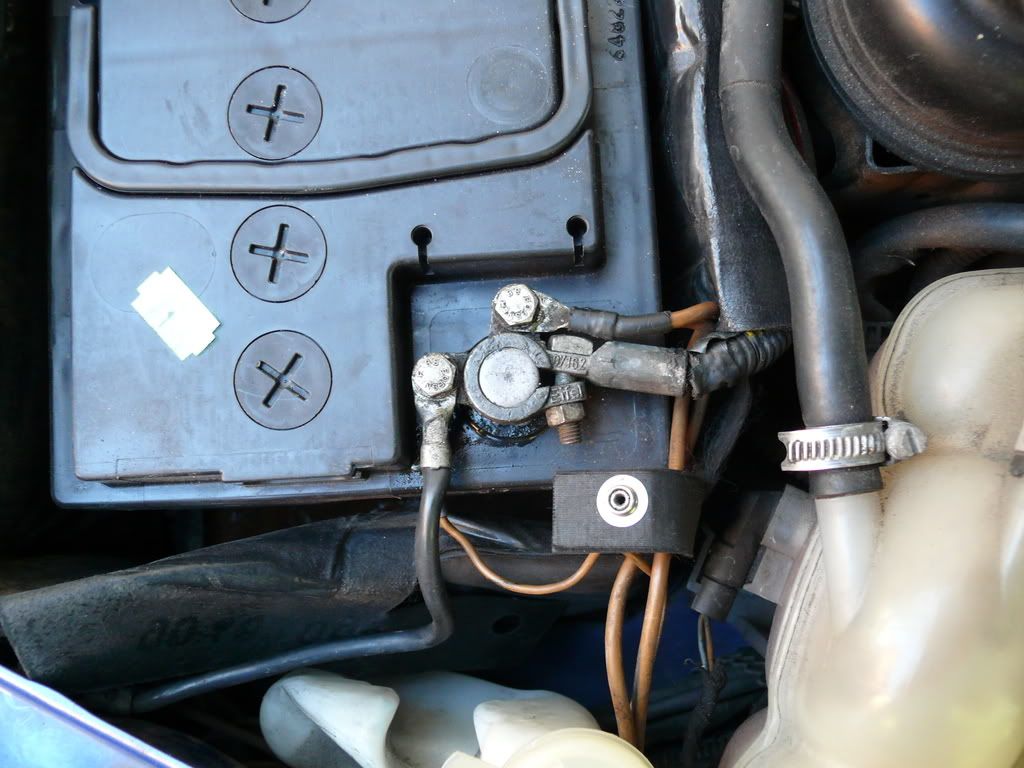

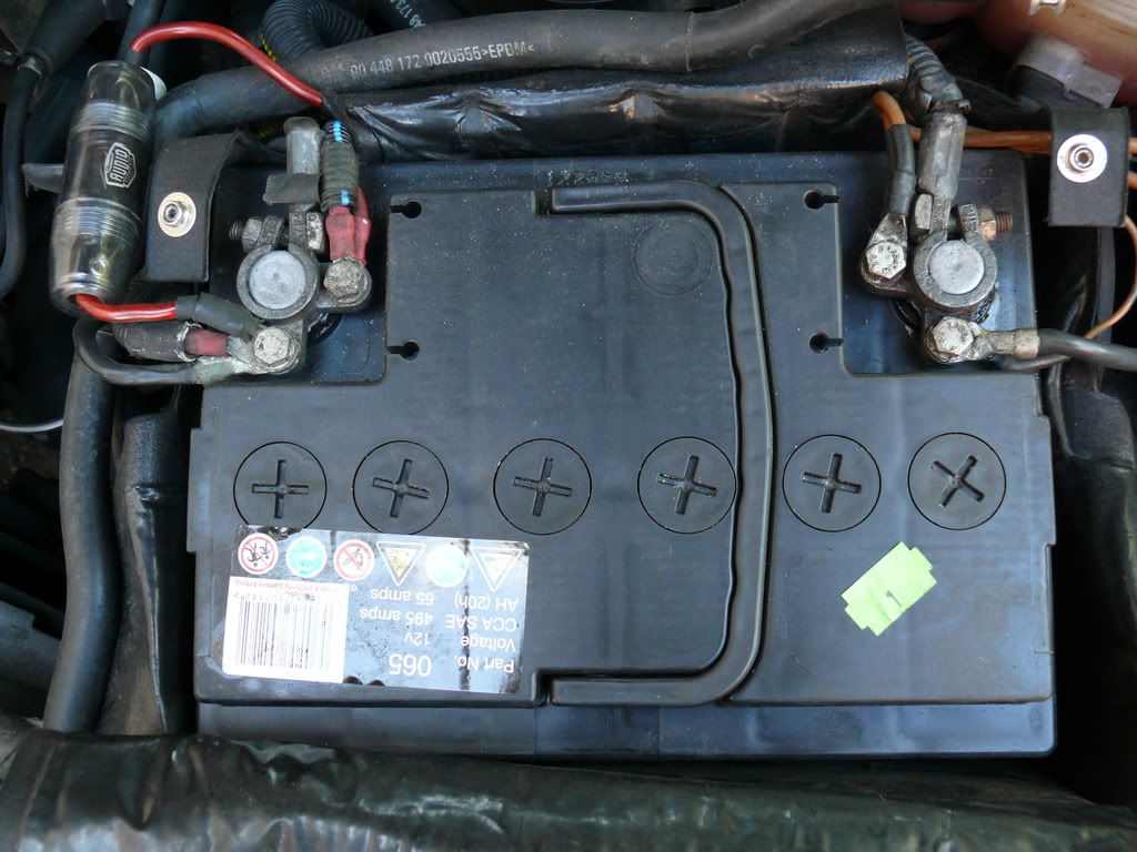

After a load of electricians decided that its too big a job to come out to (and since i cant move the car) we've had to take a proactive approach to car electrics :p
first off i tried with the lead off which we thought might have had to go to -ve...
nothing happened, no lights on the dash etc etc.
secondly i tried with it back on positive and only turning the ignition to on...
lights back on...
thirdly i tried with it at negative for a short amount of time...
nothing again.
back to +ve lights back on.
Now the armoured cables must be positive so that means that the wiring we tried must have been correct in the first place.
After a good look around there doesn't seem to be any burnt wires or casing
now we know where the wires were meant to go i tried the starter again.
The lights on the dash dimmed again which means the ignition switch is recognising the switch. However no solenoid click. After removing the altenator fan cowling (an absolute pain in the *** with the engine in...) I thought the earthing wire looked like it had exploded!

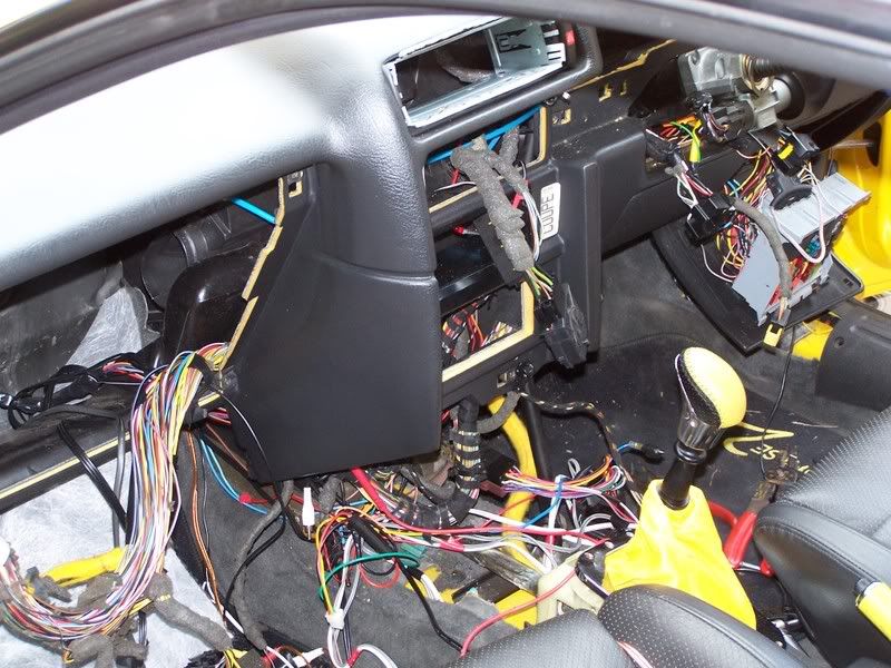

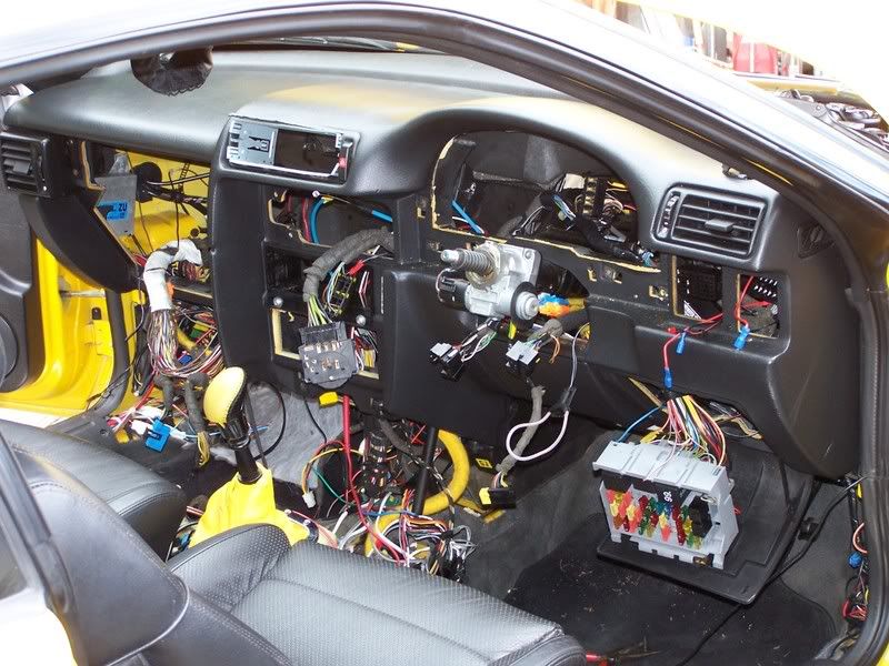

right! eventful day today and a little closer to getting it started!
First off i'd like to apologise for a very small amount of pictures today, it was a very packed day and the camera hardly came out.
First off I got the car on its temporary back wheels so the front could be raised for the investigation...
Well as you all know the key was turned a couple of weeks ago to no avail!
Today we tested the wiring on the car and found the wiring to the starter motor to be fine! This meant a dodgy starter / solenoid! Luckily i had a spare and after testing that we found it was fine.
