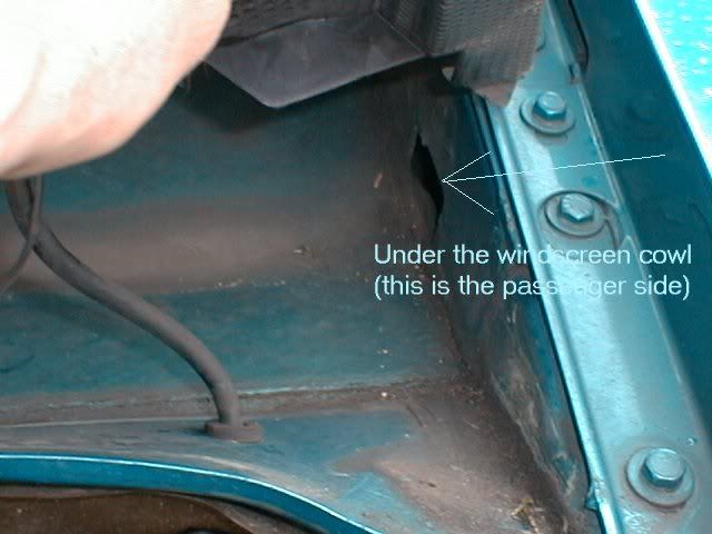

Try this drain hole under the scuttle panel it maybe from here

Sorry to hijack this, but the drain hole under the scuttle, how does that let water in the inside? I thought it should drain away outside the body, down the inner wing?
Just that my drivers side gets very wet, but under the carpet....my 1st thoughts were the seal on the blower cowl letting water in?

the drains (there is also the elephant trunk thingy) if they are blcoked will mean the water wont drain away, and then it will be able to get over the small lip around the heater blower and leak inside

Fraz wrote:the drains (there is also the elephant trunk thingy) if they are blocked will mean the water wont drain away, and then it will be able to get over the small lip around the heater blower and leak inside
Cheers....but how do you know if the holes at the side of the scuttles (as in the pic) are blocked?, or is it just that if the actual hole is blocked then its blocked?
The seal can also go on the heater blower lip too, i had that go on one of my old cavs!
