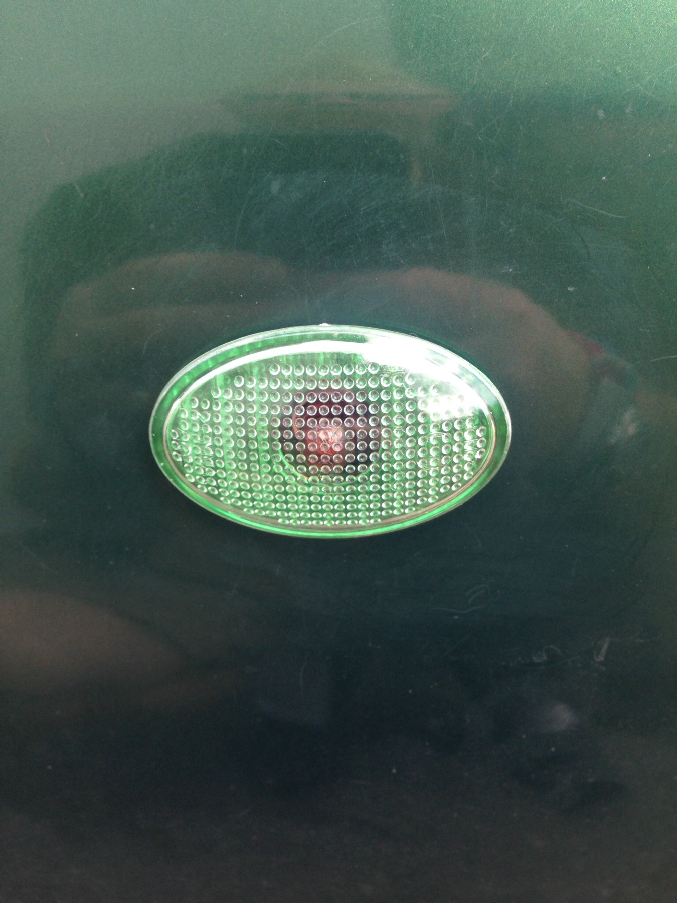

by brianakanishin » Mon Jul 03, 2017 1:57 pm
It wasn't such a hard job after all. And for £3.50 they don't look too bad considering my car has no custom parts and is rather tatty these days.

That looks good. Well done. Isn't there a connection plug on the inside of the wing to unplug the repeater?

by Cliff » Mon Jul 03, 2017 8:12 pm
Nope, that would have been smart design - but seriously, it's wired direct to harness which makes no sense!

by brianakanishin » Mon Jul 03, 2017 9:50 pm
I dug out the gunk from the original unit to give me a few more mm of wiring to work with. Doing this removed the necessity to crimp on some extra cable to make it easier to work with fat fingers.
