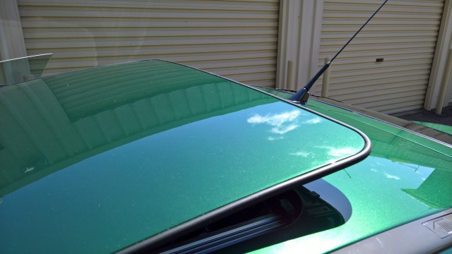

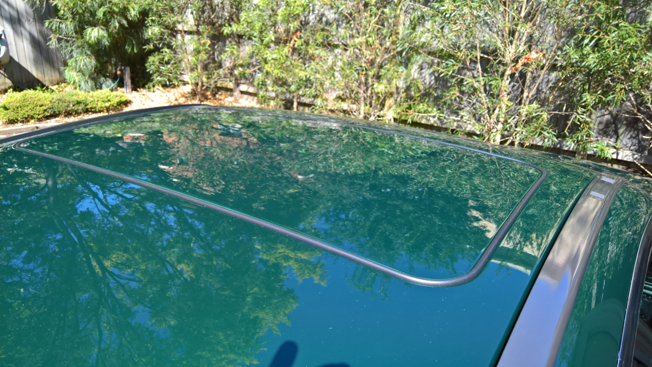

by cal16v » Fri Mar 31, 2017 6:07 am
Sunroof rubber...

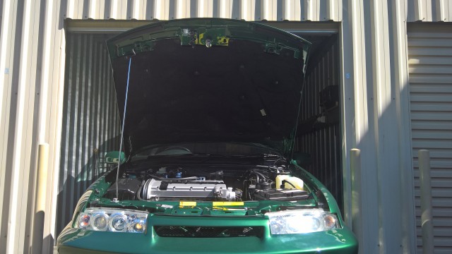

by cal16v » Sat Apr 01, 2017 2:26 am
Under bonnet lining...
