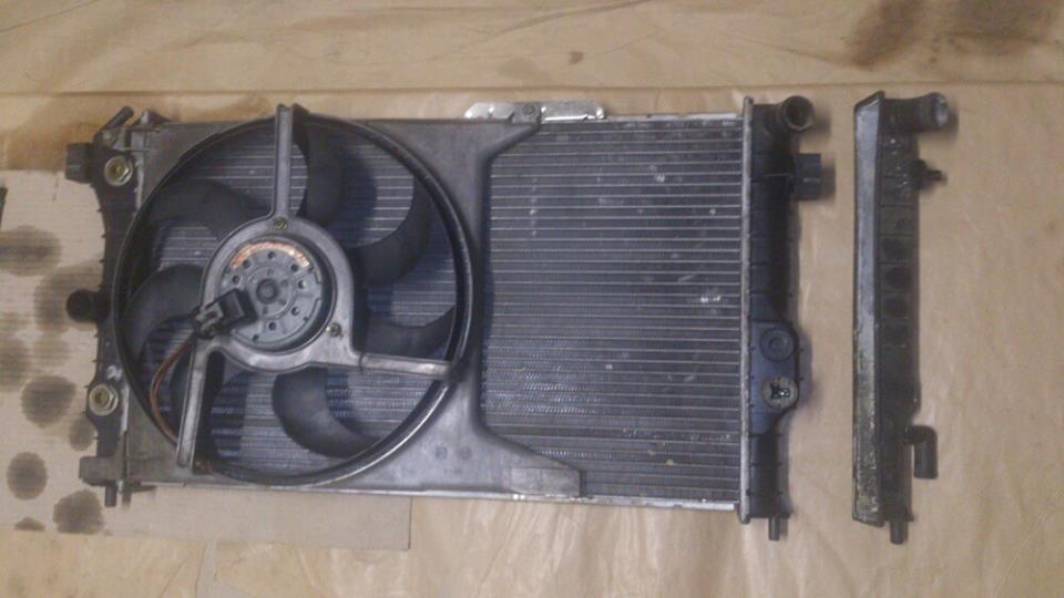

Installing new rad today , unfortunately new rad is useless as it doesn't have the connections on it for the pipe work for the secondary water pump

Body Kit fitted
by Teejay » Sat Nov 23, 2013 2:46 pm
Unless suppliers have an alternative, I'm looking at a recore

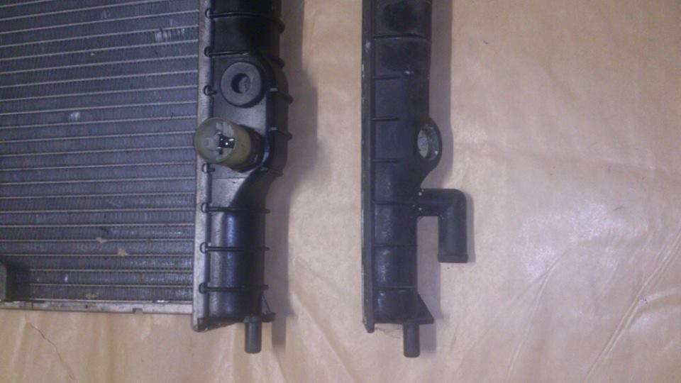

Re: Body Kit fitted
by EddeyDancer » Sat Nov 23, 2013 2:59 pm
You can swap the side tanks over...
A mate recently had this same issue...
I sent him over the side tank, with the 'Aux Water Pump' fitting...
He heated it up in the oven, in order to fit in back onto the Radiator Core...
Also, I once scored a Radiator off a V6 that didn't even have a fitting for the Aux Water Pump...
It being so cold over there in UK, perhaps it might not be so necessary to have the AWP connected...

Re: Body Kit fitted
by Teejay » Sat Nov 23, 2013 3:11 pm
Hmmm, might give that a try

Re: Body Kit fitted
by Teejay » Sat Nov 23, 2013 10:33 pm
v6 steve wrote:couldnt you just cut it in ?
Eh?
Rad is breached, needs a recore
Managed to get the rad out, also removed the a/c rad as surplus to requirements as a/c is disconnected
