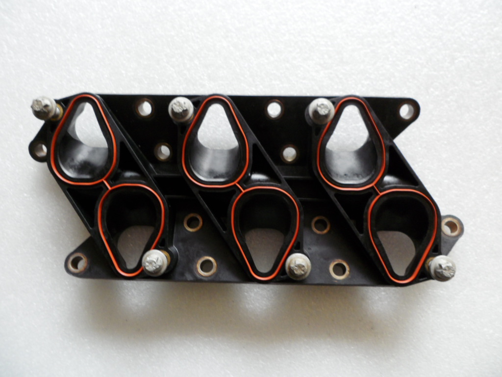

THE THREE INLET MANIFOLDS
Lower Inlet Manifold - Upgraded 3.0 Vectra Part
Centre Inlet Manifold - Replace with Cleaned Part
Upper Inlet Manifold - The Engine gets some Bling!!!
I spent a few hours cleaning up these Manifolds, in preparation for this Phase!
THEY ARE NOW ALL READY TO GO!!!

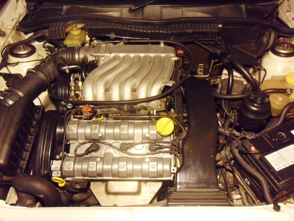

ENGINE PHASE: ACTIVITY UPDATE
I got right into completing the 'ENGINE PHASE' last night, and I actually did pretty well...
I was hoping to fit the New 'Thermostat Extension Pipe' without having to remove the Radiator, but that's not happening... :cry:
Anyway, I decided to use an Old Pipe that has a Broken Tab, just so I can fit the rest of the Engine Parts back on and get it started...
As the Radiator will have to come off when I fit the New Condensor and the Lower Temp Radiator Fan Switch, I decided to wait till then
and do them all at once, but who know's what will happen in the next week or so... I might change my mind, if I feel motivated...
But it certainly started up with a 'ROAR' so I'm very keen to see what impact, the new parts will have... :shock:
Just the New Condensor, New Radiator Fan Switch and the New Thermostat Extension Pipe to be fitted now...
