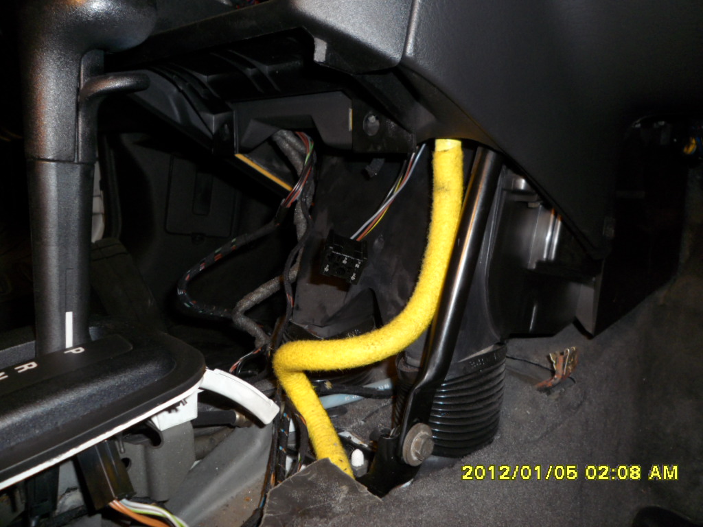

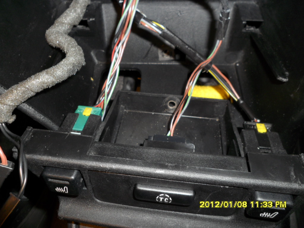

EddeyDancer wrote:This Job has probably been one of the trickiest so far...

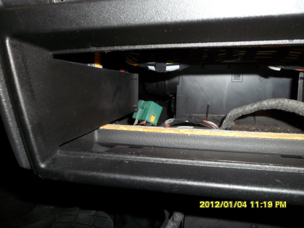

I located the Green Plug fairly easily, but the Black Plug was a real mission...
The Green plug was tucked away to the left, and the Black plug was well hidden to the right...
It was like working blind folded being that You have to feel what's going on, as you can't see anything...

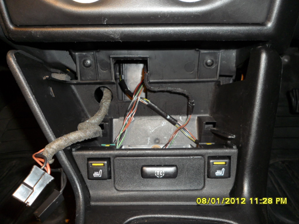

I eventually located the all the wiring and connected it all up, but the ashtray doesn't fit back in properly...
I think that the extra wiring that's now at the rear, is the cause of this...
Did anyone else have such issues???

1 - I disconnected and removed the insecurely fitted ashtray, to gain access to the wiring

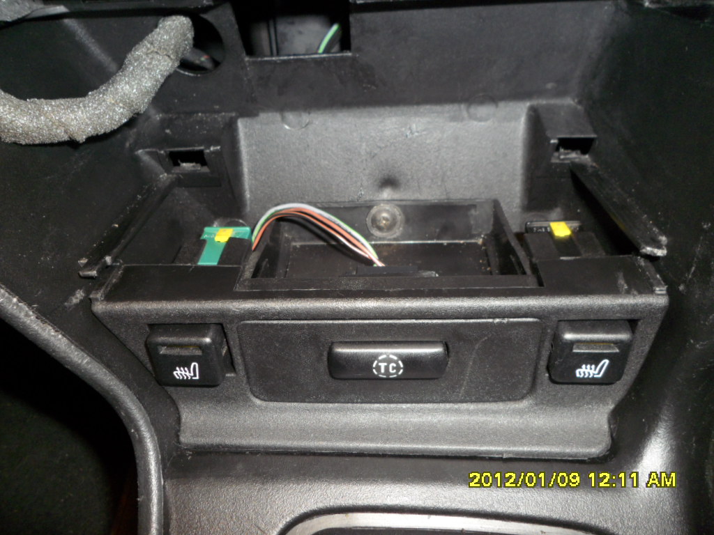

2 - I disconnected the TC and Heated Seat plugs, and then removed their housing
3 - I identified the locations of where the wiring was to be re-routed
4 - Using some basic fishing skills, I was able to thread the wiring through the correct cavities
5 - I then connected up the TC and Heated Seat plugs, and re-fitted their housing
6 - Finally I connected up the ashtray wiring, and easily slotted the ashtray securely into it's position

So in conclusion to this job, the real pest was locating and releasing the Black plug!!! :evil:

Re: heated seats
by Fraz » Sun Jan 08, 2012 7:52 pm
there you go ...thats what I meant when I said it came through the bottom part ....looks a lot better now

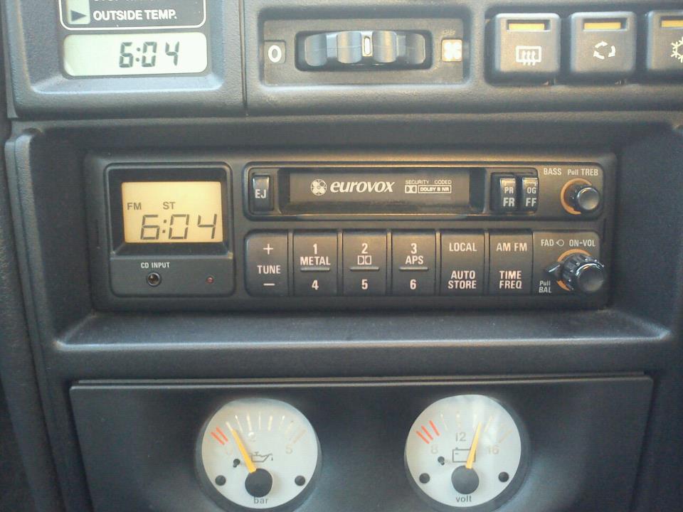

NEXT JOB: Replacing the Eurovox... :bazooka:
