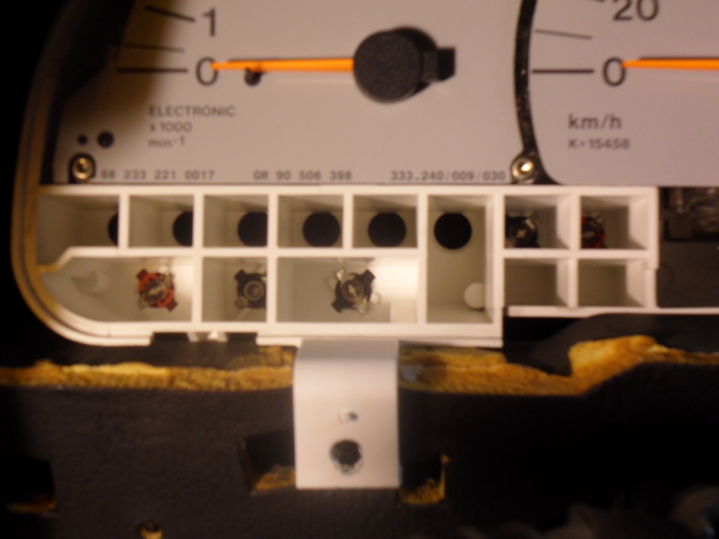

Apart from putting LED's in the Dash Dials...
I also put a few LED's in the 'Most Commonly Used' sections, so that I won't have to change them later on!
For some reason the Air Bag, TC and ABS lights stayed on for Me, when I fitted LED bulbs in them sections!
So I put the Standard Bulbs back in, and they were working normal again...

LED's in INSTRUMENT PANEL SECTIONS
I also suggest to use Coloured LED's for example...
GREEN: for Indicator Section
BLUE: for High Beam Section
YELLOW: For EML and 'S' Sections
RED: For Handbrake, Oil & Low Fuel Sections
NOTE: ABS, TC & Air Bag Sections didn't like the LED's in them...
Perhaps the Bulb wasn't suitable, but I did try are few in there!
