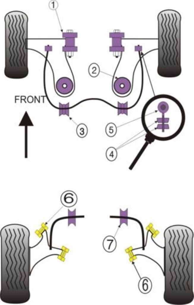

by craigyboy » Sat Nov 12, 2011 3:25 pm
can anyone explain to me where the front anti roll bar
eye bolt bush goes,as i got the front set of bushes
today and the diagram ive got is not very clear. A
photograph would be appreciated,thanks
Re: Front bushes
by leelee » Sat Nov 12, 2011 4:53 pm
Well the front anti roll bar bushes are on the subframe mate
Posts: 492
Location: lakenheath suffolk
Re: Front bushes
by craigyboy » Sat Nov 12, 2011 6:15 pm
Ive got them mate but these other bushes
say on th pack front anti roll bar eye bolt bush
Re: Front bushes
by leelee » Sat Nov 12, 2011 6:37 pm
Ok craig if you are on about number five.these were for the early calibras and cavaliers which had a different anti roll bar link to yours mate

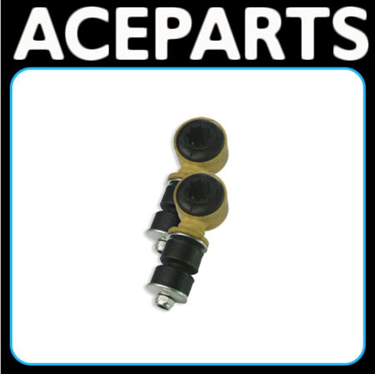

Re: Front bushes
by leelee » Sat Nov 12, 2011 6:50 pm
Here is a pic of the older type of anti roll bar link.if i remember i use to hate fittting these god they were a tight fit.
Posts: 492
Re: Front bushes
by craigyboy » Sat Nov 12, 2011 6:56 pm
Thanks alot for that mate,i was pulling my
hair out trying to think how they were going
to fit.i'll send them back for a refund
