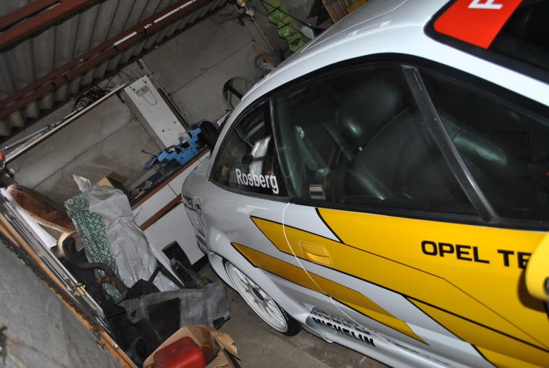

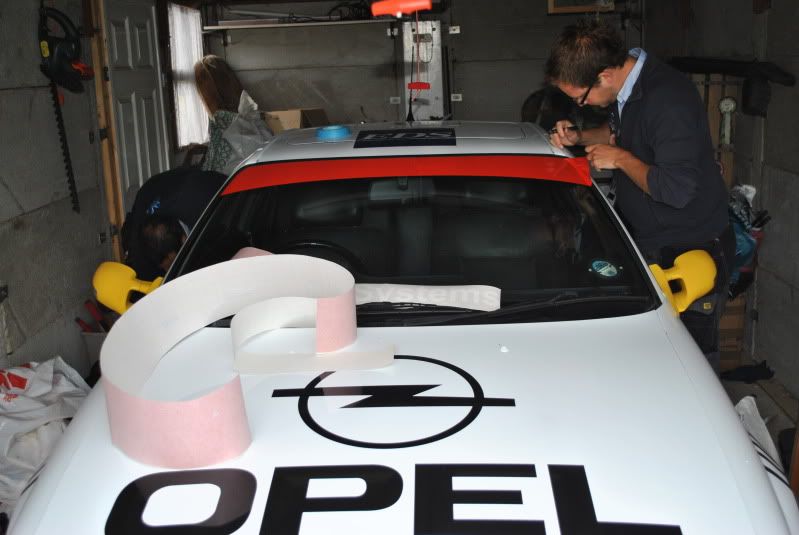

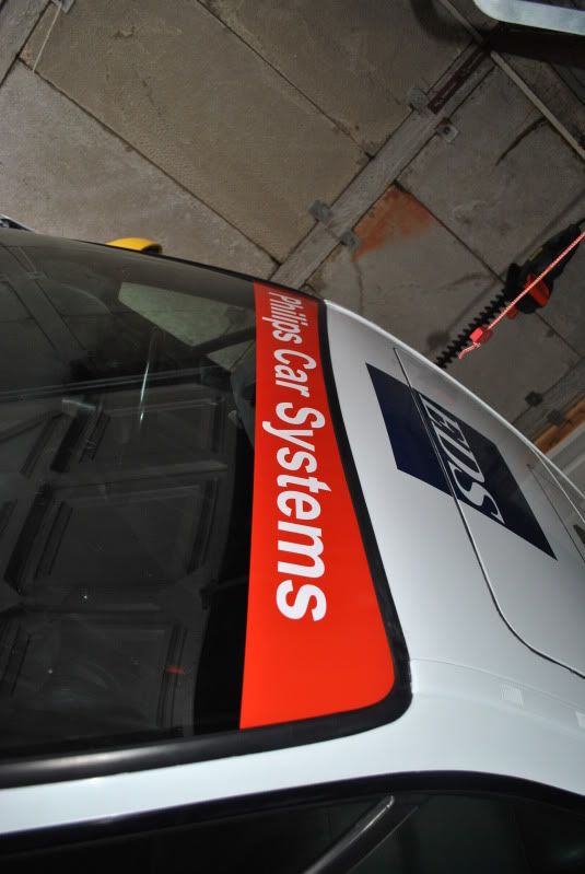

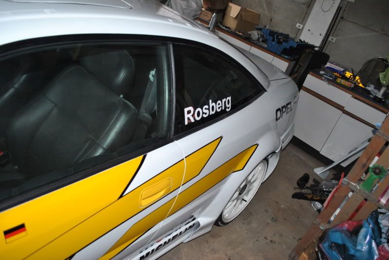

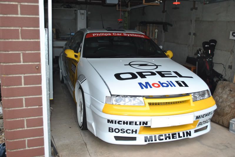

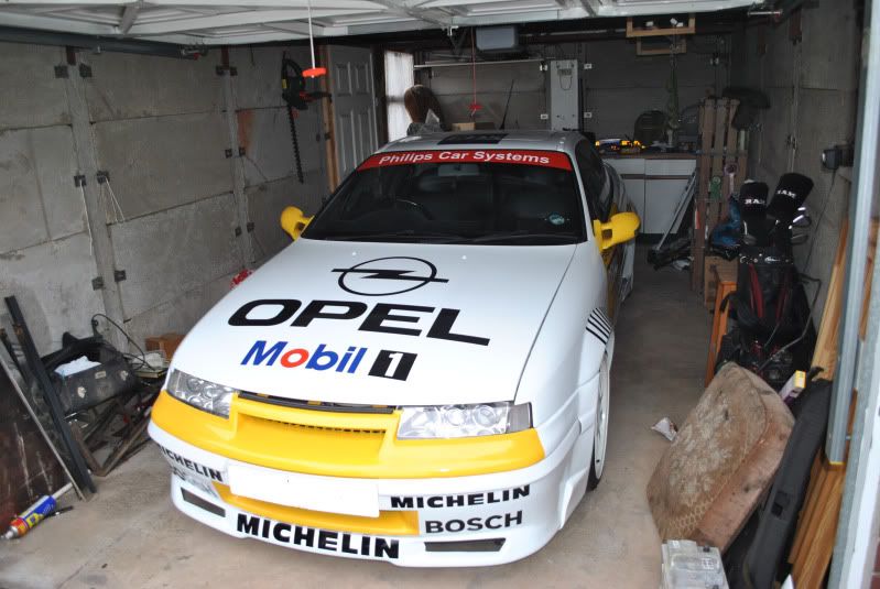

An early morning update for you all from the warmth of my early morning coffee.
The guys from AR signs turned up again and fitted the sunstrip and the rear window names...
not far to go now!
