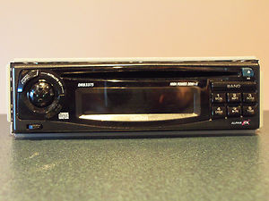

I'm trying to match up the wiring, for a Clarion Head Unit...
I bought an ISO Adapter, but it's not totally identical wiring...
The 2 x Green, White, Grey and Purple wires are a match...
The ISO Plug has Yellow, Blue, Red, Orange and Black...
The Stereo wiring has Yellow, Blue, Red and Black...
Any suggestions on which goes to what?
Much Appreciated...
Much Appreciated...

what model of clarion is it ?
Re: Wiring Up an Aftermarket Head Unit
Fraz wrote:what model of clarion is it ?
DRB3375
http://www.ebay.com.au/itm/Clarion-Car- ... _711wt_956
- Attachments
- clarion.jpg (15.66 KiB) Viewed 35863 times
