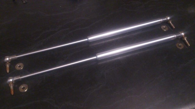

I've just brought a set of bonnet lifters off eBay, had anybody got any pictures of how these are fitted please?

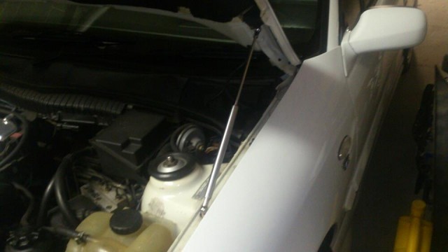

Undo one bolt from the hinges on the bonnet (the one closest to the windscreen) and undo a bolt about half down the front guard ( i think you call them wings in the UK)

Rob-se9 wrote: Has anybody got any pictures, of how these are fitted please?
YES...
Also for the benefit of others, who in the future, may want to know...
