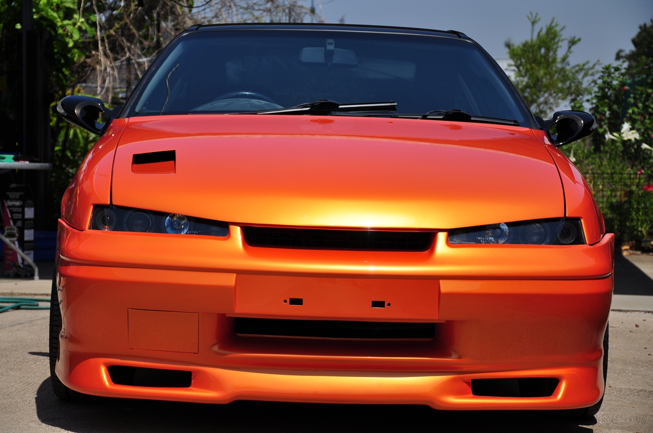

I had one welded one.
The fibreglass one I purchased seemed very flimsy, and when test fitted we almost broke it.
Can get the angle you want exactly too ;)
