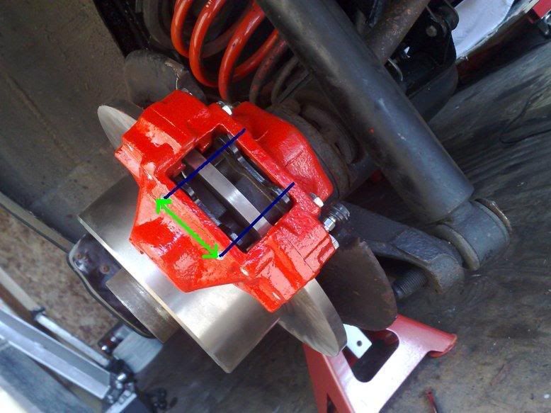

Ordered some exchange calipers from Autovaux several weeks ago. First off they sent a set of calipers one of which looked like it must of been sat on a car rusting for years and was badly damaged. Autovaux agreed to replace it and sent another one out but when I went to fit it I noticed it had a different size piston. Autovaux again agreed to replace it but were a little confused as it had the same part number. The third they sent out was correct and after painting them both up I fitted them.
I ordered new pins and anti vibration clips (if thats what their called) from vauxhall and when fitting tonight I notice that the pin gap on one caliper is 46mm compared to the other which is 50mm. Neither the pads or anti vibration clips fit the 46mm gap.
I cant believe that vauxhall would make two exact calipers with different pins gaps. Im thinking rather than change the capier that I find out which car it is from and buy pads, clips to suit as I dont think autovaux would accept a red one back. It might be a pain in the future when ordering new pads though. Anyone know what it would be from?
This is effectively the wrong one.
Very annoyed and wished I had just used my existing ones now
