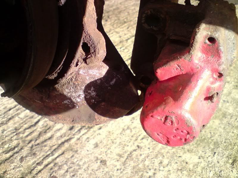

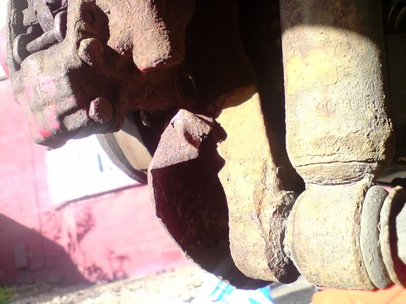

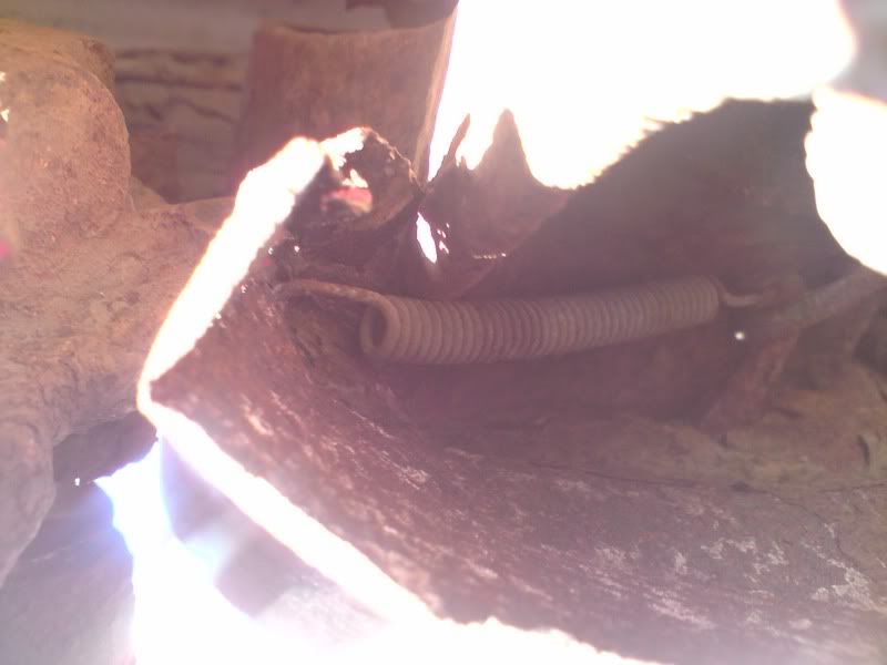

by Cali 16v » Wed Feb 06, 2008 4:13 pm
ok pictures
The plan is to make a bracket that goes from the bracket caliper holding bolt down to where the handbrake cable return spring fits on the backing plate, this should then hold it in place.

by truxx » Wed Feb 06, 2008 6:30 pm
So whats holding the brake shoe in place? cos in that pic it looks like there in the right place?

by Cali 16v » Wed Feb 06, 2008 6:58 pm
The brake shoes are fine, as is the disk pads bracket, it's purely the backing plate, you see where it has the spring fitted into it, the tension in the spring has caused it to fold over which means the handbrake can't be tightened.
so we have made a bracket the hold the spring and that should sort the problem.

by truxx » Wed Feb 06, 2008 7:09 pm
Oh right...
Well i didnt bother fitting the return springs back onto mine.(i was meant to but i forgot :) ) and mine works as it should.
but yeah i see what you mean now...looks like it should be an easy fix for ya.
