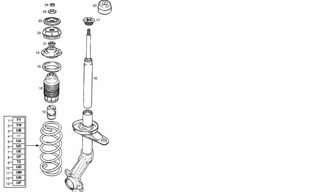

Here a pic of the assembly to assist..

I know this is old but what about the ring in 15? as its angled. The diagram is possibly indicating that the thicker end of the ring is inward and thiner part is hub side (if you get what I am saying) only because I need to check this on mine as I have a creek. (and because I have done work in that area)

Have you got a photo so that I can see? I know it's angled but it's difficult to see when the spring is compressed (in spring compressor) If I remember right it has tabs which line up with holes on the strut too?

It's not random.
I have done work in that area but for the record it would be nice to have a diagram.
The Haynes manual is pretty vague on this with its 2d imagery.
I know the spring locks up against a metal tab in the tray. So as long as that is lined up it should be fairly easy to get the rubber in the right place too. But like I say, nothing better than a picture.
