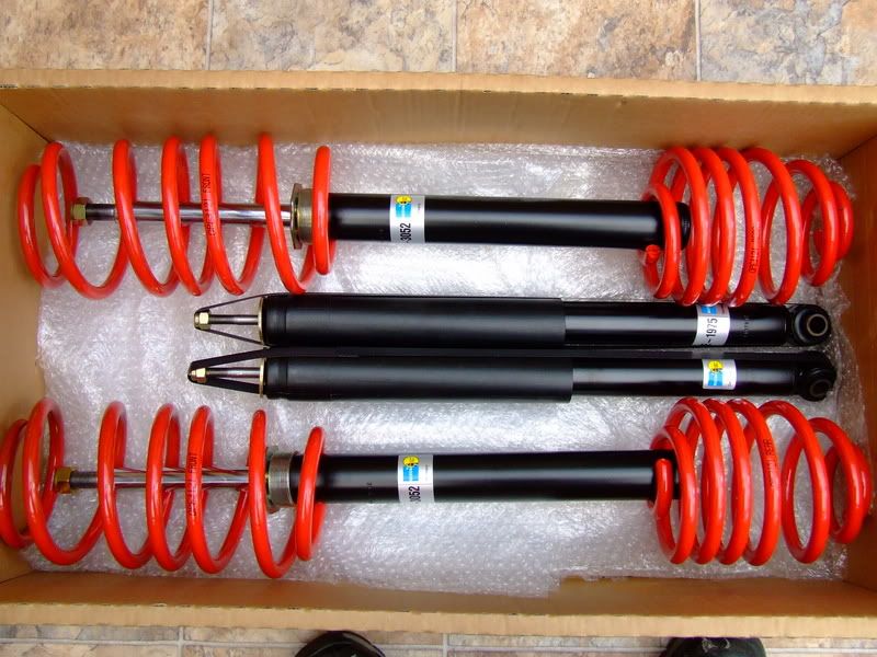

The springs don't look right to me either ?? See pics below.......... Pics taken with the car empty & on level ground.

wow !! was they like that when you fitted them, have you noticed the car drop since fitting them, are both sides like that ???
i would jack the car up and see if the spring spreads and then remove the shock and push that down and see if that is coming back out properly
deffentutly take back to where you bought them from and ask advice they may not be able to refund you or replace but it has too be worth askin you never know you might get them on a really good day lol

The spring coils were quite close to each other whem I first fitted them; both sides are the same.
This is a -35mm kit for the V6.
I have checked on the Bilstein website, the part no's for the shocks are recognised as being for the V6, the no's on the springs do not appear on their listing ??
Springs are marked - OPE3121
Front shocks are marked - PNE-3052
Rear shocks are marked - BNE-1975
I have tried the springs both ways; but it has the same effect !!
The springs should support the weight of the car without the shocks fitted, but these don't !!
As you can appreciate the rear of the car is solid now with no suspension travel !!; strangely the passenger side shock is the one that is 'misting' oil ?? - I do not carry passengers 'nor have I had anything heavy in the car.
I have sent Bilstein an e-mail via their website explaining the problem, so I will see if they respond.

The shocks are correct, but them springs dont look right ..coils are way to close togather ...I suspect you have a 60mm lowering kit
Bilstein dont actually make springs thus you wont find them listed on the website it will be springs from some other supplier. What is the part number of the actual kit?

those springs look very similar to a suspension set i used earlyer this year, for all of about 6 weeks.
the writing on the springs look identical to the Gmax springs i had, also having the same compact spring coils which is the issue you have, was a susposed 40mm drop. when full kit was fitted more like a 60 mm drop.
could be wrong, but the set i had came off set em back. got a refund

I have checked the part no's on the springs; these are made by Ventura Spring Company - these are -35mm springs for the V6 !!

It was dry today !! so the rear springs have been changed !!!
This is the old spring against the new one.......
Here is the new spring fitted...............
What a difference; the ride height is virtually the same, the car feels so much different to drive.
At least now I have got some compression at the back.
I stood on one of the old springs & was able to nearly compress it fully !!! Tried it with the new one & it hardly moved. So I think the old springs have gone 'soft'.
