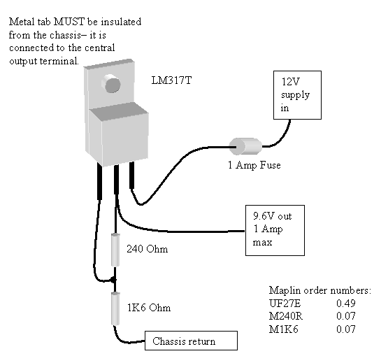

How much current does it take? An adjustable three-terminal regulator such as the LM317 is your ideal solution if it takes less than 1 Amp. You'll also have to be handy with a soldering iron and wire it up with a couple if resistors to set the output volts to 10.
<a href="http://www.fairchildsemi.com/ds/LM/LM317.pdf" target="_blank">http://www.fairchildsemi.com/ds/LM/LM317.pdf</a>
R1=180 Ohms, R2=1K2 Ohms in fig. 5 (page 4) gives 9.6 volts if my sums are right.

[img]/wink.gif[/img] Not a problem with a voltage regulator like the LM317. It can handle up to 37 Volts at the input, the typical maximum will be around 14.4 Volts.
I know alot of people solve this sort of problem by using an "mains invertor" - but its a terribly inneficient and expensive way to do it. First you use a big beefy chunk of electronics to transform 12V to 240V, then have to use another transformer to drop it back to the particular low voltage required.
OK, so the obvious attraction is you that you can easily buy an invertor and use the transformer that came with the gadget - but a little bit of ingenuity can provide a much neater and cheaper solution - the LM317T is 49p from Maplin...

OK, here's how you'd hook it up:
Becasue the metal tab of the device is internally connected to the output terminal, resist the temptation to screw it to any metalwork! I would bolt it to a peice of aluminium about 4 cm square (to dissipate a little bit of heat it will generate) and fix that to a plastic panel somewhere.
The resistors and connecting wires could be soldered on as shown in the drawing and (taking care that nothing shorts beforehand) can be insulated by covering the whole lot with hot-melt glue (or silicone sealer).
Before sealing up though, I'd test it by connecting a small 12V lamp (5 Watt sidelight or similar) as a load to the output, and measure the volts across it... 9.6 or thereabouts. This is close enough to 10, and gives you a little safety margin.
(oh, I changed both resistor values up a bit to meet the minimum values suggested by the datasheet. Same ratio though.)

The trouble with 5 Volts instead of 10, is that you are going to nearly double the heat disspation. Depending on the current drawn, it may be asking too much of this type of regulator. Of course a big enough heat sink might be able to overcome the problem...
Say you draw 1 Amp at 5 Volts, and the altenator is charging the car battery at 15 Volts (a sort of worst-case figure) then the regulator is dropping 10 Volts across itself at 1 Amp. This makes 10 Watts which is alot of Watts in a tiny object. Do you know how much current your docking station requires?
As for switches - scrap heaps might be your friend!
