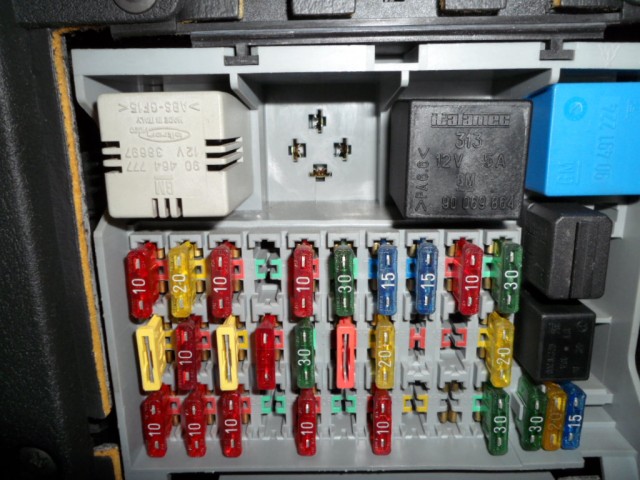

by EddeyDancer » Sun Jan 22, 2012 1:07 am
Indicator Relay is probably the first thing I'd check...
Pull it out (as shown in photo) and inspect the 3 pins for any abnormal signs...
Get hold of another Relay to Test for Relay failure...
