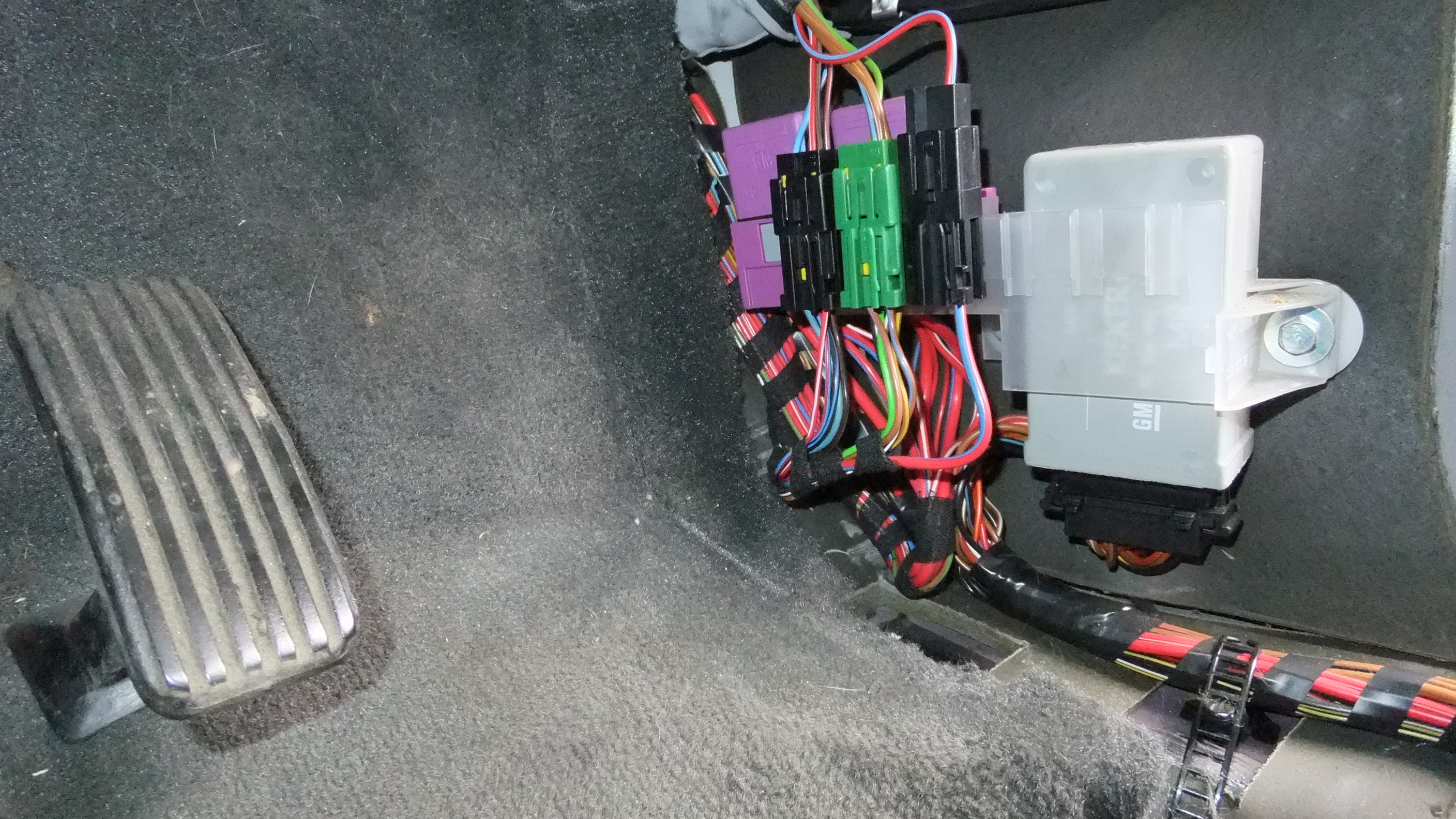

Re: Remote Central Locking conversion.
Hi
See attached picture of view behind the kick panel. I am a little concerned that it does not match the picture you posted, the one taken from the Haynes manual. Does it match the layout on your Calibra, do you know the function of the purple coloured unit on the left hand side of the picture. Is there any doubt that the white unit is the central locking control unit. If I take the connector off the white unit and the central locking stops working, I guess that would confirm it is the central locking control unit.
Regards
Regards
- Gold Member
- Posts: 132
- Joined: Fri Mar 19, 2004 1:00 pm
Hi - that's definitely it - there's at least two models of locking ECU - they are wired the same though and serve the same function - just different manufacturer.
The wires you're looking for are connected to that plug that is plugged in the bottom of the Whiteish grey unit on the right. Ignore the other connectors.
