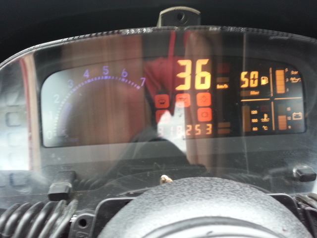

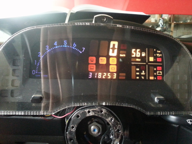

Hello everyone, I need some help wiring the vectra/cavalier 2000 lcd dash to calibra 16V (C20XE 1992., with check control), so far I have done a most of the work, but still have some issues with check control lights, oil pressure gauge, indicators lights....

The problem is that all check lights are ON, only the lights check light is OFF.
The other thing is the oil pressure, so it is not possible to use both, the digital dash and analog oil pressure gauge above the ash tray??
And the indicators light, left and right.
photos
Fraz, have you got any drawings or some link to find info? Thanks
