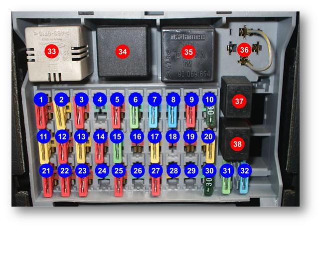

HELP!! My car is soooo cold!! I can't find the manual for my V6. I need help locating the fuse box so I can change the fuse for the heater fan (is it 30A??) also can someone tell me the exact postion of said fuse?? Thanks!!

Fuse list to be found in -
ClubCalibra.net Forum Index » Technical » General Technical
http://www.clubcalibra.net/viewtopic.php?t=28055
- Posts: 2357
- Joined: Sun Jan 11, 2004 1:00 pm
Fuse List
1. 10A - Parking and tail lights Left
2. 20A - Heated front seats, Cigarette lighter, Control Indicators
3. 10A - Main beam left
4. 30A - Heater fan (*1)
5. 10A - Dipped beam left, Headlamp range adjuster
6. 30A - Front/Rear Wipers
7. 15A - Turning signal lamps, brake lamps ABS
8. 15A - Courtesy lamp, Luggage compartment lamp, Hazard warning flasher, Dual info display, Radio, Trip computer
9. 10A - Instrument illumination, Number plate lamp, Traction control
10. 30A - Sunroof
11. 20A - Fuel pump
12. 10A - Electrically adjustable exterior mirror, Electrically operated door windows
13. 20A - Fog Lamps
14. 10A - ABS, Automatic transmission
15. 30A - Heated rear window, heated exterior mirrors
16. 10A - Automatic transmission
17. 20A - Central door locking system
18. 10A - (sweden Only) Daylight driving lamps
19. 10A - Four-wheel drive
20. 20A - Horn
21. 10A - Parking and tail lights Right
22. 10A - Reverse lamps, Dual info display, Trip computer, headlamp warning device
23. 10A - Main beam Right
24. 30A - Cooling fan (*1)
25. 10A - Dipped beam Right
26. - Blank
27. 10A - Fog tail lamp
28. 20A - Terminal 30: constant current for caravan/trailer
29. 30A - Healamp wash system
30. 30A - Electrically operated door windows
31 + 32. - Spare fuses

- Attachments
- Fuses.jpg (56.48 KiB) Viewed 5979 times
