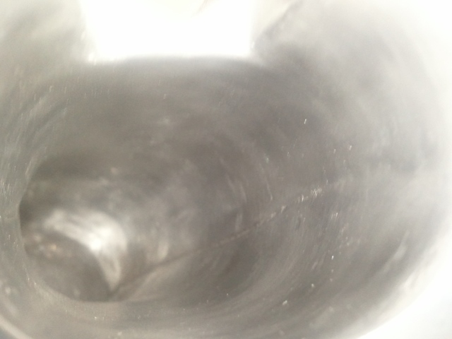

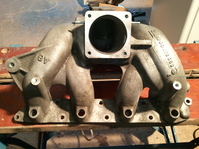

Recently I have ported and polished a four branch inlet manifold from an earlier Ecotec that has no EGR system (I plan to remove my EGR).
Here are some pics of the work I have been doing on the inlet manifold.

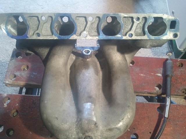

Here’s what I started off with
Marked up with engineers blue and in the process of enlarging and polishing
One of the ports after being enlarged, smoothed with a flap wheel then polished

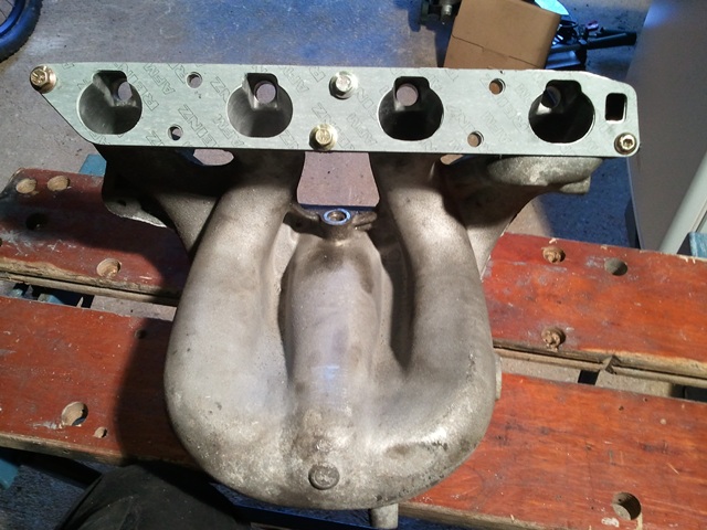

All the ports enlarged and polished
All finished and cleaned up think I will paint it before I put it on the car

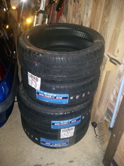

Got my new tyres delivered yesterday. Getting them fitted Saturday the she's booked in for an MOT next week then time to get her ready for the summer :)

Got the tyres fitted today. Next to get it booked in for an MOT.

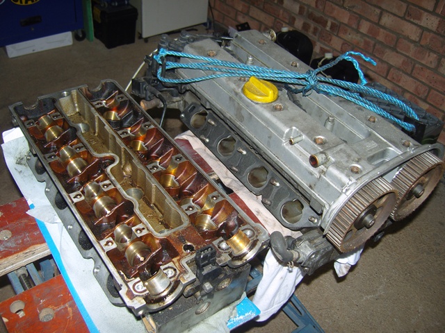

Heres couple of pics of the cylinder heads.
Will get them both stripped and see which is the better of the two.

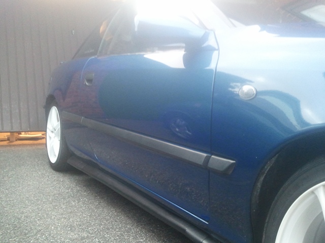

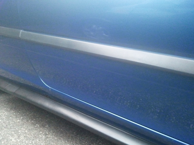

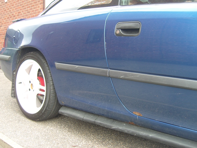

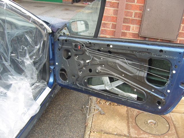

Thought I would start to get the rust sorted on my car this week. The drivers door has rusted/ rotted through ta the bottom and can't really be saved. I got a pair of doors from another Calibra last week that was being broken for spares. Got the drivers door off today (in between all the rain). Should get the new one back form the bodyshop tomorrow and then get it fitted before PVS hopefully.
I'm planning to get the sill and arch done between PVS and billing hopefully.

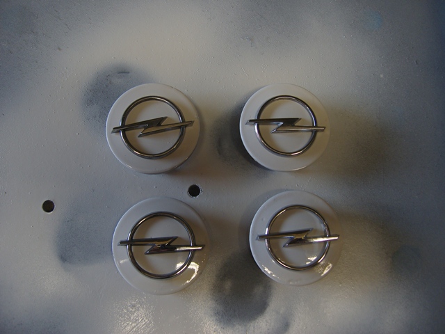

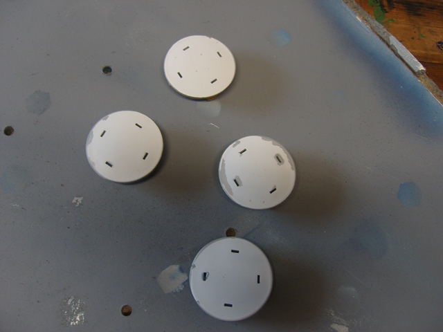

I also re-painted the center caps for the wheels today as they got chipped.

Got the door sprayed and put back on. I was up untill nearly midnight Saturday trying to get it on and lined up before PVS on Sunday. Still doesn't quite close properly but I will tweek it when the car goes into the bodyshop to have the rear quater and sill repaired and sprayed before billing.

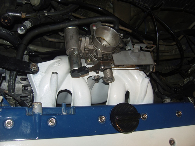

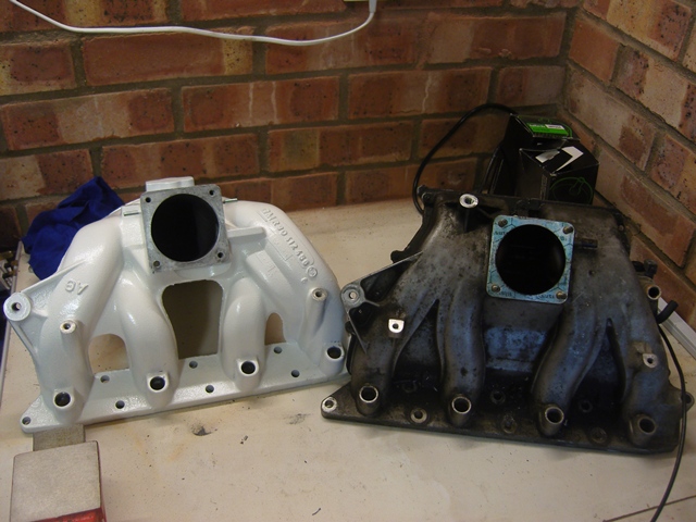

Now I've had the EGR system and secondary air injection system disabled with tech 2 I thought I would get the inlet manifold fitted.
Also getting the injectors ultrasonically cleaned new seals fitted and flow tested at work, I will fit them when I collect them from work tomorrow.
Masked and painted

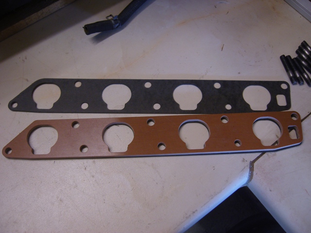

Ported and polished four branch one compared to the old restrictive one
Thermal phenolic gasket to help reduce heat transfer
