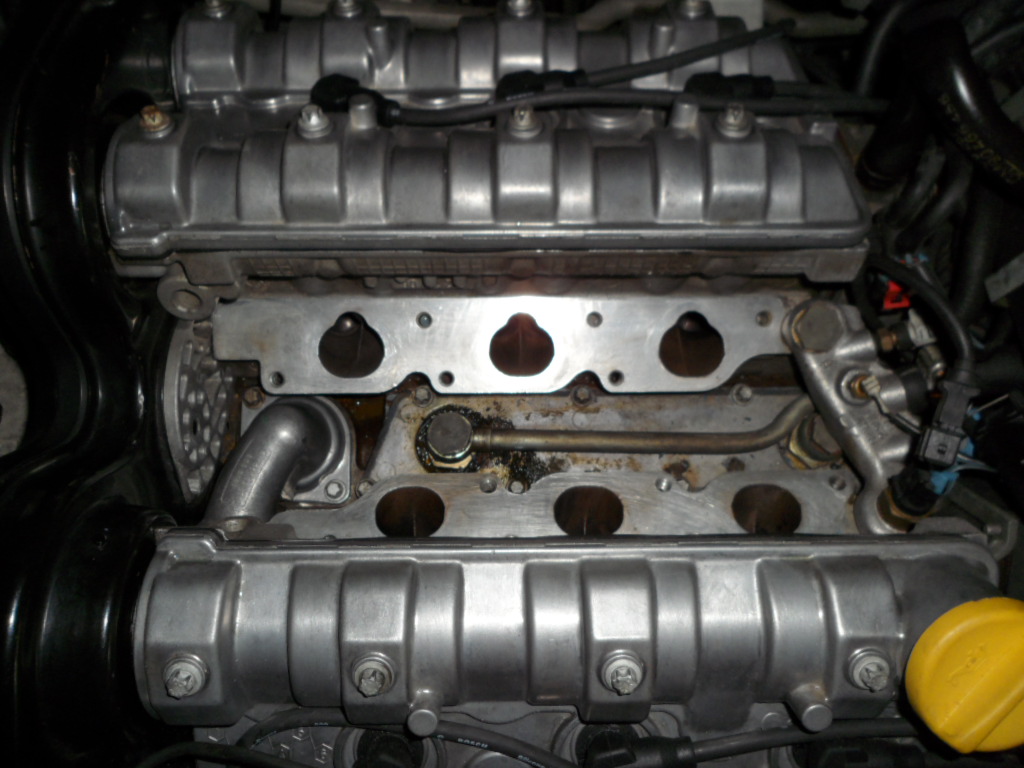

ENGINE PHASE DAY TWO:
I was off to a good start being that...
I Modified a Bolt, that eventually did secure the R1 Bracket... So Rear Cam Cover is now done!!!
I was also in luck being that the Local Mechanic lent me the Special Socket, and I was able to easily
remove the bolt that secures the Thermostat Extension Pipe...

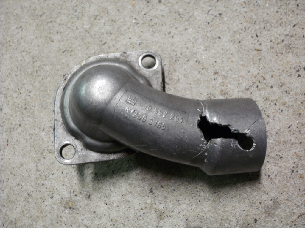

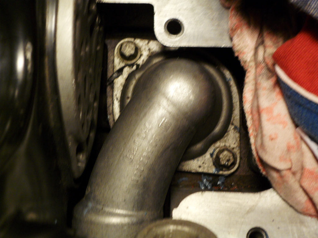

I then got to the 'Hard Part' of removing the Famous Pipe...
I spent a few Hours on this and yes, the Tab broke off...
So that's where I'm at right now!!!

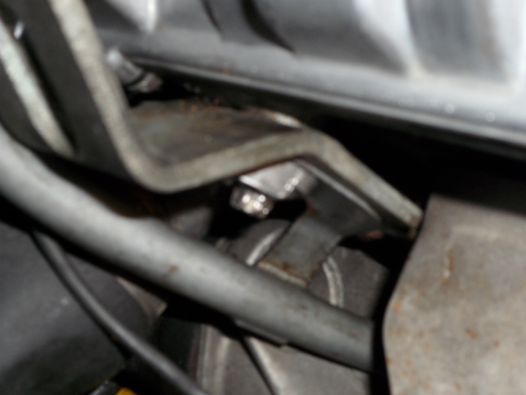

Re: Eddey's V6 Profile

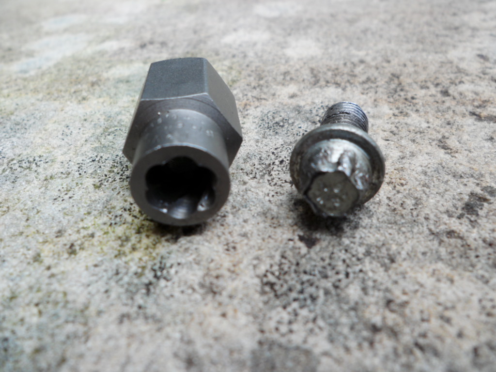

thought the bolt on that was a female torx and not an 8mm
v6 steve wrote:Your doing a great job mate keep at it
THANKS MATE...
Fraz wrote:thought the bolt on that was a female torx and not an 8mm
This is what stopped the Progress that day...

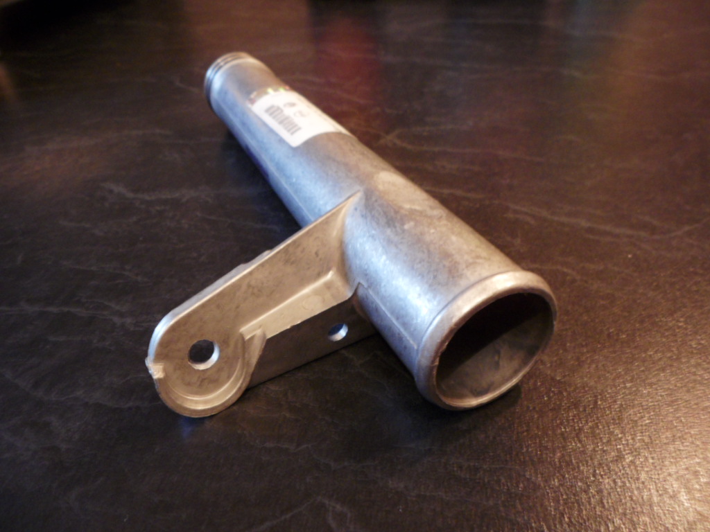

FINALLY...

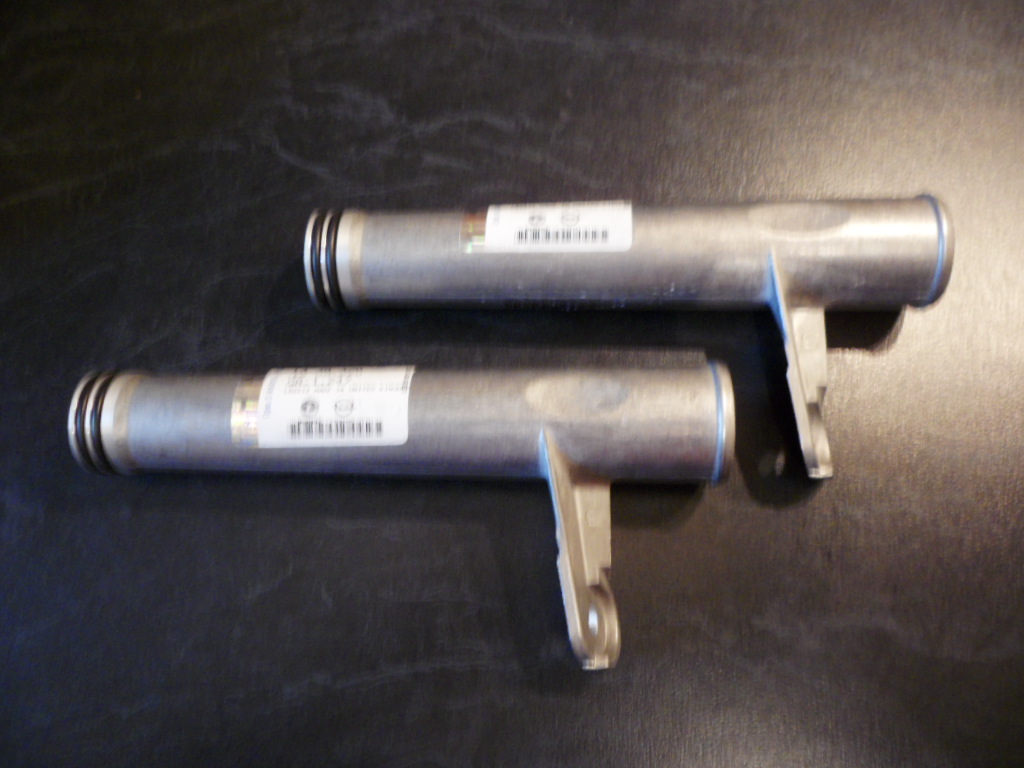

The 'V6 Thermostat Extension Pipes' arrived...
Ordered & Paid: 25 Jan 2012
Parts Delivered: 29 Feb 2012
5 weeks in total waiting time...
After all that time waiting, I can now get on with completing the Engine Phase!!!

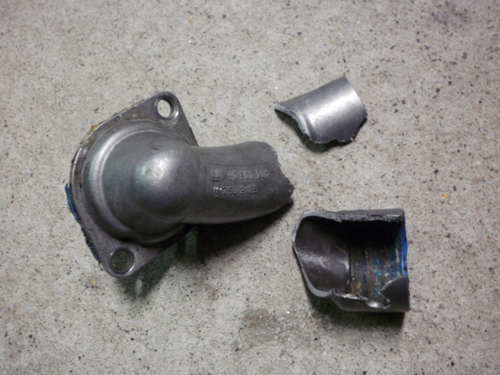

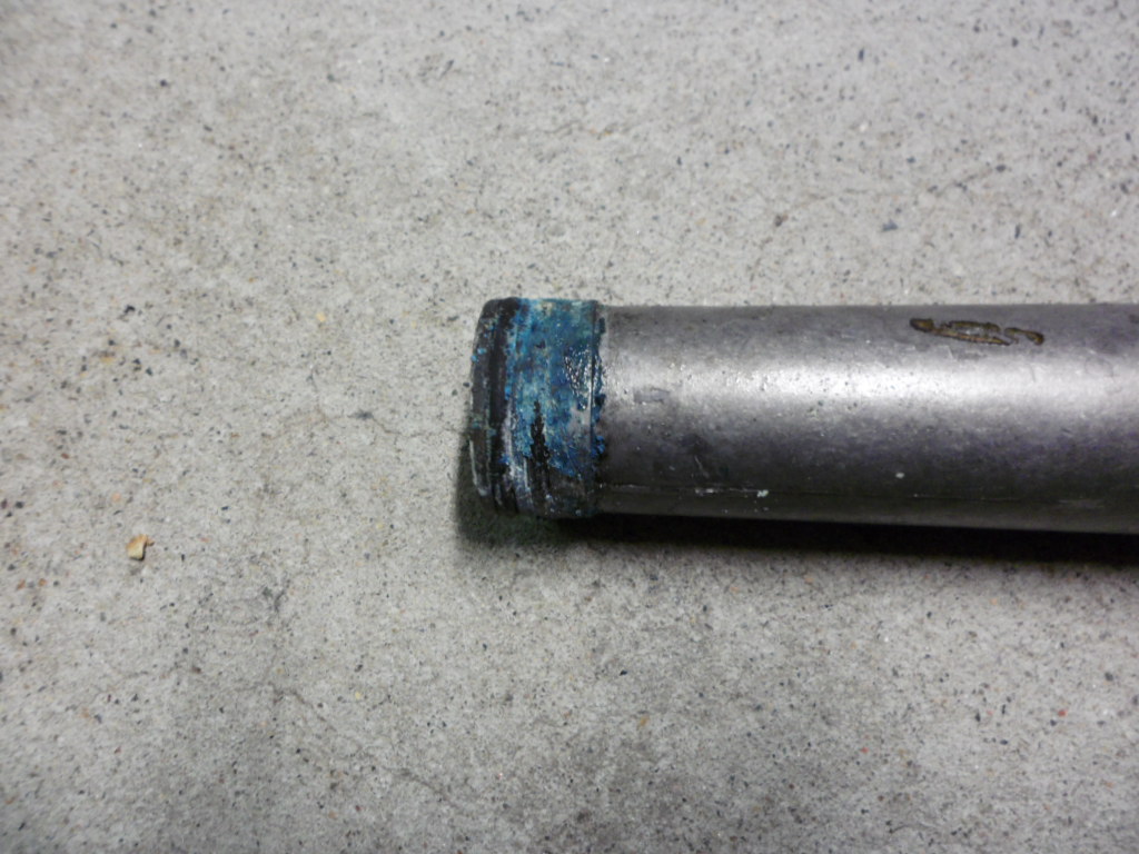

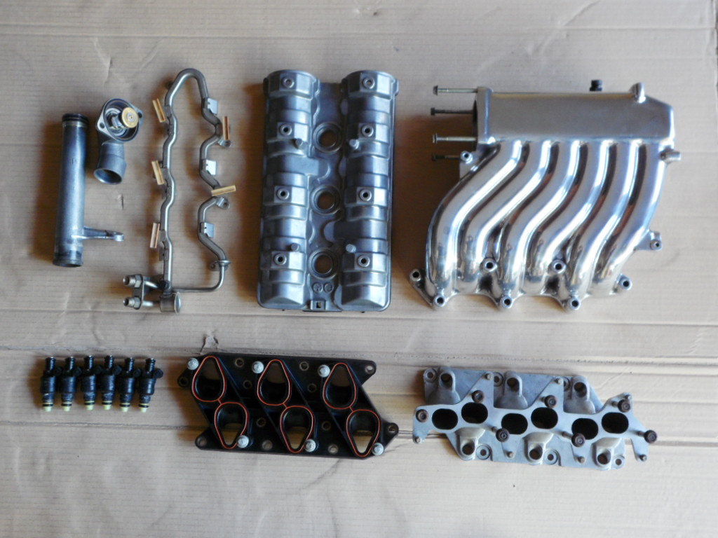

I actually made some progess today, in that I finally removed 'The Headache' Thermostat Extension Pipe!!!
The Extension Pipe was really corroded, and the only way to remove it, was to smash the Thermostat Housing...
I drilled a few holes into the Thermostat Housing, to weaken it... I then got out the Hammer and Chisel and went to work!!!

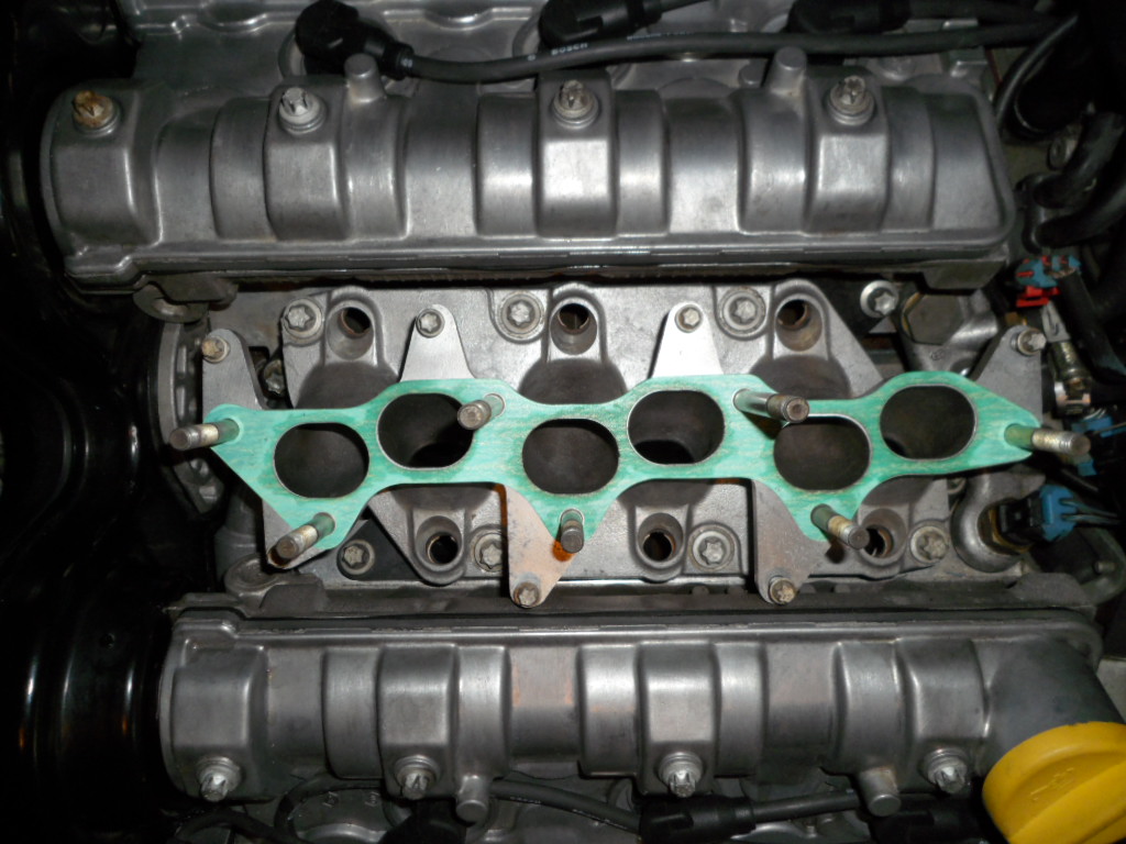

I got right into completing the 'ENGINE PHASE' last night, and I actually did pretty well...
I was hoping to fit the New 'Thermostat Extension Pipe' without having to remove the Radiator, but that's not happening...
Anyway, I decided to use an Old Pipe that has a Broken Tab, just so I can fit the rest of the Engine Parts back on and get it started...

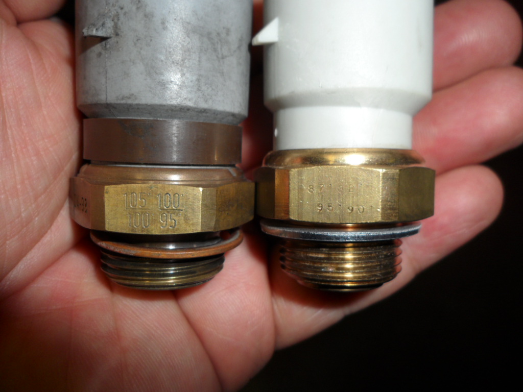

As the Radiator will have to come off when I fit the New Condensor and the Lower Temp Radiator Fan Switch, I decided to wait till then
and do them all at once, but who know's what will happen in the next week or so... I might change my mind, if I feel motivated...
But it certainly started up with a 'ROAR' so I'm very keen to see what impact, the new parts will have...
Just the New Condensor, New Radiator Fan Switch and the New Thermostat Extension Pipe to be fitted now...

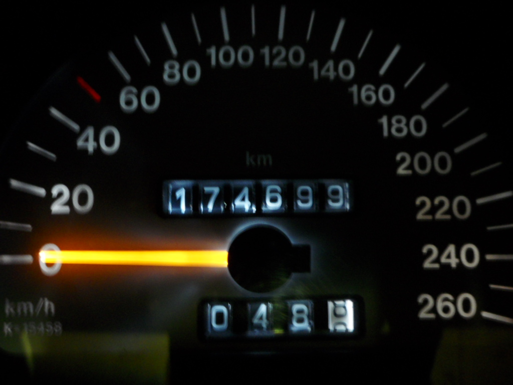

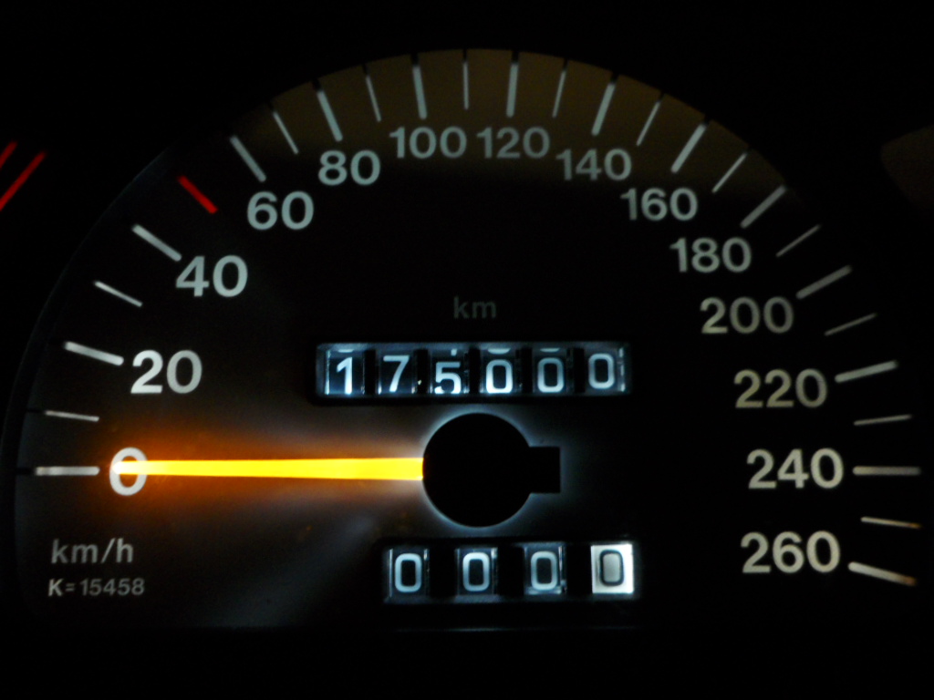

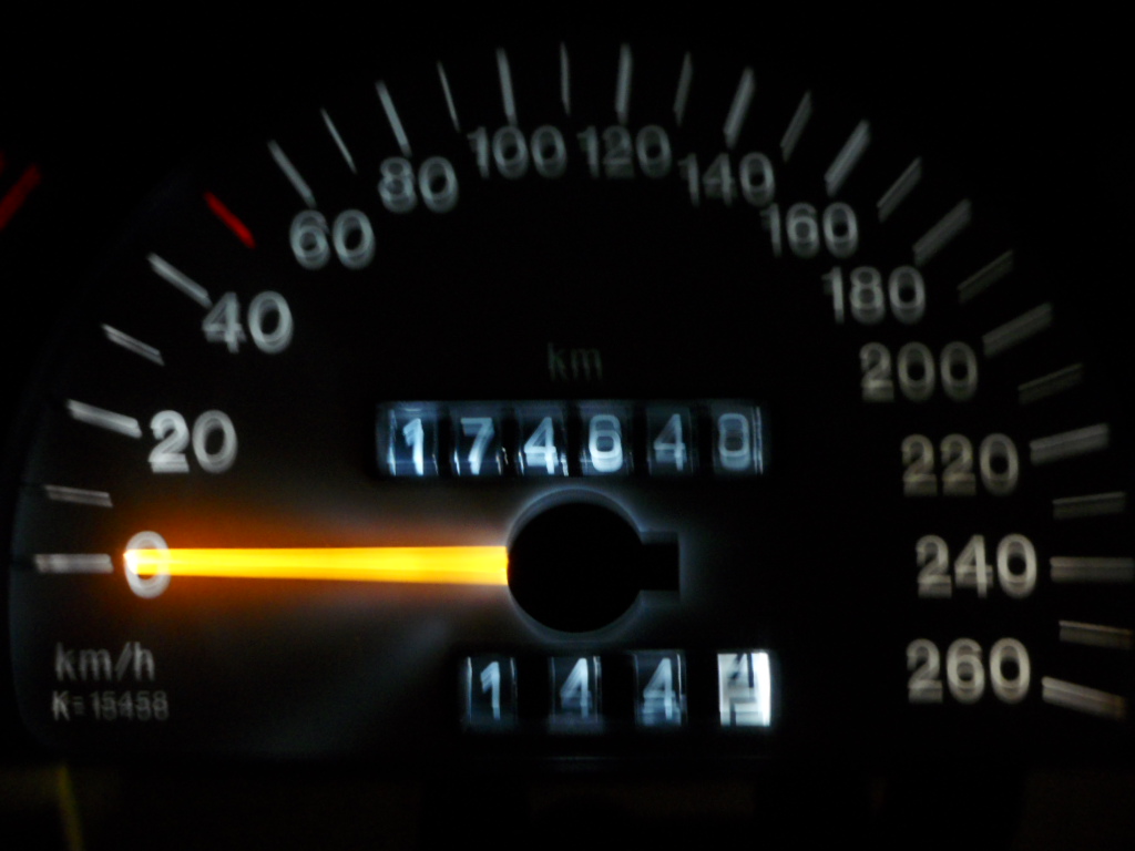

The GHOST hit 175,000 Km Last Night...
The results of the 'ENGINE PHASE UPGRADE' are certainly quite noticeable...
Mainly being that the Engine sounds 'Heaps Smoother' and the 'Throttle Response' has also improved...
I'll also monitor the Fuel Economy and the Spark Plus wells for Oil, over the next few weeks...

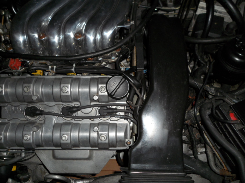

ACTIVITY UPDATE:
I'm Extremely Pleased with the results, of the recent 'ENGINE PHASE' work!!!
I've now driven just over 1000 Kilometers, since I Upgraded the Front Cam Cover...
Last night I inspected the Front Spark Plug wells, and was Very Pleased to see that the Spark Plugs and Leads, were all Totally Oil Free!!!
This certainly has made the drive so much smoother, and has also gotten rid of that sluggishness upon acceleration...

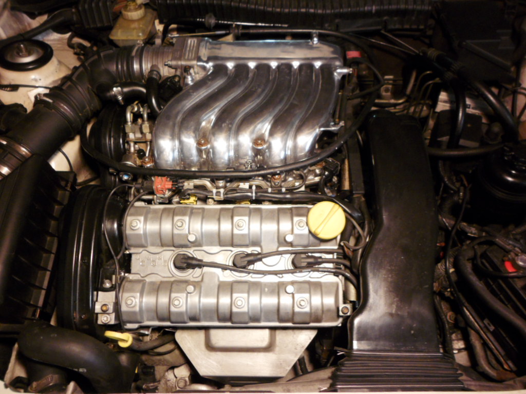

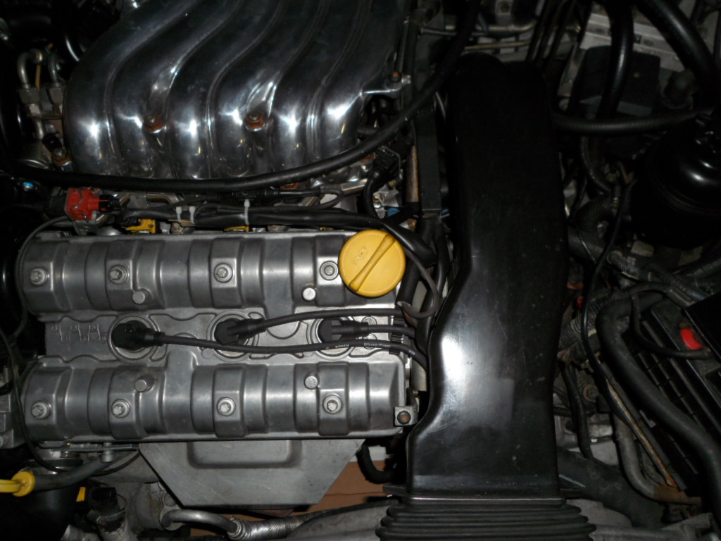

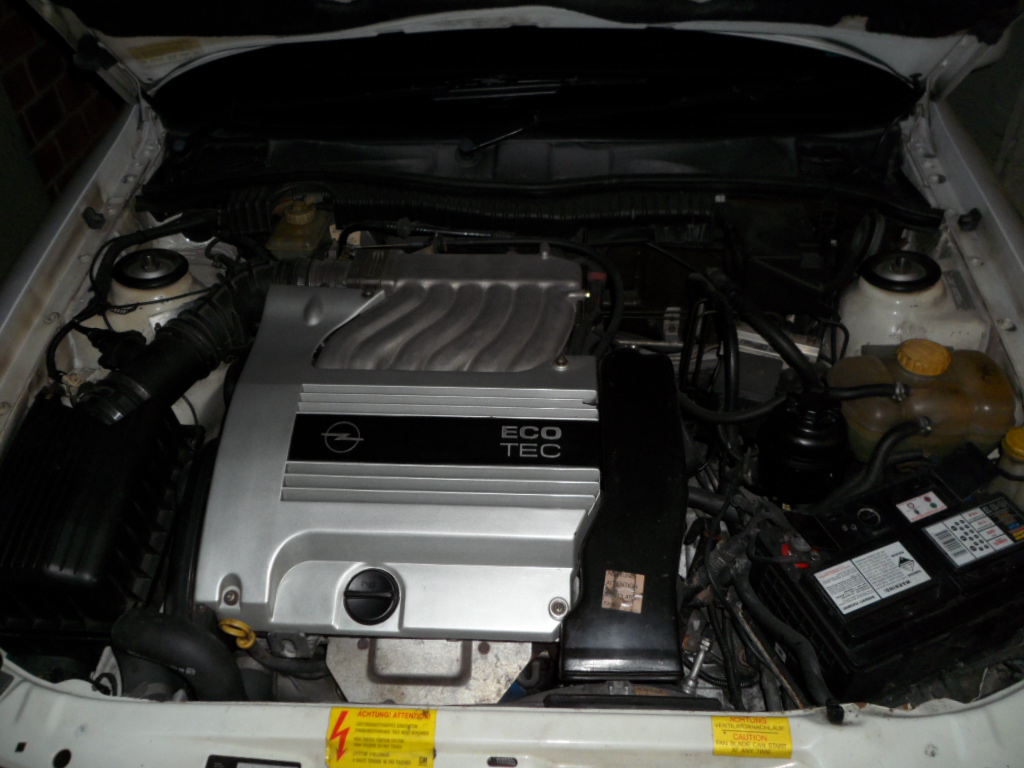

SOME MINOR DETAILING...
I fitted the more discrete Black Oil Cap, and will keep the bright Yellow Oil Cap as Spare...
