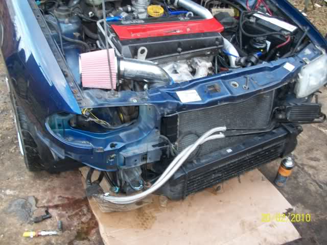

ITS IN woohoo, i got a bit nervous about bonnet clearance, but once the subframe was on the engine sat at the correct angle and with the bonnet closed theres about 1/4inch of cleanace so very close!
the engine mounts in just like the c20xe so no mods required here!
i read that people said if you use the saab subframe then the lower arms need swapping but i measured and the saab matched the astras exactly the same so i used the saab subframe as its all ally rather than steel like the astras so a little bit of weight saved!
i mocked up the turbo down pipe which in the week i cut off the cat and welded a stright piece of 2.5" to, its a good fit perfect position just need to angle the rear part and conect to the astra system, i will get some photos once its on the ramp at work!
picture to show the room at the front, still got to decide on a cooling fan and temp switch to use!
its tight between the inner chasis leg too, but nothing touches any where so all is good!

my intake pipe, needs makeing shorter as you'll see later when i trail fitted it

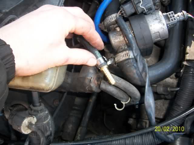

need to figure out how i'm going to make the temp gauge work as the saab has a two wire cooling sensor!

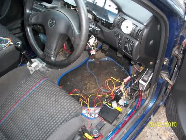

i then cracked out the wiring diagrams, its handy being in the trade and having mates who use to work at saab and vauxhall so had the correct and offical wiring diagrams!
tried to make sence of the loom
what it looked like before i started
what it looked like after, i wired up the two requried relays only to find they where the wrong type so had to start over again D'oh!
but once i had wired all that up i turned the key!
i crapped my pants lol without out warning BANG out the exhuast and it started first time woohoo!
