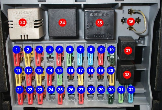

by EddeyDancer » Mon Dec 02, 2013 4:22 pm
I'm thinking that it's the Wiper Relay...
It's weird for them both to have failed, at the same time...
It's in the Fuse Box under the steering wheel...
33 warning buzzer headlights left on
34 turn signal
35 wiper intermittent
36 rear fog lights (Yes it may be just a wire loop)
37 front fog lights
38 horn or heated screen

by vauxhallben » Mon Dec 02, 2013 4:56 pm
So I've had a look and it's the fuses, it's blown up 3 now, been told I need a new wiper motor, anybody know if anyone breaking 1?
