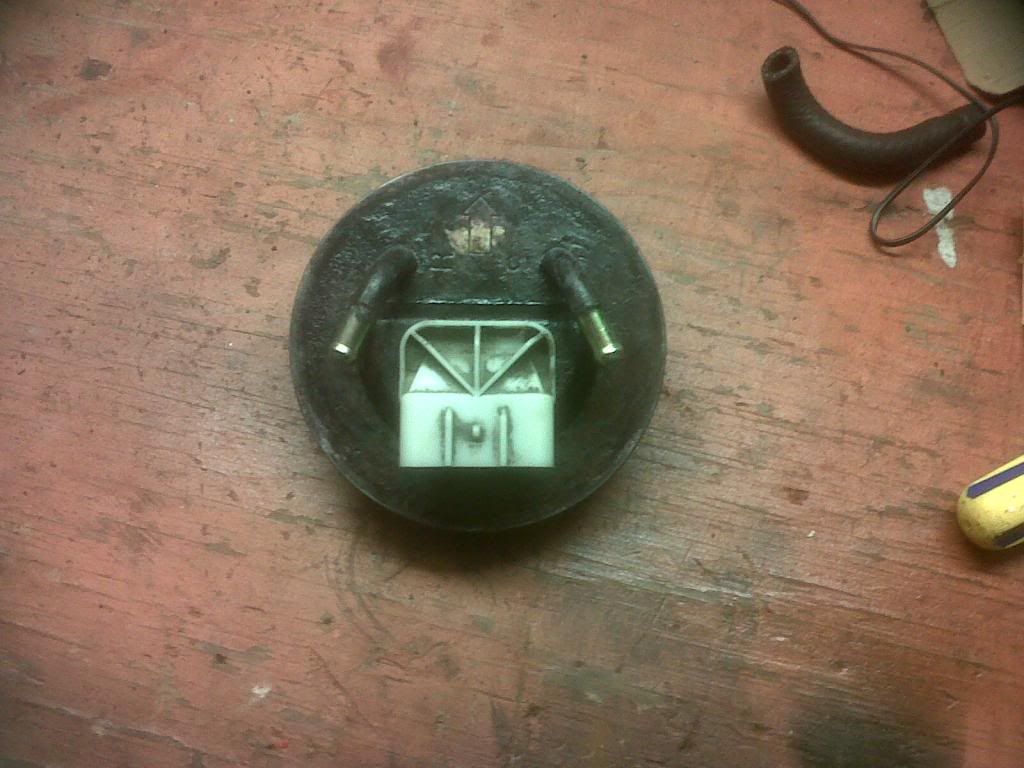

i managed to find one of these on ebay the other week which was actually in not that bad of condition. as we all know the two pipes on top normally rust and either have holes or break off.
so for only £15 i took a chance and bought this one which looked like it only had a couple of bits of rust on the surface. and thankfully both pipes were actually in pretty good condition

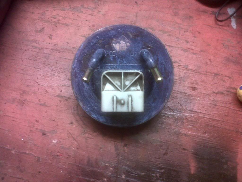

after a rub down i put some Kurust on it to treat it
after one more coat

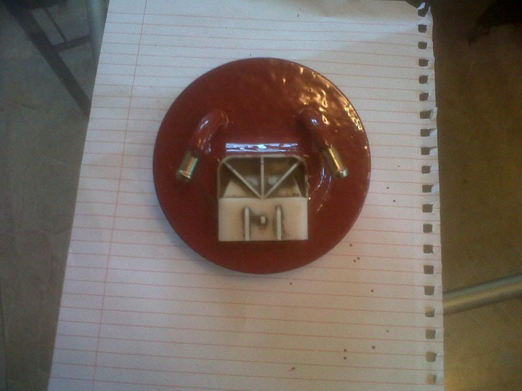

next thing up was a couple of coats of hammerite paint for a bit of added protection for when its fitted
