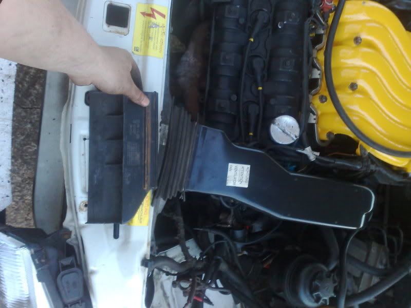

Next i assembled the air tract...

On with the ducting...
