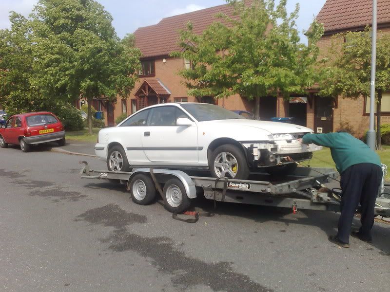

Well as you all know, i've moved house now and witht he calibra still engineless it had to be towed.
Two engines also had to be move and to be frank the whole day nearly killed me
Here she is up on the trailer
Finally its moved and on my new drive...

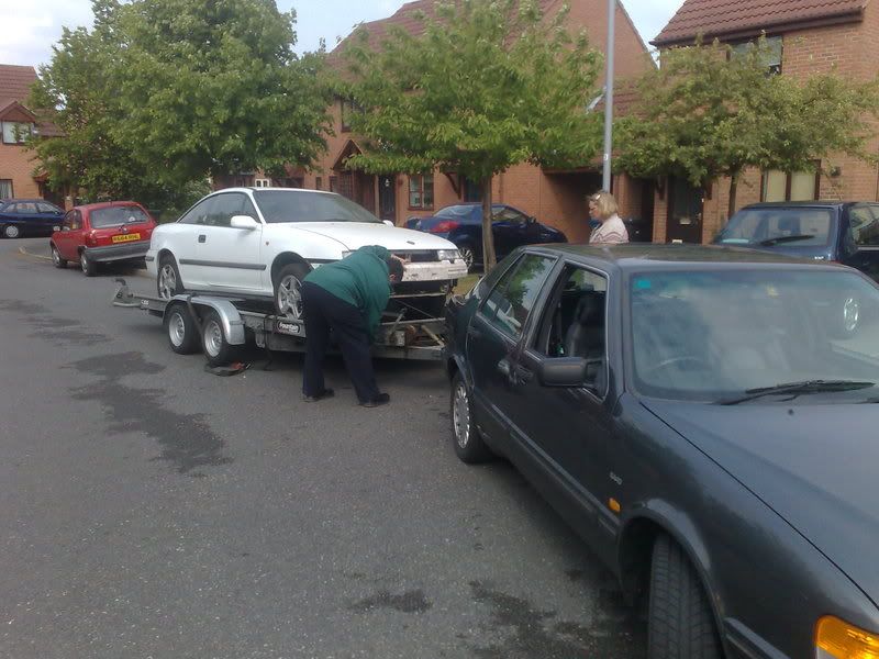

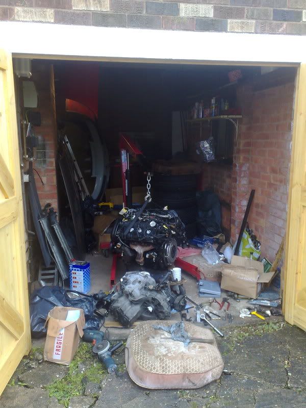

Right well its 10 o clock and me and my dad have been finished for 2 hours, after starting at 8am
Both knackered!
I apologise now for the quality of some of the photos as we were in a rush especially with the weather...

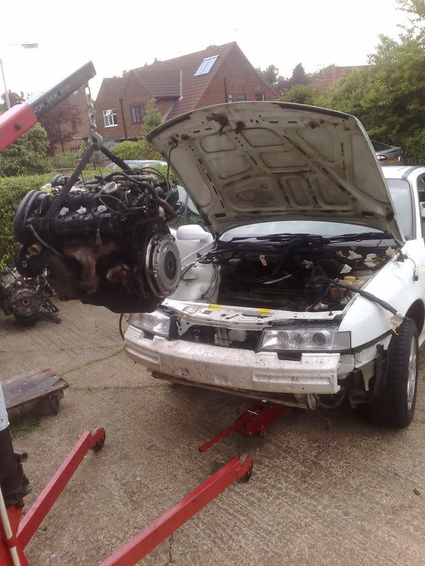

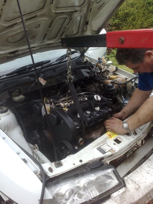

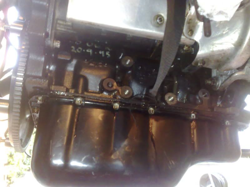

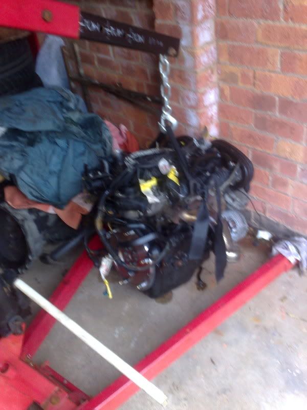

With the help of Trigs engine crane (cheers again matey) the engine was lifted ready for cleaning...
A quick ******* later and its fairly clean, you can even read the casting date on the 2nd photo...

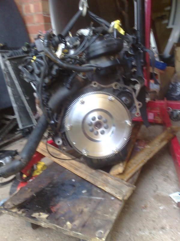

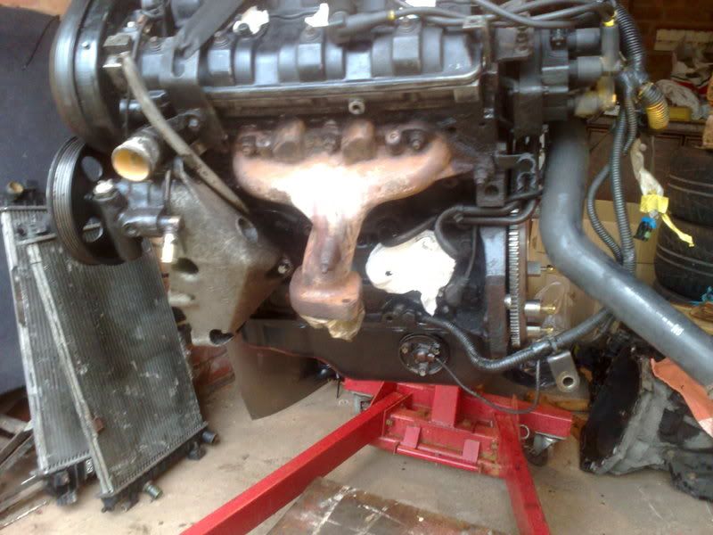

The flywheel bolts were tightened up to thier proper torques..

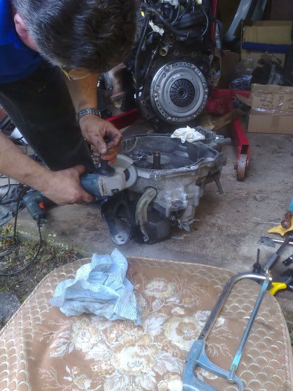

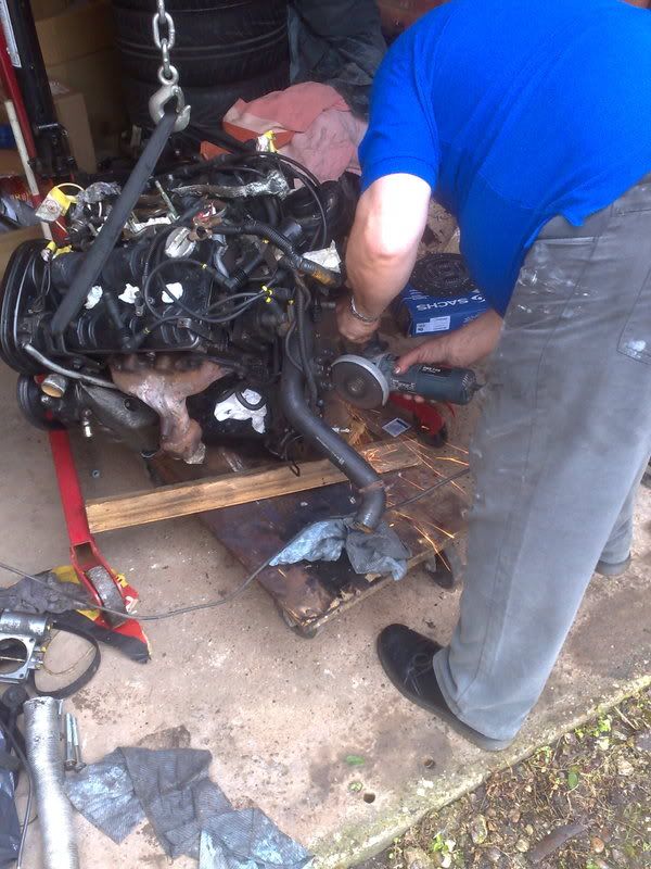

With the F28 conversion (6 speed) the turbo clutch is required so the V6 flywheel bolts need precision machining to avoid interfering with the friction plate...
(WARNING: Gratuitous grinder action

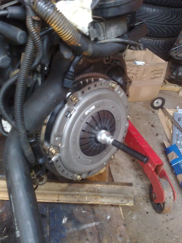

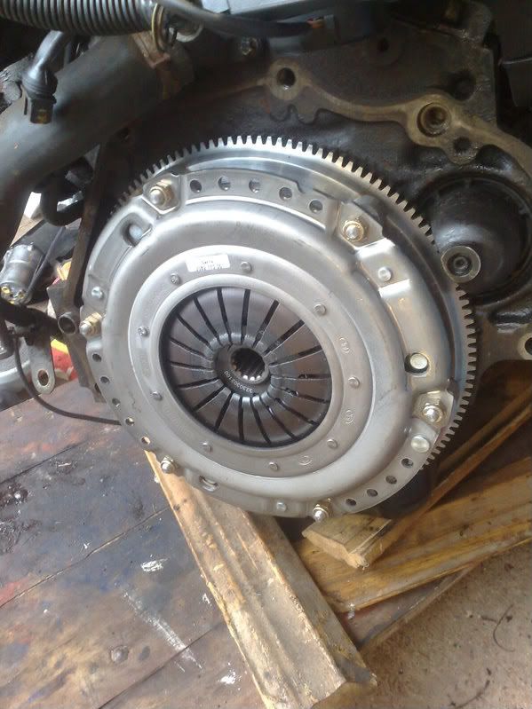

The clutch was properly lined up...
Tada! Clutch all on...

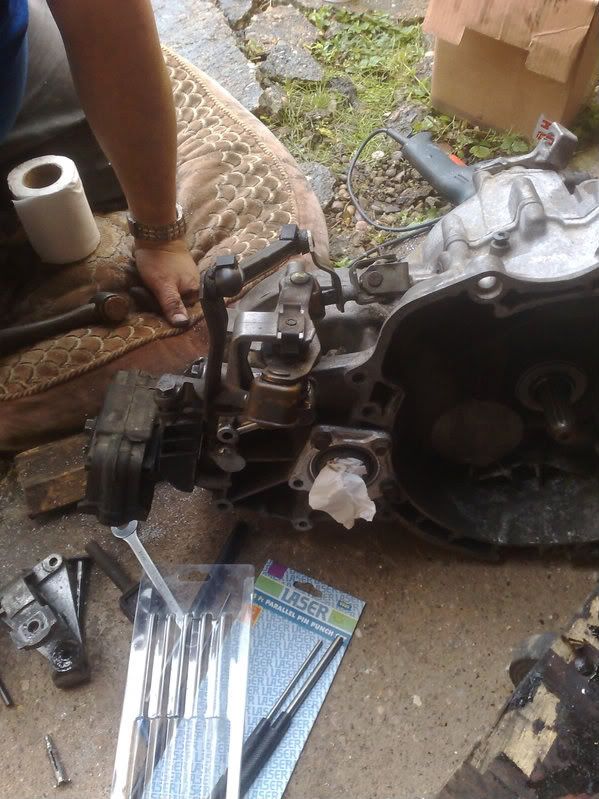

With the engine ready for installation it was time to look at the gearbox...
The F28 conversion requires a bastardisation of the F25 and F28 linkages so that was made and fitted..

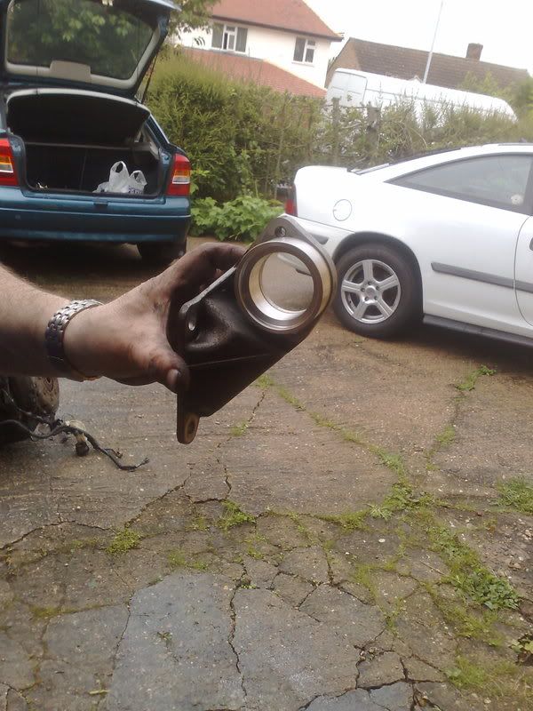

Also theres a lug on the F28 box which catches on the oil cooler pipes so that was also precision machined off...
The offside drive shaft spacer was fitted to the bracket... (4 pot gearbox to 3 pot wide engine needs spacing

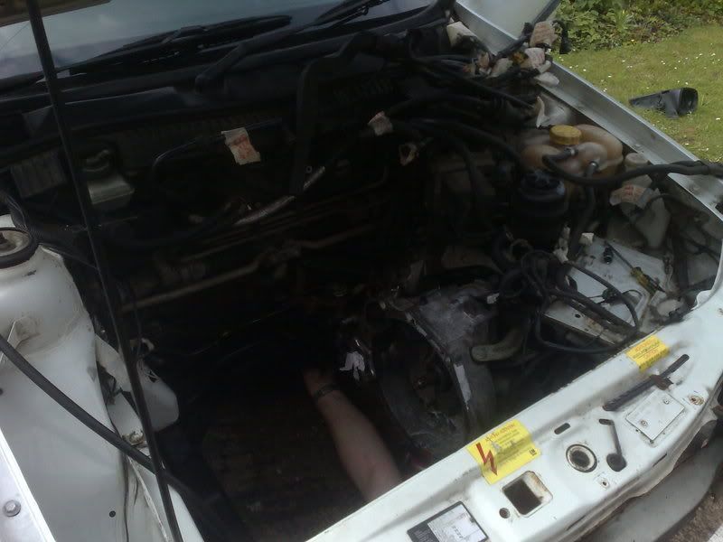

The gearbox went in and all mounts done up...
Its crunch time...
An hour later...

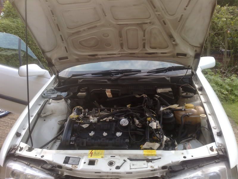

And finally!
Loads still to do but at least the engines back in now
Its crunch time...
An hour later...
And finally!
