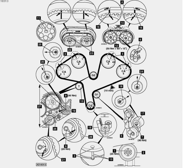

this is the correct bottom mark though its not very clear there is a notch in the crankshaft pulley that aligns with a notch in the bottom of the timing back plate ...if you look there is two red marks shown ..they both should be in line
cant really see for the pictures you posted but the front bank marks are
cant find a picture of the back bank but, if you look at the picture that was posted the marks are shown

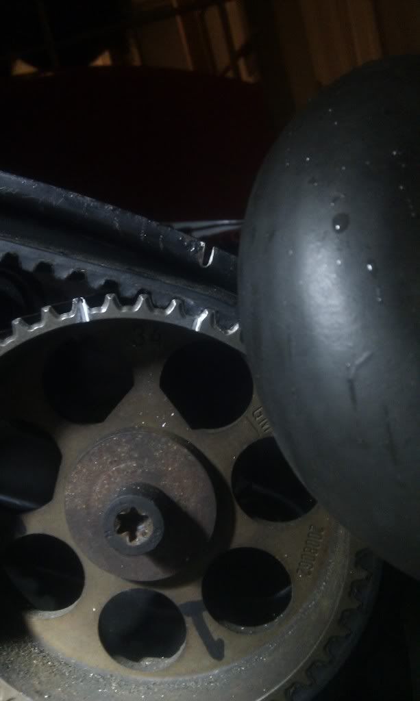

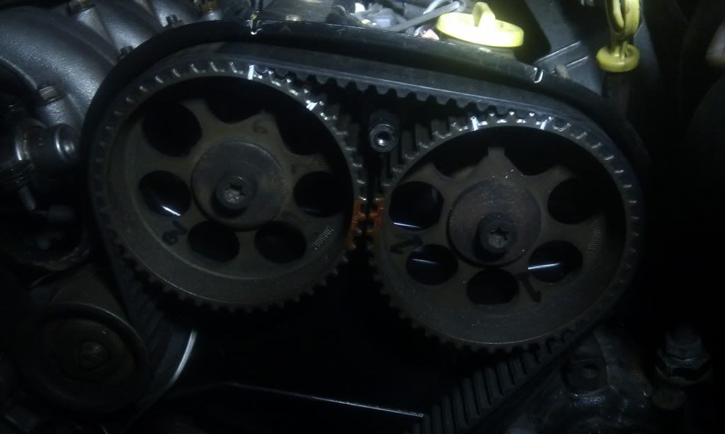

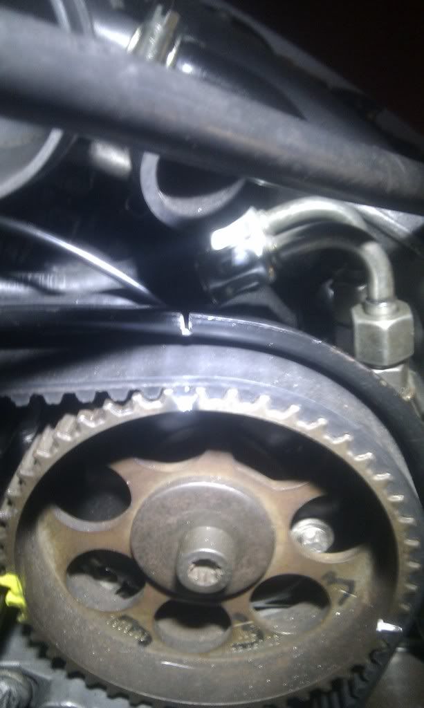

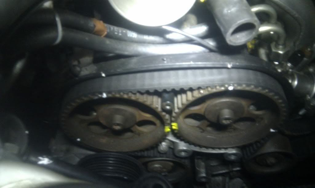

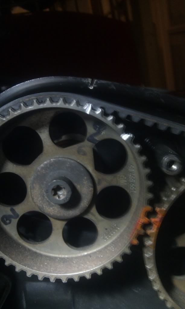

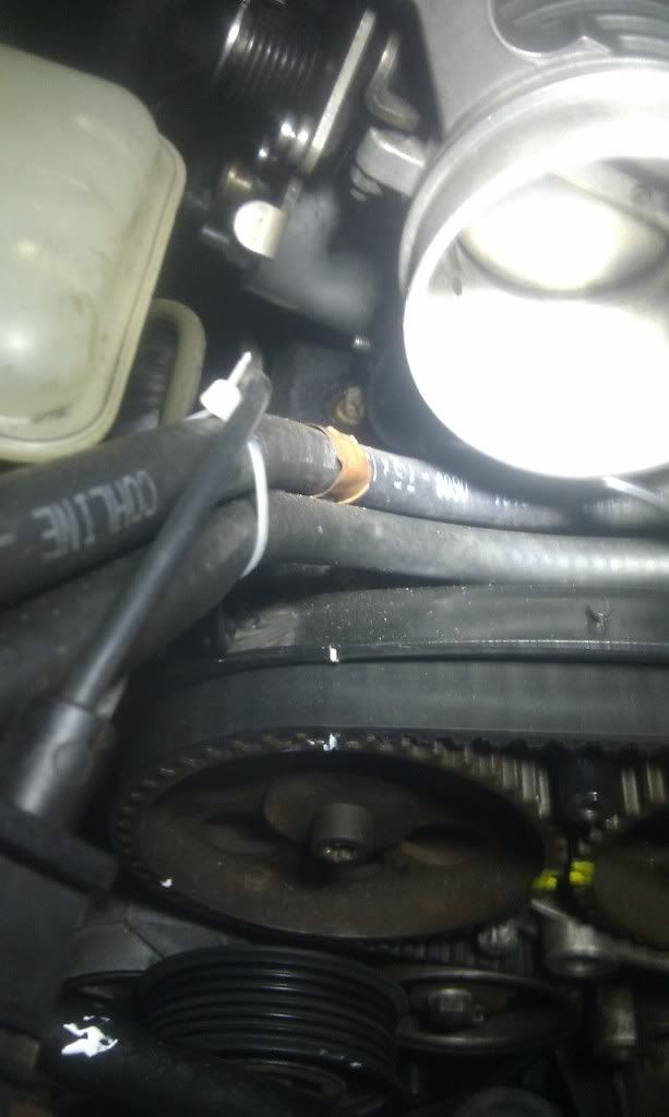

right heres some more clearer pictures of the timing taken tonight in the dark with a tourch
crank pully
front bank exhaust
front bank inlet
rear bank inlet
rear bank exhaust
front bank
rear bank
crank pully
front bank exhaust
front bank inlet
rear bank inlet
rear bank exhaust
front bank
rear bank

there wroung
Re: think its time to call it a day
im sure that both front and rear bakes shouldnt mirror each other they should be the same

steve all the pullys are numbered we followed the numbers
acording to this it looks right to me
it might take my last post back
The two sets of white marks on the rear pulleys look too far apart, so I reckon the back bank is wrong / set on wrong marks perhaps.
Front looks right though.
