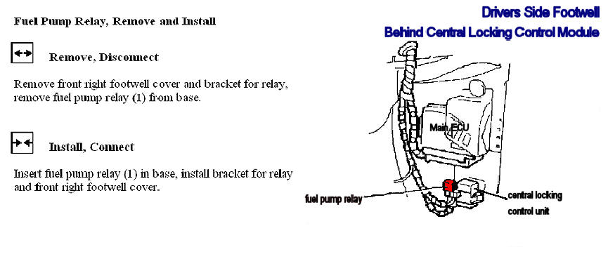

The Calibra Fuel Pump Relay degrades over time, due largely to the frequency of use and inadequate spec of the OE part. This causes the relay to heat up during operation. Total failure of the fuel relay results in a non-starting V6 - will turn over but never fires due to no fuel supply.
Symptoms of a degraded Fuel Pump Relay are inability to restart the engine from warm/hot (no fuel supply to rail) but when the relay cools down starting is no longer a problem.
(K68 in wiring diagrams)
Part No : 90378651
common to all models (8v, 16v and 24v systems)
