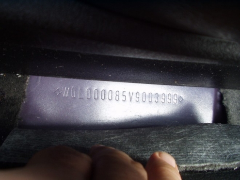

(note: there were no "U" chassis numbers because U can look like a V on a VIN stamp)You can read the chassis number of your V6 from the bar code label stuck on the passenger side dashboard, from the VIN plate at the front of the engine bay or from the one stamped into the chassis under the flap of carpet between drivers seat and door frame.
this shows a late "V" type chassis number
notice that the chassis code letter is towards the centre of the VIN code.
